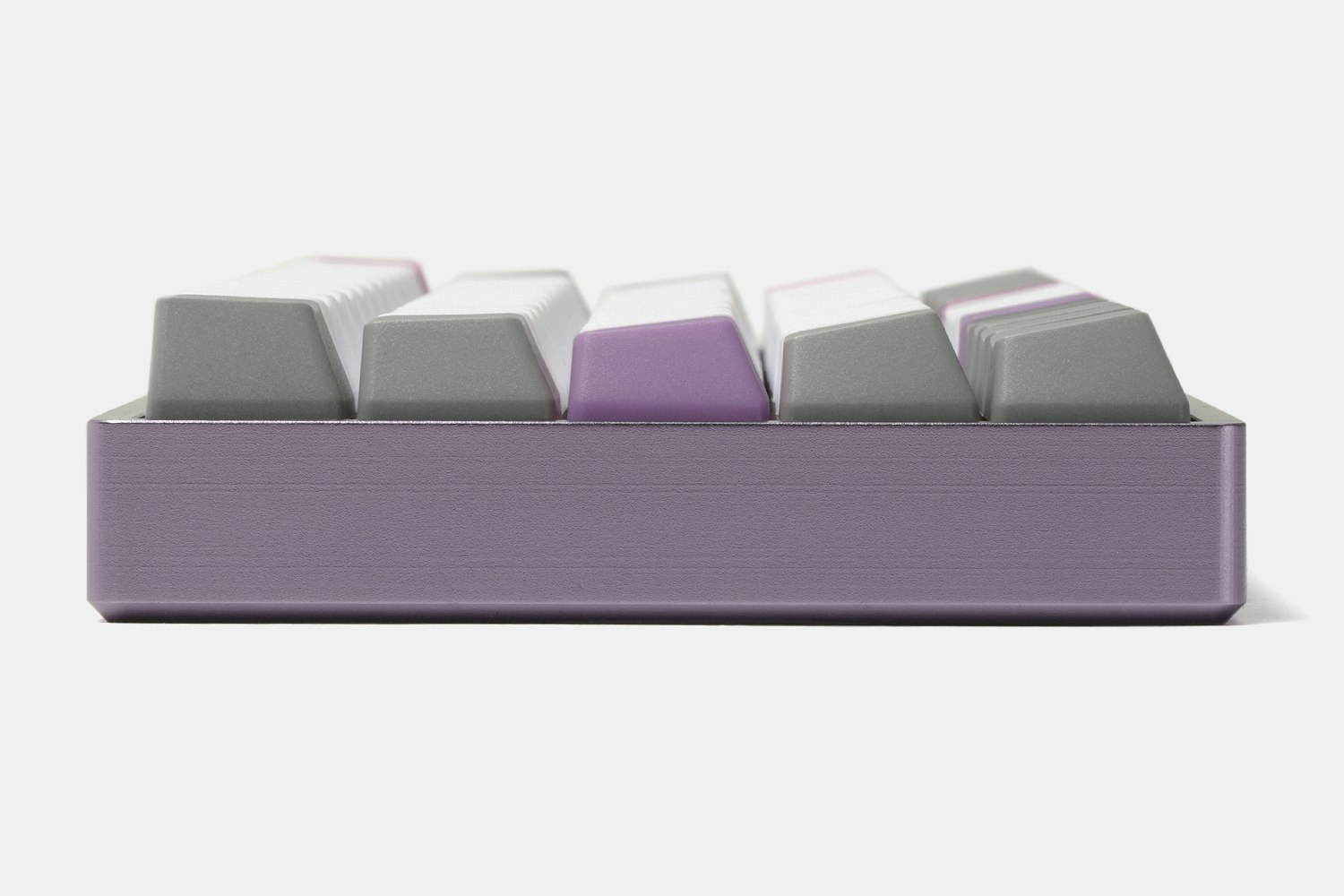

This is an interest check for a brand new low profile MX mount mechanical keyboard switch and a 60% layout custom keyboard kit that supports the new switches.

What:
1. TTC low profile switches. This is a brand new low profile switch manufactured by TTC. I've been assisted TTC for refining this switch for almost 1 year. It was tailored to my taste but I belive you will love it as well.
Features: low profile, MX stem, smooth, 3.5mm travel
2. 60% TTC low profile switch PCB. I have designed the first PCB for these TTC switches.
Features: QMK/VIA, Costar stab support, USB-C, regular GH60 case support, RGB backlight
3. Pitta 60 keyboard case. I have designed the lowest possible aluminum case for the PCB.
Features: E-coating/anodizing aluminum, PCB tray mount
The goal
1. I want to make the new TTC low profile switches available to the community at affordable price.
2. The Pitta 60 kit includes everything you need to build your first low profile custom mech. It's probably the best premium low profile switch keyboard to date.

If I understand correctly, your point is 1) low profile switch keyboards are not that low compared to regular MX switches 2) it's not as low as choc switches and 3) you're concerned about the quality of the switches
For 1 and 2, it's exactly what I want, something between regular MX and Choc.
I've seen many custom keyboard designers that try to push the limit of the height of keyboards with regular MX switches. It's really difficult when the front of the case is lower than 19mm. And when the keyboard is as low as that, every millimeter counts. Unarguably, the TTC low profile switches can make the keyboard even lower based on that.
I also own several keyboards with Choc switches. It's subjective but I don't like how they feel. I'm happy to see if more spherical or cylindrical Cho keycaps become available in the future. It's always good to have more options. I've put a lot of effort on providing an option that I like.
For 3, I've tested the switches in person and I was blown away on how good they are. Again, it's subjective. I will post a typing test later when I'm available. I can also ask TTC to send switches to some reputable reviewers if needed.
Edit:
A fair height comparison between regular MX and TTC low profile
« Last Edit: Tue, 16 June 2020, 15:04:54 by Pitta »
