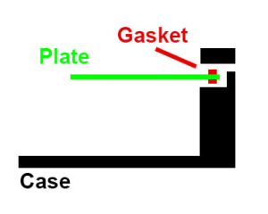

Gasket mount is a bit of rubber (or similar) between the plate or pcb and the case. The original purpose was to isolate vibration/noise traveling from the plate and/or pcb to the case.  Does it work? As with most things in keyboards, yes, but as always it's not a fix for everything. I’m not sure where the idea came from but along the way some people got the idea it dampens impacts as well. While some forms of it can do this it's usually only on small keyboards such as 65% or less and then it's done more as a hack, not so much a part of the design and on larger keyboards it's a side effect.
251897-0
On top mount (Plate bolted to the top cover) or bottom mount (plate bolted to the case bottom) both depicted here, the damper can be below, above, around the edge or any combination of the 3.  On any keyboard like this it's really more of a side effect and minimal at best for reasons we'll get into.

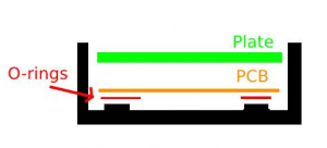

On plate-less or floating plate designs it's found under the pcb. Most of these are just people adding o-rings or foam under the pcb. It does work as we'll discuss later but it has limited applications and it can create some issues. Like I said, it's a hack.

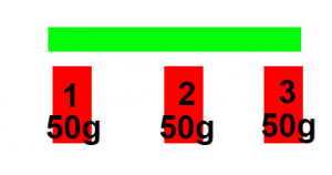

Let's start with the most common thing people have with it, the suspension itself. Imagine 3 springs in a row,  1, 2, 3 with a beam across them, like this.
251901-2
Ok, so this isn't a perfect example of what happens but it should get the point across because it's important and something I've seen a few times now.
If you press above spring 1 almost all your load is on spring 1 (50grams), same for spring 3 (50 grams), if you press on top of it almost all your load is on spring 3, in both instances spring 2 becomes almost inconsequential. Depending on the design it may pivot on it like a see-saw or it may slightly compress (60-70grams), but it will not fully compress as far as spring 1 or spring 3. So what happens if you press above spring 2, it’s load gets spread across spring 1, 2 and 3, instead of 50-70grams your spring pressure can be as high as 150grams. There is no way to make the middle feel as soft as the ends even if you lower the spring pressure both sides they still to the pressure you will see. Again, greatly over-simplified, the point is anything in the middle is effected by everything around it. If you add more springs it doesn't change this, it's going to be that spring/damper plus those around it. What if you eliminate spring 2, you still spread a middle press across spring 1 and 3, besides, you have more than 2 keys. What this means is there’s almost no way to suspend a flat object (I.E. a plate) this way and make it consistent across the keyboard. It’s not impossible, but it is in the confines of a keyboard, and certainly not by just sticking foam, gel or some sort of gasket under the pcb or the plate.
Maybe you don’t really care about it feeling consistent, I can see that, certain parts can be beneficial to be lighter and softer. That’s part of the idea behind Realforce, many people use a stiffer spacebar, even my current board is setup that way to an extent with a few slightly stiffer springs in strategic places. The problem is you aren’t able to control it well enough. You need to have it down to individual keys or at least various zones but while you can, it would take quite a lot of design work and testing.
There is still yet another issue and that is mass and the lack of dampening itself on such a large moving object. The stem in your switch is controlled by the spring and to a lesser degree lube, it may be loosely controlled but it’s very low weight so it doesn’t really matter. The pcb, switches and plate are not low weight, the higher the weight the more damping you need to control it. What happens if you don’t? You slam the W key, the assembly goes down then starts to come back up only to slam right into your finger slamming down on S key making the impact harder than it would be had you not had any movement in the first place. So how do they deal with dampening the plate movement? Easy, they either squish the gasket down tight so it doesn't or they simply don't bother. Remember it's meant to stop vibration and sound not soften the 300 pound gorilla pounding on the keys. I think this may be where the idea gets misunderstood. On Top and bottom mount the the plate isn't just softly floating on a cushion, it's clamped, preferably tight. Yes, you could run it loose, which is what they do with the o-rings on plate-less and floating plate designs but what did you just read about consistency?

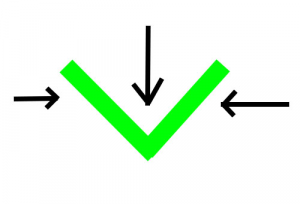

Instead of springs imagine a trapeze artist high above the floor, he slips and down into the net he goes. What happens to the net? It droops down, just as you want but what else happens? It draws in extra material from around it.
251903-3
The pcb doesn’t stretch, it's not elastic, it only bends (same for a flexible plate) and all that extra length has to come from everything around it and just like above it will happen at different rates. What ends up happening is you are pulling the switch bodies in half vertically and sideways. The plastic will likely be fine, but what else is it pulling, the solder joints and the switch contacts. You may get false triggers, damage the contacts or break the solder joints. A half plate is even worse, while it will flex more easily all that load is now concentrated on the few perimeter switches. Before multiple switches would help absorb the load but here it's all concentrated on fewer switches and it's more switches doing it to them.
