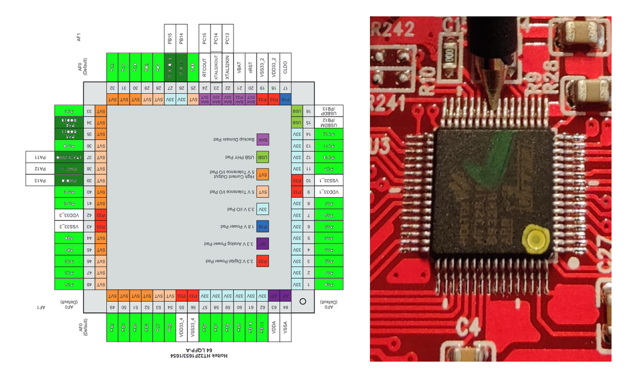

It is the same Holtek HT32F1653 as in the other threadz:
I desoldered G and the two other switch to identify the trace but I did a bad job and butchered the pads and broke an LED  :'(
It appers that the trace goes back on the other side.
I scratched it and it goes to this pin (PD0 in the picture):
Should I solder everything back together with some bridges or is there something else to check on the other side of the board ?

Same as the last guy, a handy via.  You don't really want to be trying to solder to the chip though one newbie did after a repair shop refuse to do it for him!
As the scratch goes to the controller all you need to do is solder a jumper from the switch to the scratch and one to the diode and G should work, you can test by touching a wire from the diode pin of R to the scratch which should type R.  You will probably need to solder a jumper from the pin attached to the trace on G and the non diode pin of F to reconnect the other switches in the column.  Or if that only fixes F another to R and/or V...
That just leaves the question of where did the crazy designer decide to put < this time.  Your blue line following the trace to a via looks to be heading for the main group of traces heading to the controller, but it can't continue at 45 degrees as there's another via right there and directly above is what looks to be the via that links A to the controller.  Though you didn't mark A as green or lavender(?) so maybe that is in a sane column with < and Q?  Diode pin of < to non diode of A would type < if it was, but I'm sure you've tried this.
