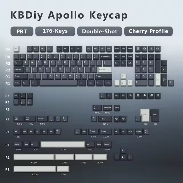

I’m looking for Cherry profile keycaps that may include keys for a split spacebar. I’m mainly aiming for a dark-themed keyboard, but I might also be open to a gray set with orange or blue accents.
Here are a few sets I found:

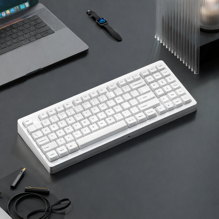

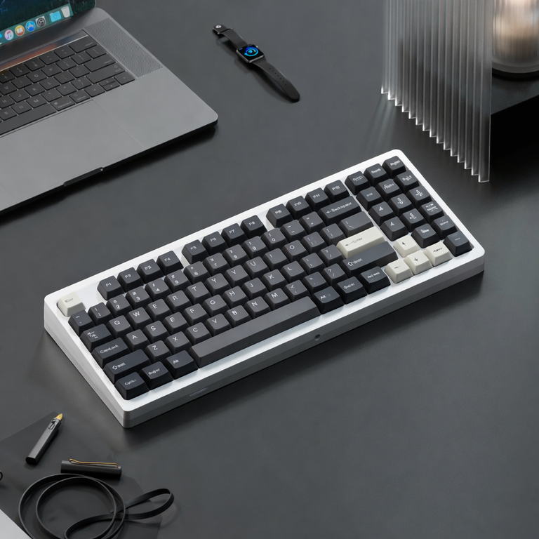

« Reply #11 on: Sun, 21 December 2025, 20:09:48 »
Mockup done with AI to decide for the base color and keycap
I continue my research to decide what my custom keyboard will look like and this is what I'm on right now:
Base: Weikav Lucky65 V2
 https://weikav.com/product/weikav-lucky65-v2/ (with the split pacebar option)
Switches: Outemu Cream Yellow Pro V2 https://www.amazon.ca/gp/product/B0DNWB84S3/ref=ox_sc_act_image_3?smid=A24R95VR7GPNGC
Keycaps: https://www.aliexpress.com/p/tesla-landing/index.html?scenario=c_ppc_item_bridge&productId=1005007378465113&_immersiveMode=true&withMainCard=true&src=google&aff_platform=true&isdl=yhttps://www.aliexpress.com/p/tesla-landing/index.html?scenario=c_ppc_item_bridge&productId=1005007378465113&_immersiveMode=true&withMainCard=true&src=google&aff_platform=true&isdl=y&src=google&albch=shopping&acnt=631-313-3945&isdl=y&slnk=&plac=&mtctp=&albbt=Google_7_shopping&aff_platform=google&aff_short_key=UneMJZVf&&albagn=888888&&ds_e_adid=&ds_e_matchtype=&ds_e_device=c&ds_e_network=x&ds_e_product_group_id=&ds_e_product_id=en1005007378465113&ds_e_product_merchant_id=504944729&ds_e_product_country=CA&ds_e_product_language=en&ds_e_product_channel=online&ds_e_product_store_id=&ds_url_v=2&albcp=19215273764&albag=&isSmbAutoCall=false&needSmbHouyi=false&gad_campaignid=17178707511
With what I looked so far on youtube, reviews, etc. I'm confident toward the base and the switches, for the keycap, I would have prefer to have more options that the ones I have found, but I do not want to spend too much on keycaps (for now). I need a kit with the extra spacebar keys. I doubt a bit about the quality of them, but I did not find any others keycap I liked under +/- 50CAD$.
I will probably hit the buy button soon, but I will keep an eye here to see any recommendation toward this build!
Which AI (and which subscription, if relevant) and how close is it to what you actually want? Was the output a Blender file such that you could edit it for your own purposes or just the picture?
Excellent use of AI to reduce project risk.
Offline bdube30
Re: Building my first custom keyboard – looking for advice (65%)
« Reply #13 on: Mon, 22 December 2025, 07:40:13 »
I just use ChatGpt with the free tier, I paste the image of the Weikav Lucky65 V2 and the image of the Keycaps set :
For me it help me decide to use this set of Keycaps over a white set :
But we can see the color of the Keyboard frame was changed by chatGpt in the process, so it's more for having a general idea.
