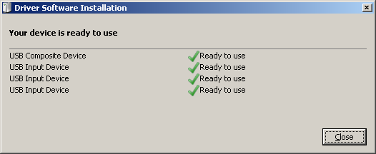

Why so many input devices?
« Last Edit: Wed, 03 April 2019, 23:48:40 by JosefM »
They are used for NKRO, mouse emulation and media keys.
Yes, it came to my mind later: I found it back and was right gonna modify my post adding this video (go to 2'48")
