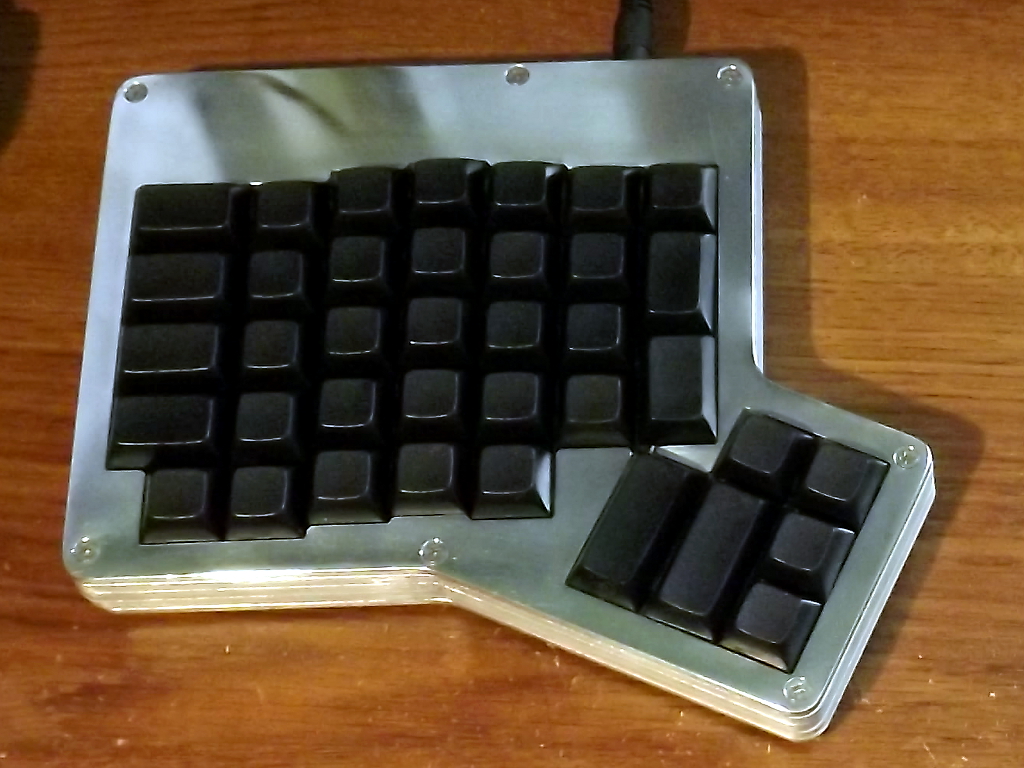

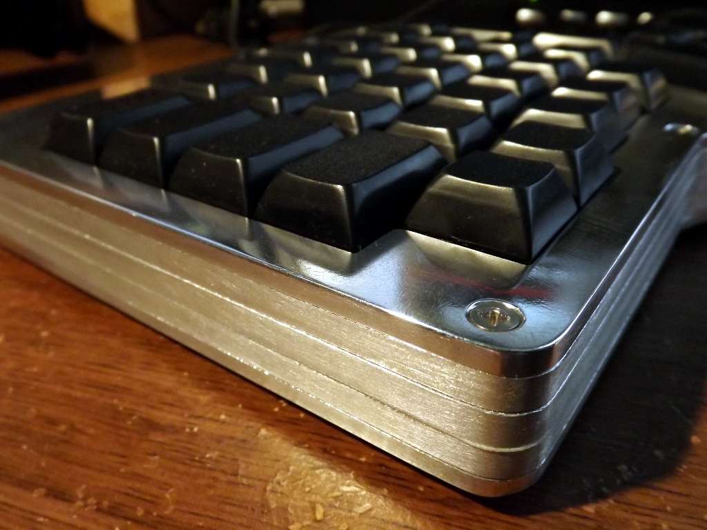

Done...finally.  Massdrop is making the right move by dropping the aluminum case.  It is a royal PITA.  The finish is rough, to say the least, and the fitment is awful.  There is a lot of error in the cuts, so the PCB wouldn't even fit into the case.  A lot of grinding, milling, drilling, filing, and polishing, I finally got it to work.  Not perfect, but tolerable at least.
It's loaded up with lubed browns and the "qwerty-kinesis-mod" layout to start.  Between the matrix layout and blank keys, typing is a huge challenge.
Russ
Bravo dude for going through all that trouble to make the layers look decent. you did a hell of a job! the way the screws are not protruding out and the way you polished it makes it look less like a "prototype" and just all around appealing
give matrix layout a few days and you will get used to it, and don't forget the massdrop layout configure tool.

Haha, I hit my high end WPM (~ 100 using dvorak) right away, despite using blanks for the first time. But that's because of years on the Kinesis Advantage!

Looking good rknize! Takes some true dedication to go full aluminum.  :D The polished look looks good too. I'm hoping that I'll be able to anodize mine eventually.

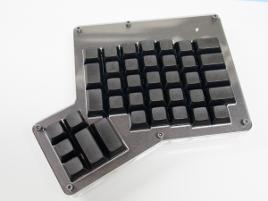

Well, my "prototype" (non-aluminum tester) board is finally done:
18648-0
Technically it was done earlier, but thanks to my decision to go back and clean up some flux, things got just a hair complicated. I wasn't really thinking when I did it, and the cleaner managed to make it's way through to the other side of the PCB and under the acrylic plate causing streaking that's impossible to remove without removing every switch. It also managed to make it's way into the switches themselves causing them to no longer click (blues), and to stick. A few hours of alcohol and PTFE dry lube later, the switches are back to 90% of their original state. Good enough until I replace them with something else (Turns out I don't really care for blues all that much. Curse the general shortage of browns!)
As for the streaking? I made lemonade with those lemons. Taking it as the perfect opportunity to test out the plans my sister has for hers when it's made, I went and got some paper that pretty much perfectly matches the keycaps. After a bit of precise cutting, I end up with a result that's really quite nice.
18650-1
A note to anybody planning on doing something similar: leave nothing hanging on the inside. Not even half a hair's width. The tolerances of Litster's case design are too tight for any margin of error.
Beyond that, I went and added some feet to it to give it a bit of an inverse tilt. but that's all subject to change while I figure out what's best.
Now for things I'm not exactly crazy about:
  • Some of the PBT keycaps are ridiculously tight. They're so tight they have ripped multiple switches in half while attempting to pull them off the stem. I've added lube on them this time around, but only time will tell if that helped.
  • Litster's case design doesn't have quite enough play around the edges. I can't even get my key puller in where keys meet the case. This wouldn't be too bad if the above issue didn't exist, but still isn't ideal either way.
  • The DSA keycaps don't have any homerow centering keys. I'm used to the Kinesis, so this layout isn't exactly hard for me, but I manage to misplace my hands enough without those wonderful homerow keys of the Kinesis.
More random photos here.

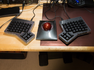

    That looks great man. I wouldn't have had the patience or skills to do what you've done with it. An idea to get help with the acclimatization - forget the dsa blank caps for now. When I got mine done at first, I threw on the blanks for an hour before I realized how hard it was to remember a non-standard layout, and I had been typing on blanks on my filco for the last 2 years. Throw on a set of labelled caps for at least the alphanumeric keys and swap them around until you figure out the layout you want (fyi, I'm on my 30th version of my layout before I figured out how I wanted it).  This way, you can look at the keys when you need to until muscle memory kicks in, which is a few days at least.
    @Zalusithix - that looks great. I did the same with mine, though I left the top cover alone. It does take extremely precise cutting of the paper with a xacto. Kudos on the lemonade making.
    | Ergodox #1 | Ergodox #2 |

    It could have turned out good. I guess it really depends on which laser cutter they sourced. Some machines have really bad tolerances. Here is an example of a really terrible one:
    http://imgur.com/ysADbOY
    Haha...wow.  That one was definitely not setup right.  For the Ergodox, it seems like the cutter just didn't have enough oomph to cut cleanly through the thick plates.  The cuts are not square, maybe because the aluminum dissipated the heat too quickly.  I haven't heard any of the acrylic case owners complaining, so clearly the machine is accurate.
    That said, there is so reason for the inside case to be so tight against the PCB.  Litster's previous designs needed a snug fit on the sides since the PCB/plate assembly simply rest inside the case.  Ergodox mounts the switches right into the case.  Some play around the PCB is not only fine, but desirable.  That close up shot is on its best side and the camera made it look a bit better than it is.  :)  You can still see laser damage in some areas that I didn't machine down far enough and my polishing work was somewhat rushed.
    As far as typing on it, yeah I need to put legends on it.  I bought a DSA Retro for this thing for that reason.  I also have horrible typing technique.  I use most of my fingers, but my hands fly all over the place.  Part of the reason I bought this thing is to force me to learn to type properly.  The blank keys are helpful that way, but man it is tiring.
    Russ
