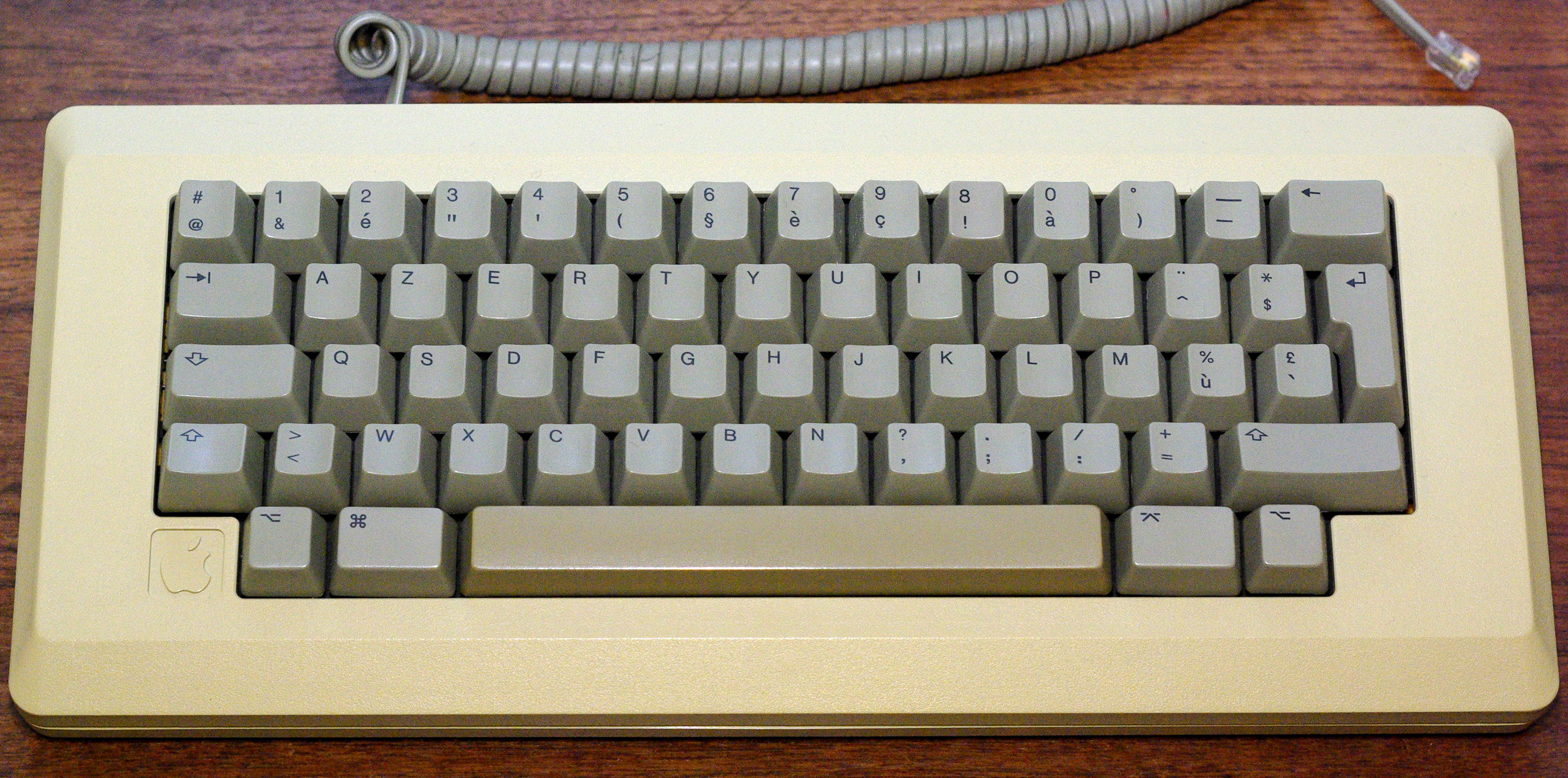

YOUR HELP NEEDED for International(ISO) keyboard support
Can anyone who own M0110 with tiny ISO return key like pic below help me?
I like to know its 'Model ID' to add international-layout M0110 support.
Please let me know 'Model ID' of your M0110 and 'Model Number' printed on back-side label.
To get 'Model ID':
0. Download the latest firmware from Keymap Editor and flash it on converter. (Just updated firmware for this purpose.)
1. Run hid_listen
2. Plug converter into computer
3. Plug keyboard into converter
You will see 'model ID' on hid_lisen console as below. My US-layout M0110 shows '09' as model ID in this example.
Code: [Select]
Waiting for new device:........
Listening:
TMK:ca021a/LUFA:d6a7df
USB configured.
Loop start.
model: 09
Thanks

Support for International layout
Keymap Editor support for International layout is available now.
See Issue #771 and the first post.
