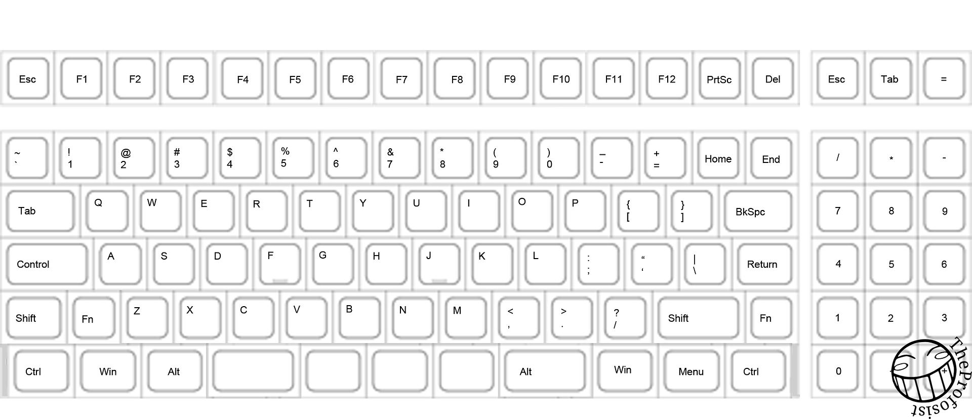

Offline TheProfosist
  • Posts: 3671
  • Location: Wisconsin, USA
  • Custom Layouts Only!
Re: Building Phantom Hardware and Firmware Mods
« Reply #118 on: Sat, 11 August 2012, 08:07:44 »
any way we could get the code compiled already the source is nice if you know what to do with it but when you dont it doesnt help much. wasnt their a working basic firmware file as one point
After I load into WinAVR I continually get Error: invalid command name ".tearoff1"
« Last Edit: Sat, 11 August 2012, 08:18:34 by TheProfosist »

Would anybody be able to at least modify the default firmware to work for a 7bit layout, preferably one that matches my default layer?

since your layout is unique to you, you maybe better off doing this yourself.  It is fairly simple.  Install the C compiler and teensy loader.  Then get the source code.
In phantom.c, there is this table:
Code: [Select]
const uint8_t is_modifier[NKEY] = {
  true,            true,            false,           false,           false,           false,  // COL  0
  true,            false,           false,           false,           false,           false,  // COL  1
  true,            false,           false,           false,           false,           false,  // COL  2
  NA,              false,           false,           false,           false,           false,  // COL  3
  NA,              false,           false,           false,           false,           false,  // COL  4
  NA,              false,           false,           false,           false,           false,  // COL  5
  NA,              false,           false,           false,           false,           false,  // COL  6
  false,           false,           false,           false,           false,           false,  // COL  7
  NA,              false,           false,           false,           false,           false,  // COL  8
  NA,              false,           false,           false,           false,           false,  // COL  9
  true,            false,           false,           false,           false,           false,  // COL 10
  true,            false,           false,           false,           false,           false,  // COL 11
  false,           NA,              false,           false,           NA,              false,  // COL 12
  true,            true,            false,           false,           false,           false,  // COL 13
  false,           NA,              NA,              false,           false,           false,  // COL 14
  false,           false,           NA,              false,           false,           false,  // COL 15
  false,           NA,              NA,              false,           false,           false,  // COL 16
const uint8_t layout[NKEY] = {
//ROW 0            ROW 1            ROW 2            ROW 3            ROW 4
  KEY_LEFT_CTRL,   KEY_LEFT_SHIFT,  KEY_CAPS_LOCK,   KEY_TAB,         KEY_1,              KEY_ESC,        // COL  0
  KEY_LEFT_GUI,    KEY_PIPE,        KEY_A,           KEY_Q,           KEY_2,              KEY_TILDE,      // COL  1
  KEY_LEFT_ALT,    KEY_Z,           KEY_S,           KEY_W,           KEY_3,              KEY_F1,         // COL  2
  NA,              KEY_X,           KEY_D,           KEY_E,           KEY_4,              KEY_F2,         // COL  3
  NA,              KEY_C,           KEY_F,           KEY_R,           KEY_5,              KEY_F3,         // COL  4
  NA,              KEY_V,           KEY_G,           KEY_T,           KEY_6,              KEY_F4,         // COL  5
  NA,              KEY_B,           KEY_H,           KEY_Y,           KEY_7,              KEY_F5,         // COL  6
  KEY_SPACE,       KEY_N,           KEY_J,           KEY_U,           KEY_8,              KEY_F6,         // COL  7
  NA,              KEY_M,           KEY_K,           KEY_I,           KEY_9,              KEY_F7,         // COL  8
  NA,              KEY_COMMA,       KEY_L,           KEY_O,           KEY_0,              KEY_F8,         // COL  9
  KEY_RIGHT_ALT,   KEY_PERIOD,      KEY_SEMICOLON,   KEY_P,           KEY_MINUS,          KEY_F9,         // COL 10
  KEY_RIGHT_GUI,   KEY_SLASH,       KEY_QUOTE,       KEY_LEFT_BRACE,  KEY_EQUAL,          KEY_F10,        // COL 11
  KEY_APPLICATION, NA,              KEY_BACKSLASH,   KEY_RIGHT_BRACE, NA,                 KEY_F11,        // COL 12
  KEY_RIGHT_CTRL,  KEY_RIGHT_SHIFT, KEY_ENTER,       KEY_BACKSLASH,   KEY_BACKSPACE,      KEY_F12,        // COL 13
  KEY_LEFT,        NA,              NA,              KEY_DELETE,      KEY_INSERT,         KEY_PRINTSCREEN,// COL 14
  KEY_DOWN,        KEY_UP,          NA,              KEY_END,         KEY_HOME,           KEY_SCROLL_LOCK,// COL 15
  KEY_RIGHT,       NA,              NA,              KEY_PAGE_DOWN,   KEY_PAGE_UP,        KEY_PAUSE,      // COL 16
Change it to what you want, and then build the .hex file.  Upload it to your teensy.  Rinse and repeat.

What the best way to find what row and column the switch is in as i believe some of the additional function row keys are actyally in the row of the spacebar, though i may be wrong
Also can anyone think of a simple way if throwing an if/then in when a switch is pressed to check if another switch is held down and if so to do a different function, should be a simple dirty way of getting a layer in there in a way...
Offline bpiphany
  • Posts: 1033
  • Location: Stockholm, Sweden
« Reply #143 on: Fri, 17 August 2012, 02:13:53 »
The row and column number of each switch is written on the PCB.
The value at position col*6+row in the array "pressed" is 1 if that key is pressed and 0 otherwise. Remember that rows and columns are zero-indexed.
ok so what would be needed the would probably be an if/then, another variable, and another array. Though I am mostly lost as to how to make it work and havnt even found the part you talked about yet. I know very little about programming though it seems enough to be dangerous.
my idea:
after checking if the key is pressed you would have to check is specifically one of the "Fn" keys is pressed if so grab from a the "Fn array" if not grab from the "standard array"

•re-program keymaps without loading new firmware like AIKON.
•multiple layers
•NKRO over USB while maintaining BIOS boot compatibility
•media keys
•programmable macros
ic07 has been building teensy firmware for ergo Dox.  Wonder if he could help, or someone takes his code and port it over for Phantom.
