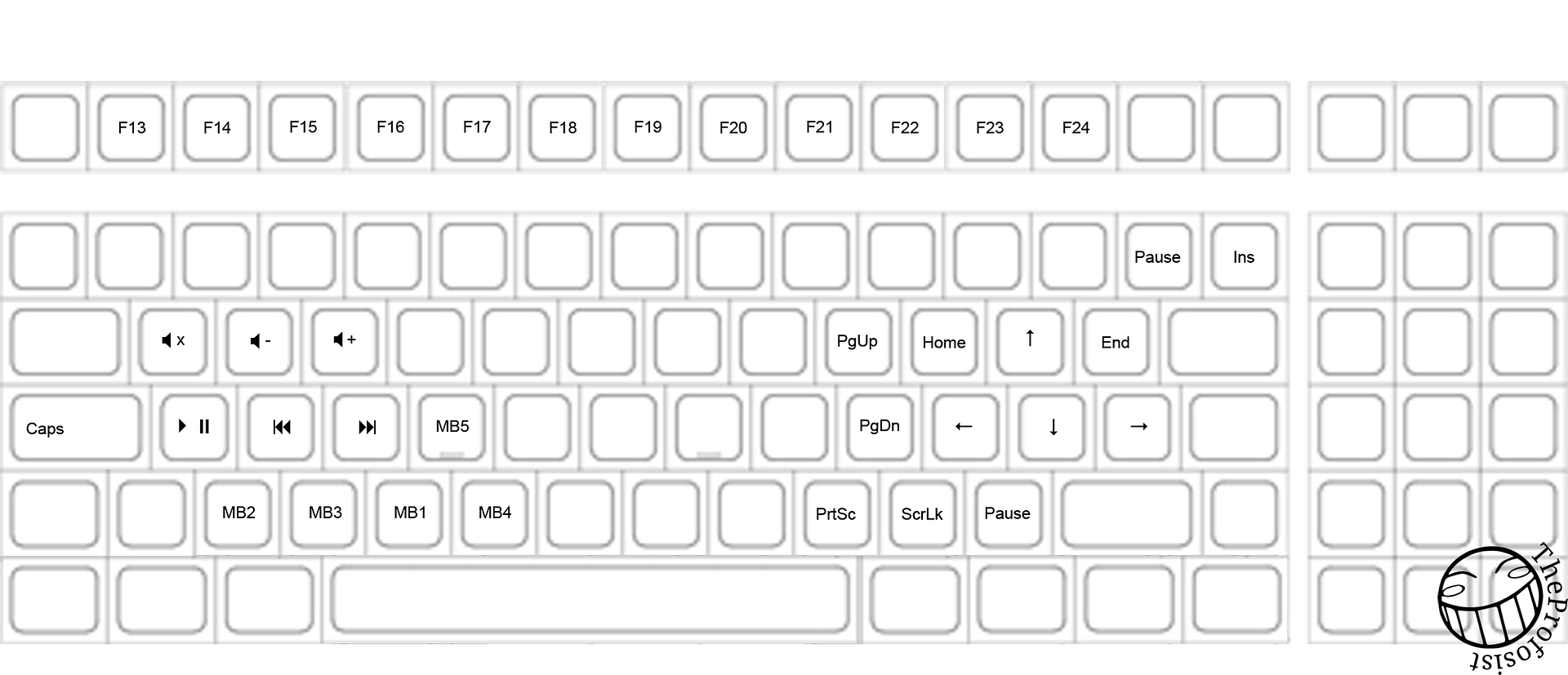

« Reply #163 on: Wed, 29 August 2012, 05:34:47 »
New Phantom layout finalized and template for WASD made by hazeluff
Also just sent out to get a quote for the matching plate

Offline litster
  • Posts: 2890
  • rare caps?! THAT'S A SMILIN
Re: Building Phantom Hardware and Firmware Mods
« Reply #187 on: Wed, 12 September 2012, 20:22:03 »
are you using 6.25x spacebar?
Offline TheProfosist
  • Posts: 3671
  • Location: Wisconsin, USA
  • Custom Layouts Only!
Re: Re: Building Phantom Hardware and Firmware Mods
« Reply #188 on: Wed, 12 September 2012, 22:03:03 »
  • Posts: 3671
« Reply #189 on: Wed, 12 September 2012, 23:57:34 »
Also I swapped the spring out with a clear spring and at least backwards the spacebar is working 100% and is even snappy.
