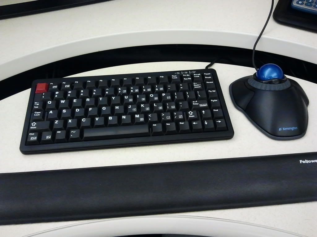

Quote from: o2dazone;518152
Vintage linears like ML's and MY's? I haven't tried those, I heard they felt awful. Is this not true?
I dunno, I love ML's. I have four Cherry G84-4100 units, and one of them is my daily coding keyboard at the office. I love it!
