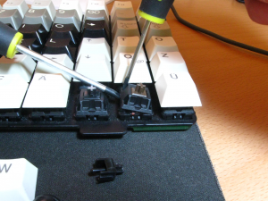

Anyways how do you actually do this?
Before you do this see warning @ number 6!

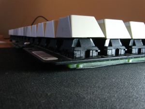

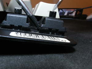

1. And most important step! Force metal plate down!
55407-3

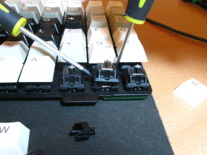

2. With a medium sized flat screw driver apply pressure to one side.
55409-4

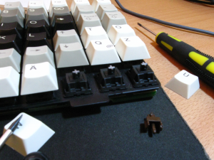

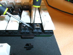

3. On that side get a small flathead pry the tab outwards. Apply force gently since this should happen easily if you forced the plate down far enough.
55411-555413-6
4. Repeat on all four tabs while applying pressure and... Pop! :)

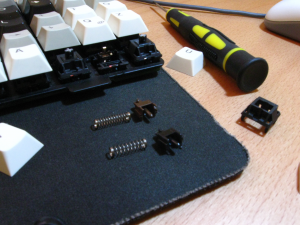

55415-7
5. Replace spring/stem and pop cover back on.
55417-855419-9

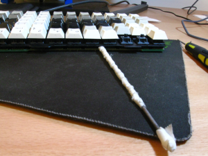

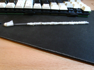

6. Most tricky part! Force plate back up! I am pretty sure its only possible with matrix boards :)
This is what I used :)
55421-1055423-11
I hope this helped :D

Now a few pics to give an idea of what it is like - sorry for the quality.
https://drive.google.com/file/d/0B43y9-vzM0T3M0c3SlhTX2xUalE/edit?usp=sharing
https://drive.google.com/file/d/0B43y9-vzM0T3RWRmeHUxWVZXX0E/edit?usp=sharing
https://drive.google.com/file/d/0B43y9-vzM0T3SEJzVk5vVllXY0E/edit?usp=sharing
https://drive.google.com/file/d/0B43y9-vzM0T3SXdBdTVGQmJySTQ/edit?usp=sharing
https://drive.google.com/file/d/0B43y9-vzM0T3SlZ4UW5Ed3BVTTA/edit?usp=sharing
https://drive.google.com/file/d/0B43y9-vzM0T3V2dfaXRNUFQ2b2s/edit?usp=sharing
https://drive.google.com/file/d/0B43y9-vzM0T3VU1zdEUzM1RVZnc/edit?usp=sharing
https://drive.google.com/file/d/0B43y9-vzM0T3VXhTcWtER0pMUUU/edit?usp=sharing
https://drive.google.com/file/d/0B43y9-vzM0T3YTdfelFkS3h0bmc/edit?usp=sharing
https://drive.google.com/file/d/0B43y9-vzM0T3YmJwYTlvMEc3cU0/edit?usp=sharing
https://drive.google.com/file/d/0B43y9-vzM0T3azg2aXBQM1dzMjg/edit?usp=sharing
https://drive.google.com/file/d/0B43y9-vzM0T3bjlZMjVuSThxaEk/edit?usp=sharing
https://drive.google.com/file/d/0B43y9-vzM0T3cHR0MXVaTzNzVU0/edit?usp=sharing
https://drive.google.com/file/d/0B43y9-vzM0T3eFcyWW1PekxoTlk/edit?usp=sharing
Hope it can help someone some day.

Awesome work! I can re upload the pictures for you guys no worries. I have been using this keyboard daily since I rebuilt it! I love it :)
Mx Reds and Compact Linear design FTW

The only thing to be careful about is how you force the metal plate up onto the switches.
Use soft tape it worked well for me.
I have been using the board since, with this method.  :))

To be honest I had an electrical wire with me but didn't even have to use : simply pushing it up progressively from one side to the other did the trick.
To force it down I used :
- a pencil in between the middle rows to avoid too much bend in the plate.
- faith in you and Ivan  ;D
Cheers  :thumb:
