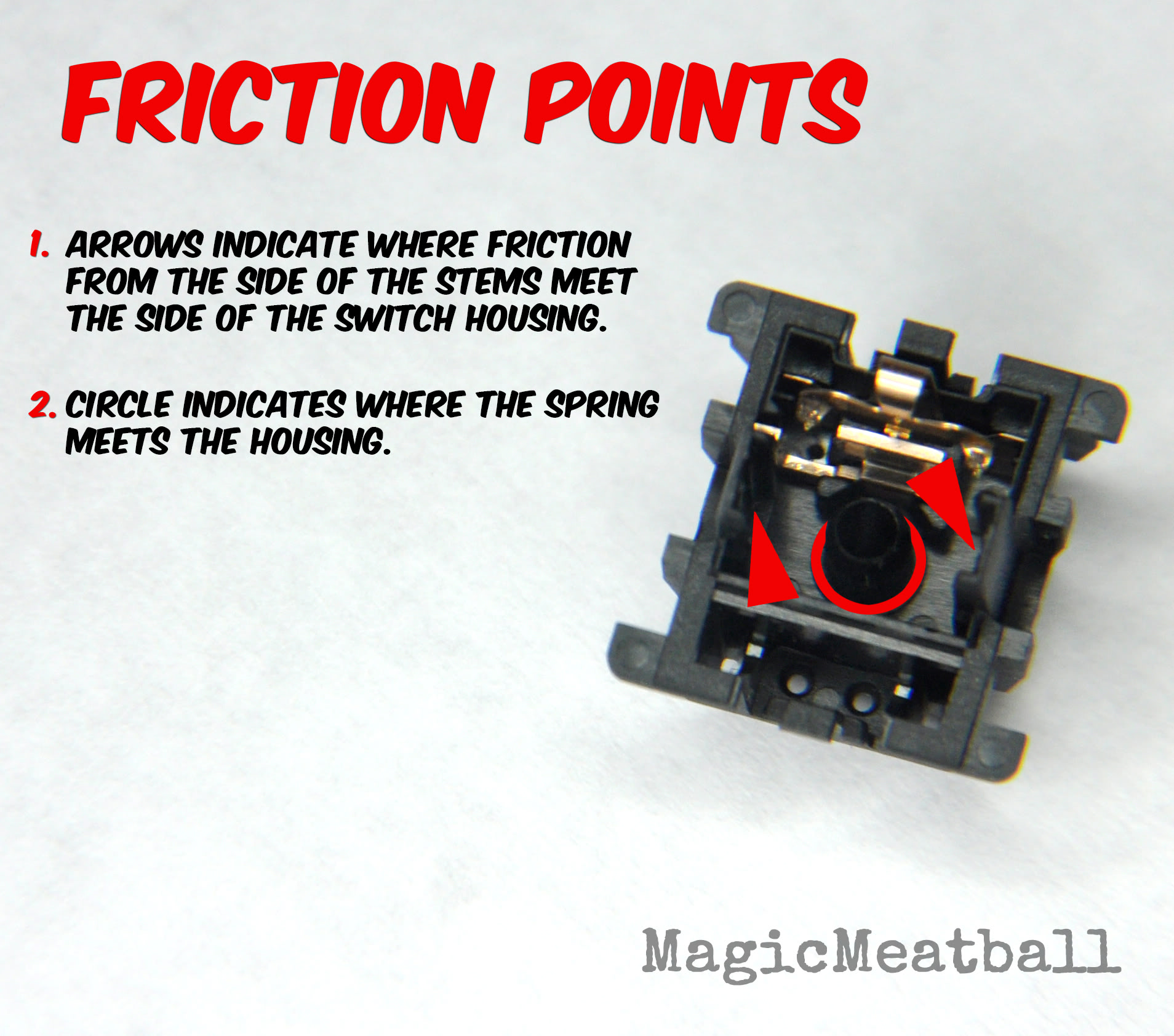

For starters, let's go over the primary locations for lubricating:
The illustrated points show where the spring makes contact with the bottom of the switch housing, and the stem contacts and slides against the housing.
156708-0
Original image (broken link):
Since I started doing this, I have only been using the teflon silicone lubricant. It seems to work pretty well all around for any one of the lube points. (I can see where grease may work well on the sliders, and will probably be tinkering with that in the coming weeks. I will post my findings and update this thread at that point).
You really want to be careful not to over lube those areas, but rather dab it on very lightly with a brush or Q-tip. Over-lubricating may interfere with the switches contacts if it happened to spill off into that area, so you definitely do not want to overdo it.

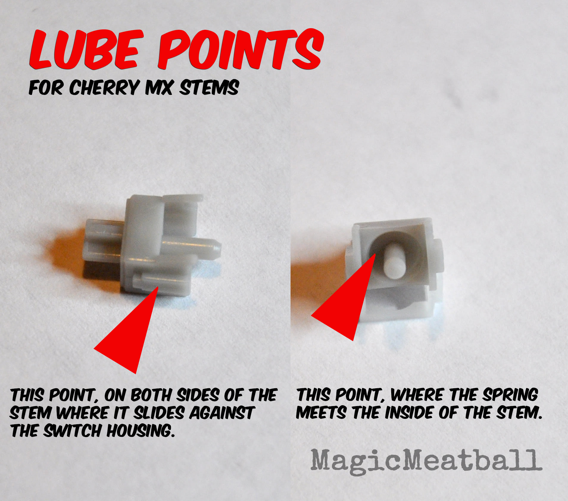

Next up, lubing the stem:
The following photo illustrates the points where the stem contacts with the switch housing and the spring. The sides of the stem will come in direct contact, and slide up and down along the inner sides of the switch housing. The spring will fit into the inner part of the stem.
156710-1

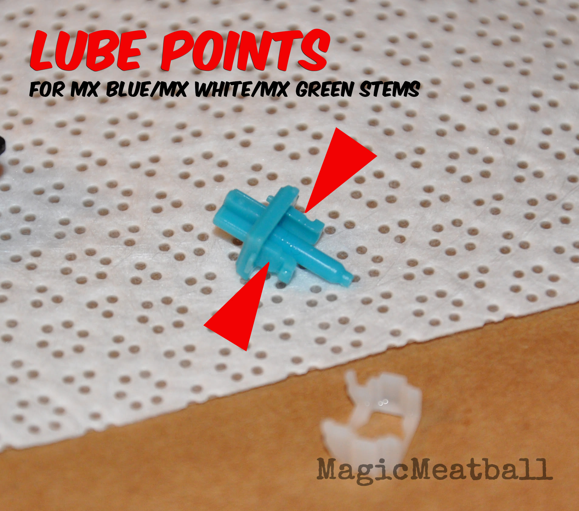

Lubing a 'clicky' stem:
This is still experimental for me. I am not sure how many, or if anyone else does this. Basically, I lube the slider section of the upper part of the stem (colored part) as illustrated in the photo. This has proven to be tricky, as adding too much will cause it to stick, and you lose most of the 'click' sound, as well as some of the tactility from the slider separating and engaging with the stem. Applied in very, very small amounts, the teflon silicone lubricant worked quite well, and quieted the click very slightly, but enough to still be there. When I tried using the Krytox GPL-105, its viscosity was too dense, and caused the slider to stick.
156712-2
*Note: Stem assembly taken apart for reference only. You do not need to actually separate the 2 stem pieces to lubricate. A fine brush should work great for getting in between the two pieces to lube.

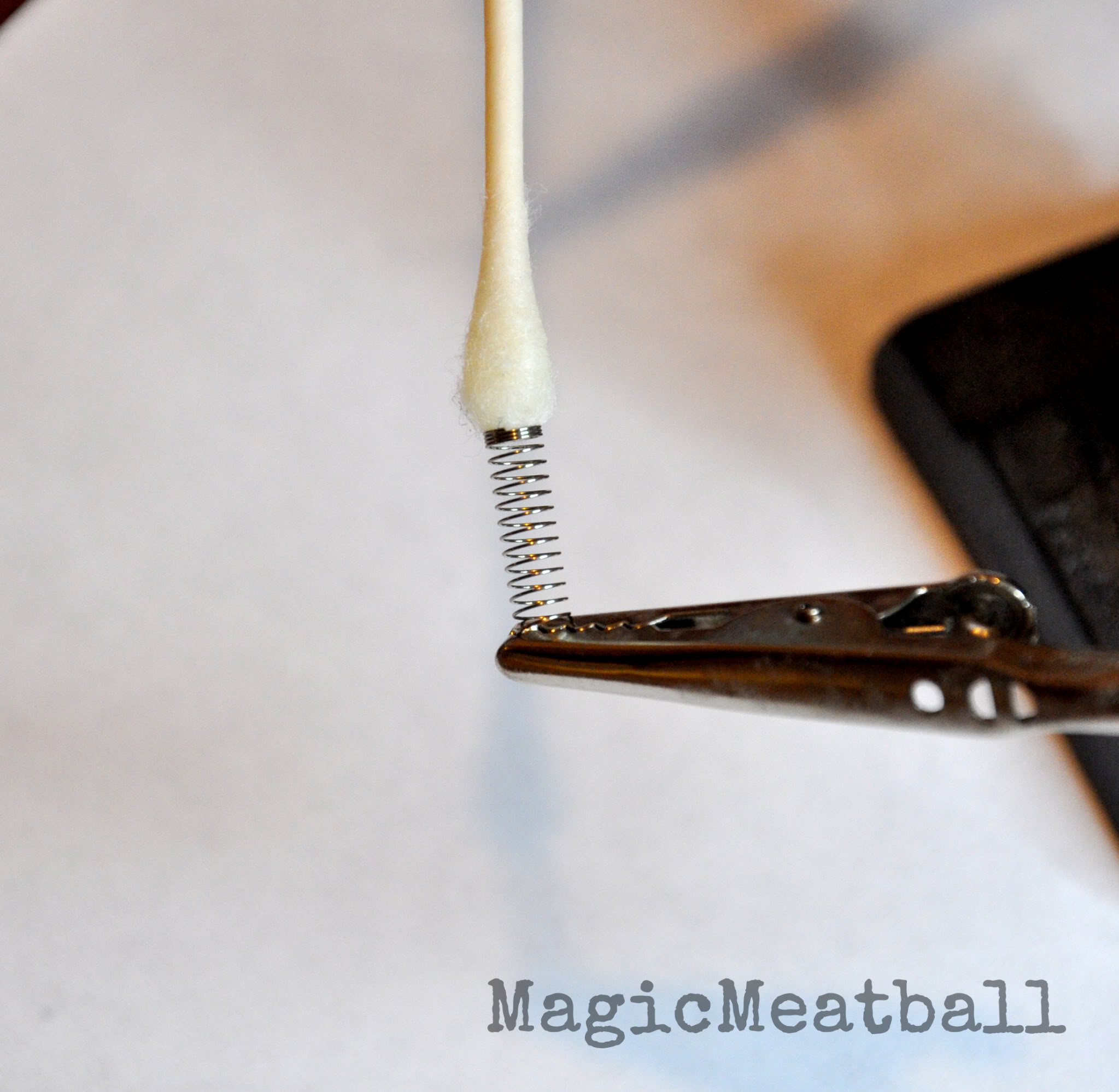

My method for applying lube to specific parts, let's start with the spring:
For the spring, I use a q-tip to apply a fair amount of lube (teflon silicone) to each end of the spring. I lube one end, then place that inside the switch housing, then the other end while it's sitting in the housing.
156714-3
