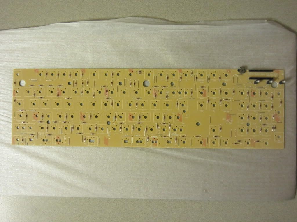

Rosewill's PCB is definitely not as good as Filco's.  Rosewill's PCB is single-sided of so-so quality with through-hole components.  Filco's components are surface-mounted on a high-quality dual-sided PCB.  But both work as they are intended.
I don't ever open boards or do enough research to know such things. Thank you for your wise insight, good sir!
Single sided PCB doesn't scream lower quality. Keyboard PCB is huge, there's no need to go dual sided with so much space to mount diodes and route traces. Filco is also single sided for the most part, and does NOT have SMD components. All the diodes in both Rosewill and Filco are through holes. Only SMD parts are on the daughter board that has the controller, and both FIlco and Rosewill has these. Only real difference I see is that Filco has a tighter solder job at all the connections, and they implement a better way to attach the USB cable/port. Video of a review and the internals of a Rosewill, and pics of the PCB:
http://www.youtube.com/watch?v=ncB-rvAgrLQ#t=11m20s
You decide if it is a better PCB or not, or if has SMD components or not.

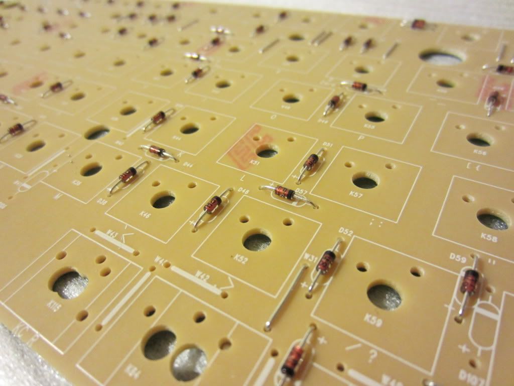

To be honest, the soldering of the controller daughterboard connectors is not that great at all.

Yeah, kind of blobby.  I should take a look at my other Filcos.
http://i.imgur.com/d0s9i.jpg
All the Filco TKL that I have, and the ones that I've worked with for other people have all been single-sided. Here is a pic I just took a few min ago. I'm too lazy to desolder all the switches just to get a pic of the other side of the PCB, but you can clearly see that all the diodes in the pic is through-hole, not SMD. You can see all the copper traces on there too, and if you follow them, you can conclude there is no need for traces on the other side.
So again, single-side vs double-side PCB doesn't correlate to quality. It's a matter of manufacturing cost because single side is less expensive to do. Btw, the solder job near the duaghter board connection is not consistent on every pin in your pic. The soldering on my filco revision looks more consistent around that area. So let me know if your double-sided board is still somehow higher quality  ;)
You are so right.  Clearly SMD Filco PCBs do not exist.  And certainly only the Filcos you have seen ever existed.
And likewise, you also assumed only Filcos with double sided PCB and SMD diodes existed. But it looks we we both confirmed that there are 2 very different PCB revisions. This isn't my point though. You still haven't explained why double sided PCBs and SMD diodes equates to a higher quality board. SMD parts are beneficial where space is extremely limited because of the PCB form factor. Same goes for double sided PCBs. They allow for a more dense PCB. But with a keyboard so big, there are no advantages in going SMD and double sided. From a business standpoint, it doesn't make sense for them to pay more for a double sided PCB when it's not needed. The Filco from the pic is a Majestouch2, bought last year. The one I just worked on a few weeks ago was bought like last month. Litster, how old is that Filco?
I'm not debating anything, I'm just pointing out that newer Filcos, Rosewills, and CM quickfires are nearly the same in respect to the PCBs.

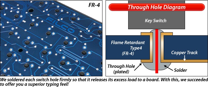

Sorry to hear that your Rosewill died a premature death.  I would not be surprised it died because of its single-sided PCB.
If you have soldered and desoldered switches from keyboards, you will know that switches have to be inserted through the mounting plate into the PCB properly so the load of your typing force is spread evenly on the mounting plate and the PCB, and not on the switch solder joints.  With a two-sided PCB, solder can flow through holes and deposit onto both sides of the PCB, locking the switches in place.  So even if a switch is not fully flushed to the PCB, there is more than just the trace on the PCB to take your typing force.
Imagine if a switch is soldered on just very slightly tilted.  On a single-side PCB, a solder joint would take a lot of the force as you type (instead of the plate and the PCB), and pretty soon that joint would start to push and lift the trace on the bottom of the PCB off, and create a bad connection.  And bad things happen.
Still a good price to get cheap new switches though.
A picture from Diatec Filco's site:
11080-0

I'd say the mini-USB connectors are pretty sturdily soldered down. At least the through hole ones..

I opened up my Rosewill carcass again and looked at the mini USB connector on the PCB.  It is the same connector used in ErgoDox and KMACs (looks very similar, could be a different part and different quality).
The problem on your Rosewill could be just bad luck, too much pulling force from the cable, bad workmanship, bad design, or low quality of the PCB.  My desoldered Rosewill PCB is noticeably more flexible than a blank Phantom PCB that I have here.
