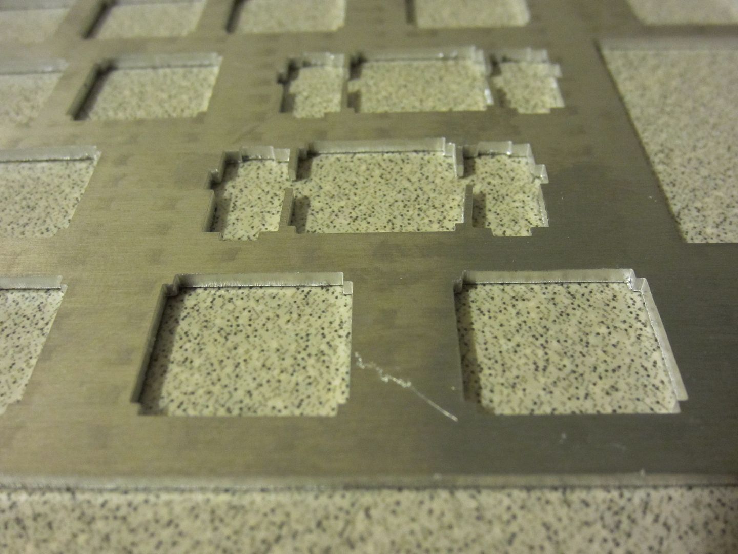

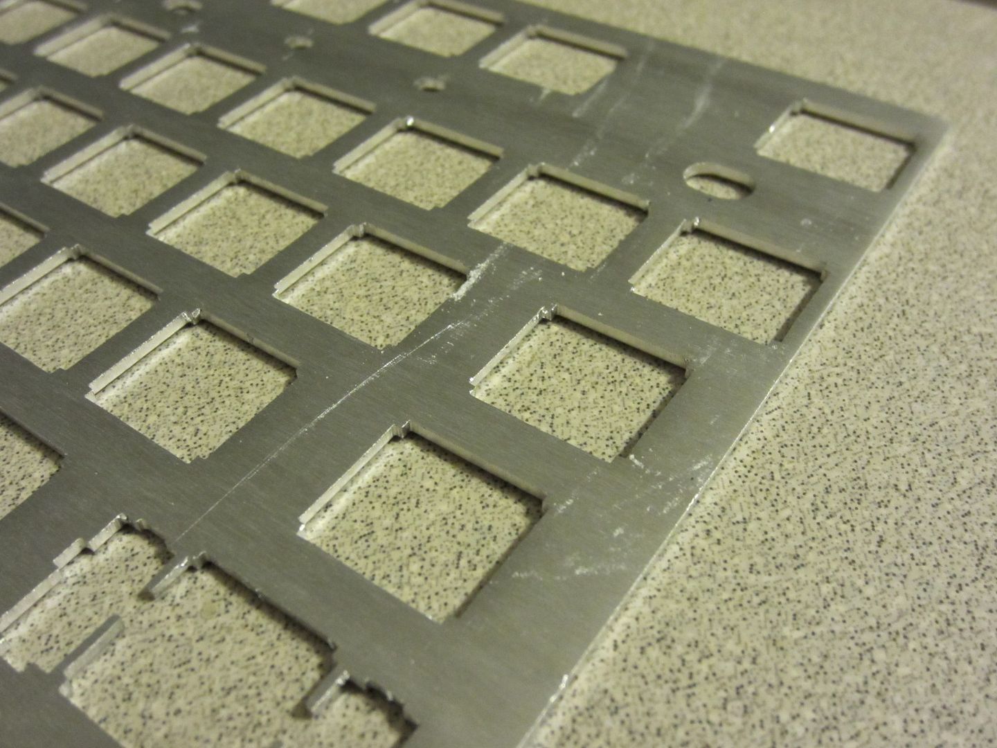

Ok I just received the prototype today. All edges and holes lines up with the case and switches well. The notches holds the switches snug from all 4 sides, while still leaving just enough room on the sides of each switch to open them up without desoldering. Biggest key point is that any type of stabilizer will fit without any compromise to tabs holding the switch or stabilizer. All switches can be removed with the stabilizers sill in without desoldering.
Since this plate allows it, I'm going to have cherry stabilizers on my personal Filco. I think that's pretty unique :) .
Prototype bare plate
Plate overlay on top of a Filco just to verify all holes and cutout positioning. Haven't gotten the chance to solder switches and PCB on yet.
Here's a set of plate-mounted cherry stabilizer and costar stabilizers on the same plate, along with an empty stabilizer slot
closeup of plate-mounted cherry stabilizer and empty stabilizer slot
Now I just have to mention all the imperfections, which are only minor and doesn't affect the design or function.
There are a few "engraved" type scratches. Also, the slot between the stabilizer and switch are extremely thin so it makes that area look like 4 "pins", so it looks like they got bent during manufacturing. This isn't a problem though, I just bent them back with pliers. They actually HAVE to be bent back so that the cherry stabilizers can fit since everything is so snug.
Throughout the whole top plate, there are marks that looks like tracks. I tried scrubbing this off but it doesn't seem to come off. I might try degreaser to remove these marks.
On the back side, there are some areas that are heavily scratched.
Many of the cutouts has imperfections from the laser cutting. This is to be expected though. The laser cutter guy deburred the main outer edge of the plate, but I didn't expect him to smooth out all the inside cuts as well. A quick file on these inner edges gets rid of all these debris pretty easily. The first 4 pics with stuff installed on it had all the edges cleaned off already.
Overall, I think these scratches could have been avoided if there was more careful handling, but it's not a big problem. Lightly sanding the surface could fix that as well. Overall, I'm quite pleased with the design and how the laser cutting turned out. I'll update the OP with some pics.

From the minute or two that I looked at you plate, he should have deburred the bottom of the plate (since the dwg you sent me was showing the top). The marks/track pattern on the top are from the "timer saver", basically a belt felt belt sander/deburrer.
What I did for my stainless plates was mirror the plate so the laser would be cutting the bottom so that the "time saver" would be sanding the top of the plate and giving an even sanded finish to the top, not the bottom. Look at the bottom of the plate to see if it's sanded (I'm pretty sure it was). This mirroring is something you may want to think of before sending me the final dwg.
I also noticed that the legs where the stabilizers go is really thin.
Yes I noticed the bottom was slightly sanded, because it had more of a brushed aluminum finish. It's good that he sanded the bottom, but regardless of which side is sanded, that's only top/bottom surface sanding. The debris and leftover metal shavings can't be removed from the inside cuts unless. This has to be done manually, and I don't expect him to spend 10 minutes for every plate doing this. But ironically, there are more scratches on the sanded side, so it must have happened post-processing. I'll consider having the original DWG file flipped, although I'm going to try experimenting with sandblasting so not sure if flipping it will matter at that point.
Yeah those legs that you're referring to are the the "pins" I was talking about that separates the cherry stabilizers from the switches. They are thin indeed, and I honestly didn't expect them to stay on after the laser cutting, so I'm glad they're actually present after the whole process. But after installing everything, these pins are clamped in between the switch and two stabilizer, so everything is pretty sturdy after installation. The fragility of it might be a problem during the manufacturing step though.

Plate fits everything well. Costar stabilizers are extremely tight because plate thickness is a tad over 0.060". Pictures shows plate-mounted cherry stabilizers though. Don't mind the non-uniform switch colors
Plate with switches, cherry stabilizers, mounted on a CM quickfire PCB.
Everything inside a closed quickfire case.
Same plate inside a closed Filco case.
Can you invoice me or do I need to send payment on my own?
We're all big boys now. You can send payment on your own  ;) . Instructions were in the form and OP.
