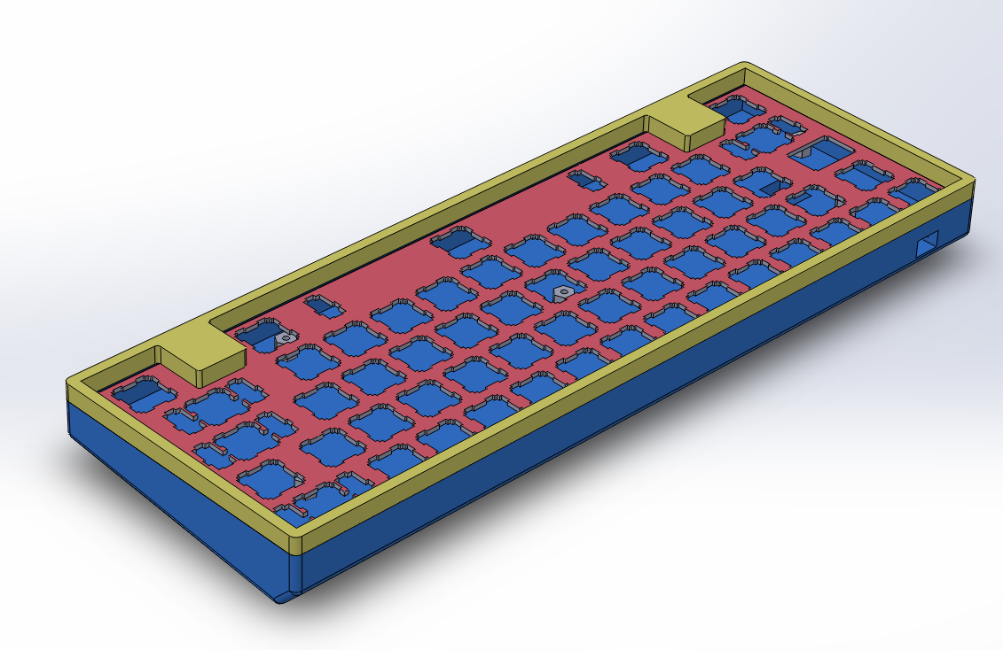

I've been working on this for the past few months and this is what I have so far. It's nearly done but I still have to refine some stuff.
top view with some edge lines
bottom view without any reference edge lines
Color-coded by parts, and next to a matching concept GHkeyad
Color-coded by parts, concept GH70 (GH60 + GHkeypad)
What this design allows:
1) compatibility with all 60% layout - includes poker, pure, and upcoming GH60
2) integrated plate - there will be a plate that screws into the bottom piece of the main case.
3) removable switches - the plate allows for removal of the top switch housing without desoldering. The plate design also allows for rotated switches to be removed. You'll also have the option to choose between costar stabilizers, PCB-mounted stabilizers, or plate-mounted stabilizers. Refer to HERE for more info.
4) modular top cover - The top cover has 3 different designs, allows you to choose a winkeyless cover, HHKB style, or standard full keys
5) optional plate - The PCB can be mounted into the case without a plate, made possible by the 5 screw-in standoffs. This was for people that prefer PCB bottom-out feeling.
6) compatibility with the older poker plate - The PCB/plate combo is a direct drop-in without any mods. The old plate won't be able to screw into the case, but you can still screw this PCB/plate combo down to the standoffs.
7) (maybe) optional brass discs - You can add different numbers of brass discs at the bottom to make the case heavier, or take them all off for a lighter case. Any amount up to 4.
more details and description later....
« Last Edit: Sun, 10 February 2013, 05:32:35 by WhiteFireDragon »

  • King of Stickers (and GBs)
Re: Aluminum case - GH60, Poker, Pure
« Reply #1 on: Fri, 25 January 2013, 03:32:38 »
I like!  ;D
Now whats lacking is the GH60 within  :))
« Reply #2 on: Fri, 25 January 2013, 03:34:23 »
Put me down for one :) also ISO plate option ;)
Would having the case longer at the front for wrist rest be something people like?

4) modular top cover that can be chosen to support standard layouts, winkeyless, or HHKB.
Very nice, meaning there will be multiple top covers available ?

« Reply #8 on: Fri, 25 January 2013, 05:02:20 »
am i missing something? pure has 4 modifiers to the right of space, and i see only 3 holes here? also, pure has '~' key right of the RSHIFT, and there is no hole for it on this pic

« Reply #9 on: Fri, 25 January 2013, 05:09:59 »
Think he's only posted a pic of what a winkeyless top would look like.  I'm sure other case tops would be available if this comes to production.
Thinking about things isn't the same as doing things. Otherwise everybody would be in jail.

« Reply #10 on: Fri, 25 January 2013, 07:02:31 »
Think he's only posted a pic of what a winkeyless top would look like.  I'm sure other case tops would be available WHEN this comes to production.
Let me fix that for you.....I hope  :p
I'm in for one or two as long as they are not available for a couple months unless someone purchases my Tamron lens for Canon DSLR.

Every line and cut will add to the cost, so I'm trying to keep it as simple as possible without making it look too boring (ie, just a tray). I think Beast is done with is case design too, so I'm sure he can contribute to the design.
Nice Job!  Those winkeyless blocks look huge in the picture haha.
Because we're all so use to seeing blocks on TKL size cases. The frame on these are smaller so the block to frame size ratio will be different. The winkeyless block and the standoffs look out of proportion to me too.
Now, the added bonus to doing all this work, is that it might be adapted to work with the GHpad  :D )
I could consider it, but as of right now, there's no finished PCB or dimensions to work from. I already have a poker, pure, and prototype GH60 PCB to reference to.

Then you probably missed this part:
Poker and pure can only fit in a top cover without the winkeyless block. The one in the current picture can only fit a plate for 1.5x modifiers, which only a GH60 PCB can support. The end design will have different top covers and plates available (hence why it's "modular"), but the bottom case will be the same for all keyboards.
Yeah, I realize it'll have a different top, but given the layout, wouldn't just be a rim around the bottom tray since the Pure is just a pile of keys.  :confused:

I think you finally understand how it works. Yup, poker or pure, or any other layout that is not winkeyless will have only a cover that's literally just a rim that screws down to the case. That block in the pic is what covers the windows key. For a HHKB layout, those blocks are slightly enlarged and moved to the bottom corners to cover the CTRL.

Looks nice WFD. The Winkeyless blocks look a bit thick, but nonetheless good. :)
Hmm maybe because of the angle? Here's the same case with parts color-coded, and at a different angle:

Here is the same case with a different top cover, this is the Happy Hacking Keyboard style. The cherry MX version of the HHKB, but this will only be possible with the upcoming GH60 layout options. The current poker or pure does not support 1.5x bottom modifiers to pair up with this HHKB block style.
« Last Edit: Sun, 27 January 2013, 15:55:43 by WhiteFireDragon »

A more detailed description of the feature that I'll also copy/paste to the OP:
5) optional plate - The PCB can be mounted into the case without a plate, made possible by the 5 screw-in standoffs. This will satisfy people that hate plate-mounted PCBs.
How does the plate screw in?  Can't see how that connects to either the top or bottom.
I'd like to know this as well. Seems like the bezel is too thin for tabs on the plate to screw into the base.
Also, is the base at the same angle as the stock poker/pure cases? Any possibility for standoffs?
There are small recessed edges around the whole inner rim that the plate sits on. Technically don't need any tabs, but there are also 4 tabs to screw the plate into the case. The upper cover will screw into the main bottom piece, screw going from bottom up so the holes and screws won't be visible.
I don't know if it's the same angle as the stock poker/pure case. I designed the case with reference to the PCB measurements, not the stock case.
Lastly, guys this is not an order thread lol. No ETA at the moment, it's last on my priority list. I still need to take care of all the current GB stuff, pending keyboards I have to do, and GH prototype first.

Circular cuts for brass disc inserts to add weight. Kinda looks like a DJ table  :D
A thick rectangular plate/bar made of brass can fit a larger volume, but I think they're much more expensive than the same amount of volume manufactured in discs. That's why I did circle cuts instead of one long rectangular cut. I think the machining time to do round cuts is also less than a straight rectangular one. Does anyone actually know?
