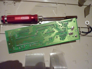

Nut driver arrived today (its cool "EDS" came with stickers  :cool: ) and I opened it up.
This thing is clean inside, theres one plastic rivet thats popped off, but thats it.
Looking at how its constructed for myself I'm even more skeptical that any water or
moisture ended up near the membrane, particularly around these keys (ZXC).
You could pour water directly over the keys it it would just drain right out.
Like I've mentioned this was bought as a brand new KB. Came with the original foam
scaffolding, but without the box...hmmm
I really want to avoid getting to the membrane and doing a whole "bolt mod".

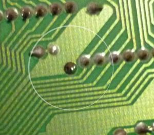

I had a look over the controller PCB and there is only one spot where a solder stuck out.
It doesn't look right, but I'm no expert.
15537-0
It sits low in the board. Looks oxidized. I haven't got a magnifying class, but what I can see is that it doesn't
appear to be making proper contact with the circuit - If at all.
15539-1
Looks like a bad solder or is this normal?
I have no idea, anything is possible I guess.
Any suggestions? (I have a soldering iron)
« Last Edit: Wed, 13 March 2013, 08:06:51 by joules »

I'd start with connecting the membranes back and checking if it works now.

Fail.:mad:
Tested with some aluminum tape.
@mich
Done it twice now. Everything works except those @#$% keys.
I really want to avoid cracking it open. I'd rather do some soldering that remove all those rivets.
Cool nut driver eh? Anodized Aluminum..YEH cooool.  :cool:

This solder point doesn't look like it has anything to do with key scanning.
BTW, did you try removing these keys and pressing directly on the hammers with a screwdriver or something?
