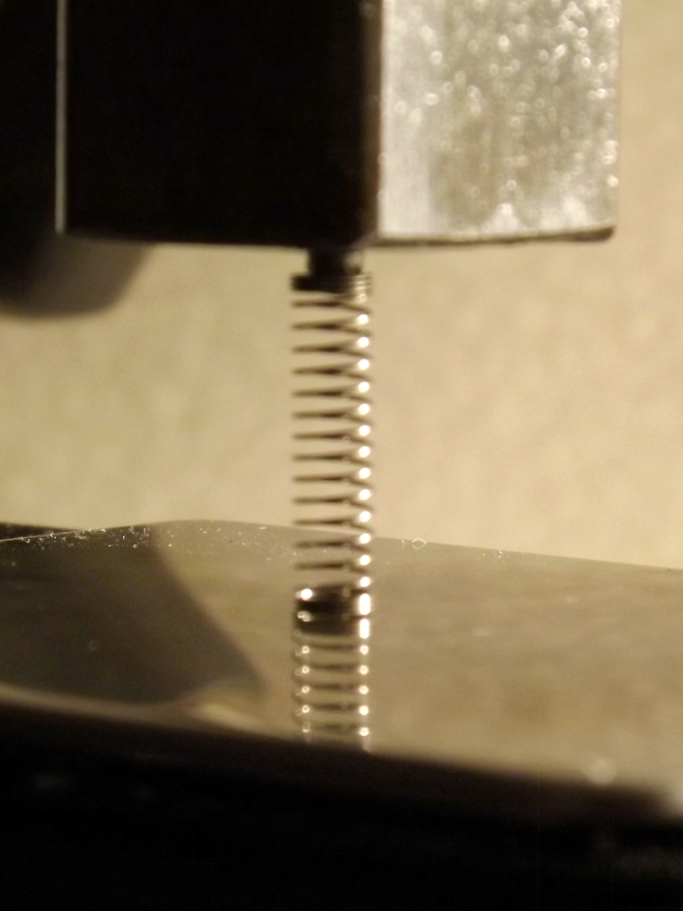

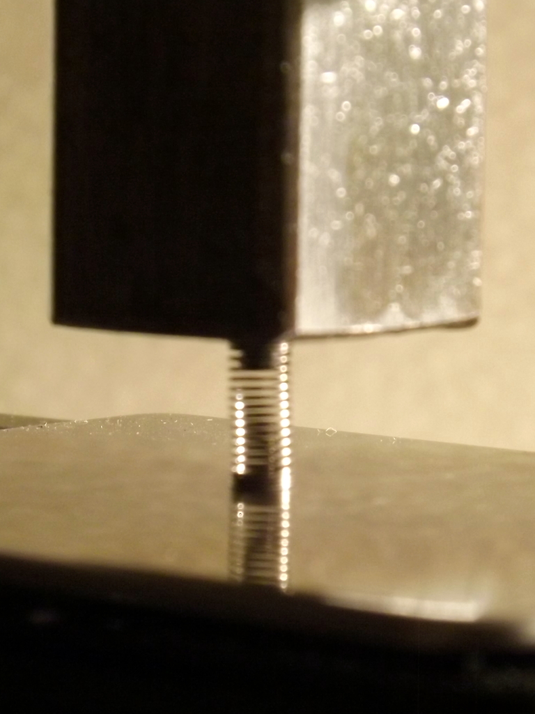

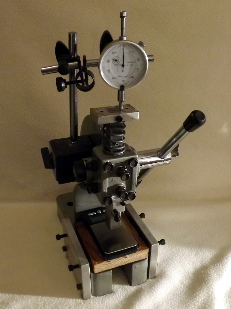

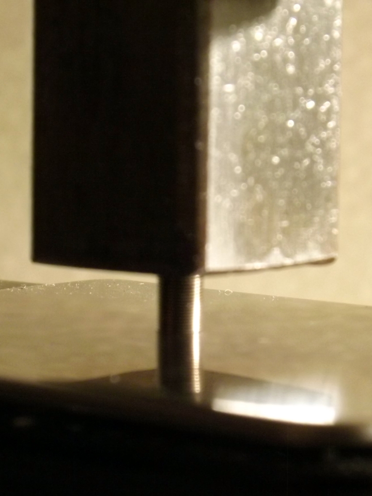

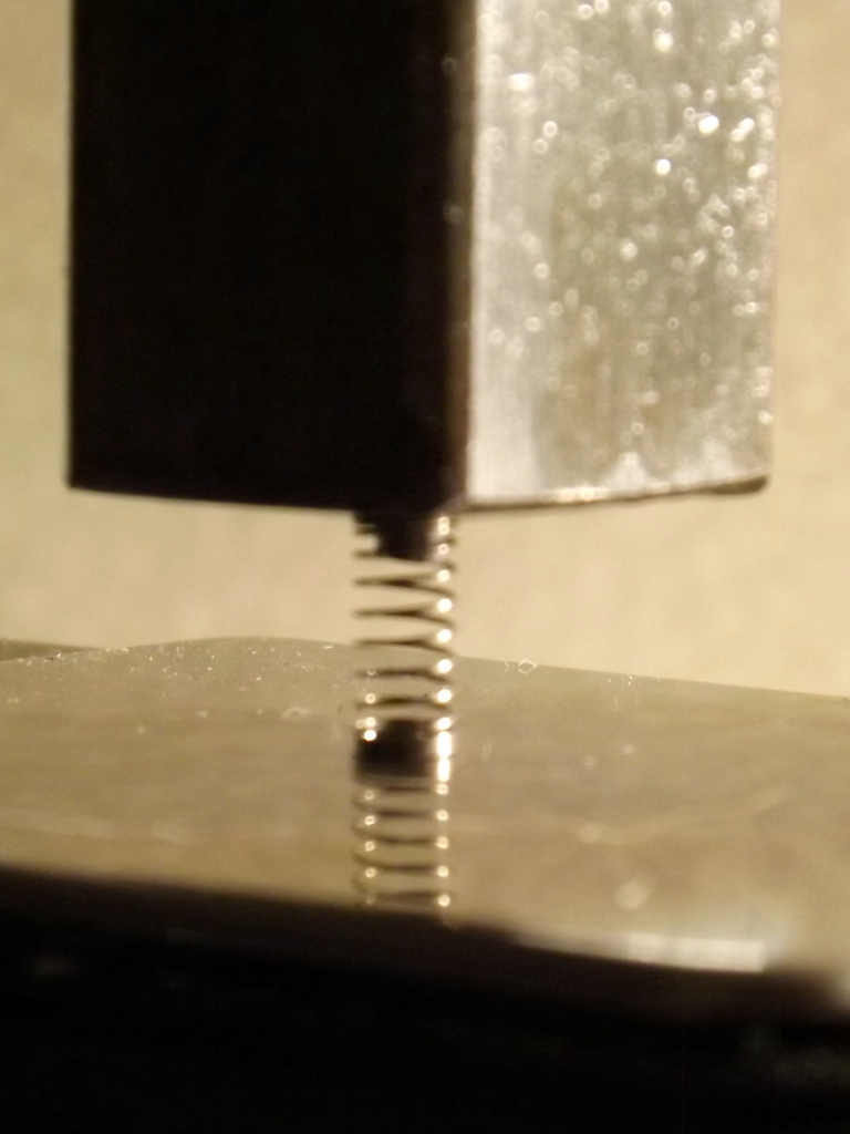

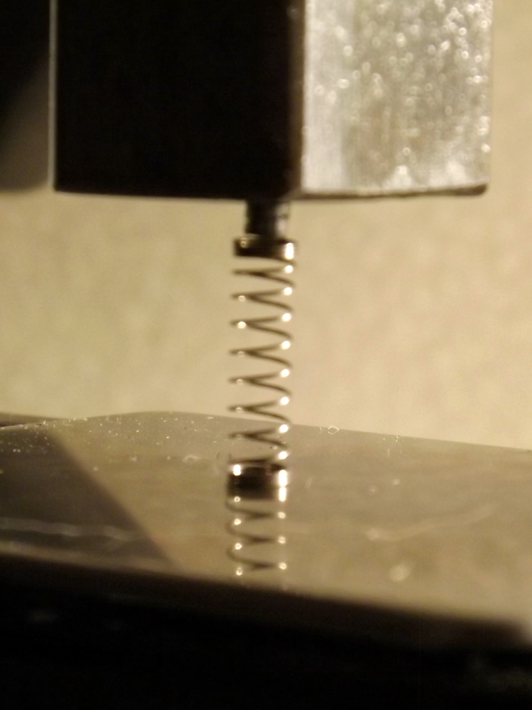

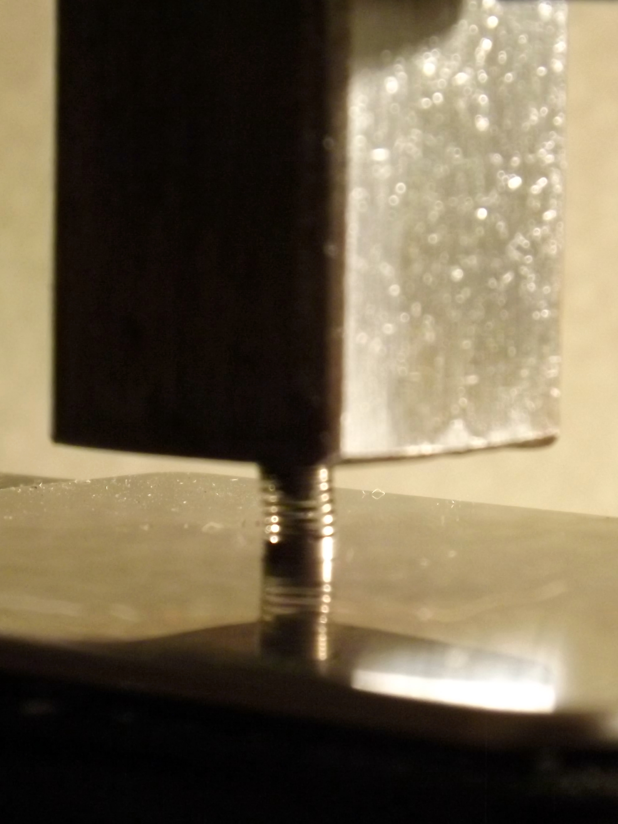

There has always been some debate over the various types of springs that are available for Cherry MX switches and how the spring rates relate to switch actuation force.  Adding to confusion are the aftermarket Korean springs that are sold based on the spring force at the bottom of the switch movement.
I decided to try to build a rig that could consistently measure the force of these springs for the purposes of comparing them.  If we can measure the spring force at the top and bottom of the switch stem movement and assume that the springs are linear (which is mostly the case), we can then plot the spring force and compare different spring designs.  A few Cherry switches were sliced open to accurately measure these two positions and to observe the spring behavior inside the switch.
I do not have access to expensive spring force measurement instruments.  Instead, I used a heavily modified arbor press as a jig to consistently replicate spring compression at the top and bottom of a Cherry MX switch movement.  I then use a digital jeweler's scale (supposedly accurate to 0.05g) to measure the spring force at these two positions.  The large spring at the top of the jig is used to take the backlash out of the arbor press's gear mechanism.  The block on the front of the press shaft provides the top spring position while a pin at the top provides the bottom position.  A removable shim allows the press to be completely lifted off of the spring so that the scale can be calibrated with the spring's own weight before each measurement.  A dial indicator is used to re-verify each measurement position.
The biggest problem was measuring the spring force at the bottom of the movement on the lighter springs.  It turns out that because they have so many coils, the lighter springs are almost fully compressed when the switch is bottomed-out.  Since the coil spacing is not perfectly even, some coils bind-up before others.  This has the effect of increasing the spring rate near the bottom.  Particularly bad samples were skipped, but this effect is still apparent in the variance of those measurements.  To help cope with this, the range of motion was reduced by about 0.2mm for a total of 3.8mm.
Cherry MX "heavy" spring
Cherry MX "light" spring
The press proved to generate reproducible results, once I got the hang of its little quirks.  For a given spring, it reproduced measurements well within 1%.  For each spring type, at least 20 samples were measured and the results averaged.  Where possible, I mixed springs from different batches.

Ah yes, I forgot about that part.  I have pictures to post about this as well.  Using every method available to me, I can find no difference between modern blue, red, and brown springs.  I measured:
  • Wire diameter using a micrometer
  • Coil diameter using calipers
  • Unsprung length
  • Coil count
The only other variable (besides temperature) that has a notable impact on the spring constant, k, is wire composition.  I don't have a way to measure this, but I am fairly confident that it is not an important variable given the following:
Just look at the variance and error in the data table for clear springs.  These all came from the same batch of MX clears from 7bit last year.  The sample-to-sample variance is very high because the spring tolerance is terrible.  Cherry doesn't care enough about spring tolerance to do better than +/- 5%.  Since I'm able to reproduce measurements within about 1% for a given spring, I am reasonably confident in these numbers.  The tolerance of the "heavy" and "light" set are within that same margin of error.
So here's the thing, guys.  We all know how things work in the corporate world.  Designers may have hopes, dreams, and expectations, but then the bean-counters come along.  There may have been a time where blue switches had slightly different specifications than brown switches.  In fact, I am quite confident this is true since I have seen and felt different springs from old Cherry keyboards (the whole "vintage" Cherry thing).
Today, the story seems to be different.  My guess is that they probably buy the cheapest springs they can find that meet their minimum dimensional and endurance requirements and don't really care what they are made out of or how.  Even if Cherry specified different spring materials for blue, brown, and red switches, the difference is swamped by the sample-to-sample variance and/or is not measurable using the methods that I have.

Since I don't have many modern black springs, I may have made a mistake in lumping them together with green/white.  It may also be that Cherry has used the green spring in blacks when it has suited them (stock issues or whatever).
Russ

That looks like the springs in the vintage blacks that I have.  Somewhere I have a pic of the black, green, and white spring but for some reason it eludes me.
Russ

This is great and very helpful.  This confirms my guess about stock clear and black springs.
To make sure I understand your last table, are you listing percentages of compression from relaxed to fully compressed?  If not, are you accounting for the fact that springs don't get fully compressed when bottoming out a switch?  That wooden shim is at a 4mm depth?  Your fully compressed spring shot looks a lot more squished vs a spring in a fully depressed switch.

i think your error is much higher than that, but this is a great start. i think we need to start a new thread for the spring dyno project..

I have a 65g and 67g Korean spring I can send you if you want to test some additional springs.
I am kind of surprised by your Black vs Clear spring findings though.  I'm typing on a keyboard with Blacks right now and have a keyboard with Reds and Blacks with Clear springs in them, and the key switches feel heavier with the Clear springs than the Blacks.
I wish 65g and 67g springs were added to this comparison.

Is there a large difference between 62g and light springs in terms of feel? Obviously the chart says it does feel different, but can someone explain to me how it feels different? I"m using ergo-clears currently.
Re: Cherry MX Spring Measurements
« Reply #40 on: Wed, 07 August 2013, 11:41:36 »
62g is slightly heavier than the stock blue/red/brown spring. I should've said that in my review.

As I said, I have set this aside for the moment so I can get on with some other projects.  For example, I still haven't built my LZ-GH.  :(
That said, I have a couple of other sets that I am going to measure as specified in the OP.  If there are other springs that folks would like to lend me for the cause, I can measure those on the same rig.  While its accuracy may be questionable, it has proven to be relatively precise which makes comparing them meaningful.  I'd like to see at least 20 samples to gather meaningful data for a given type.
Russ

Awesome! Thanks for all this work. I'm surprised to see how similar black & clear springs are.

Thanks for the testing! Proves my theory that we need 70g springs...
The gap between stock-light (and 62g) and stock-clear (and black) is quite huge, eh?
70g would probably be the sweet-spot between a well defined tactile-bump and not too much stickiness for clears!
