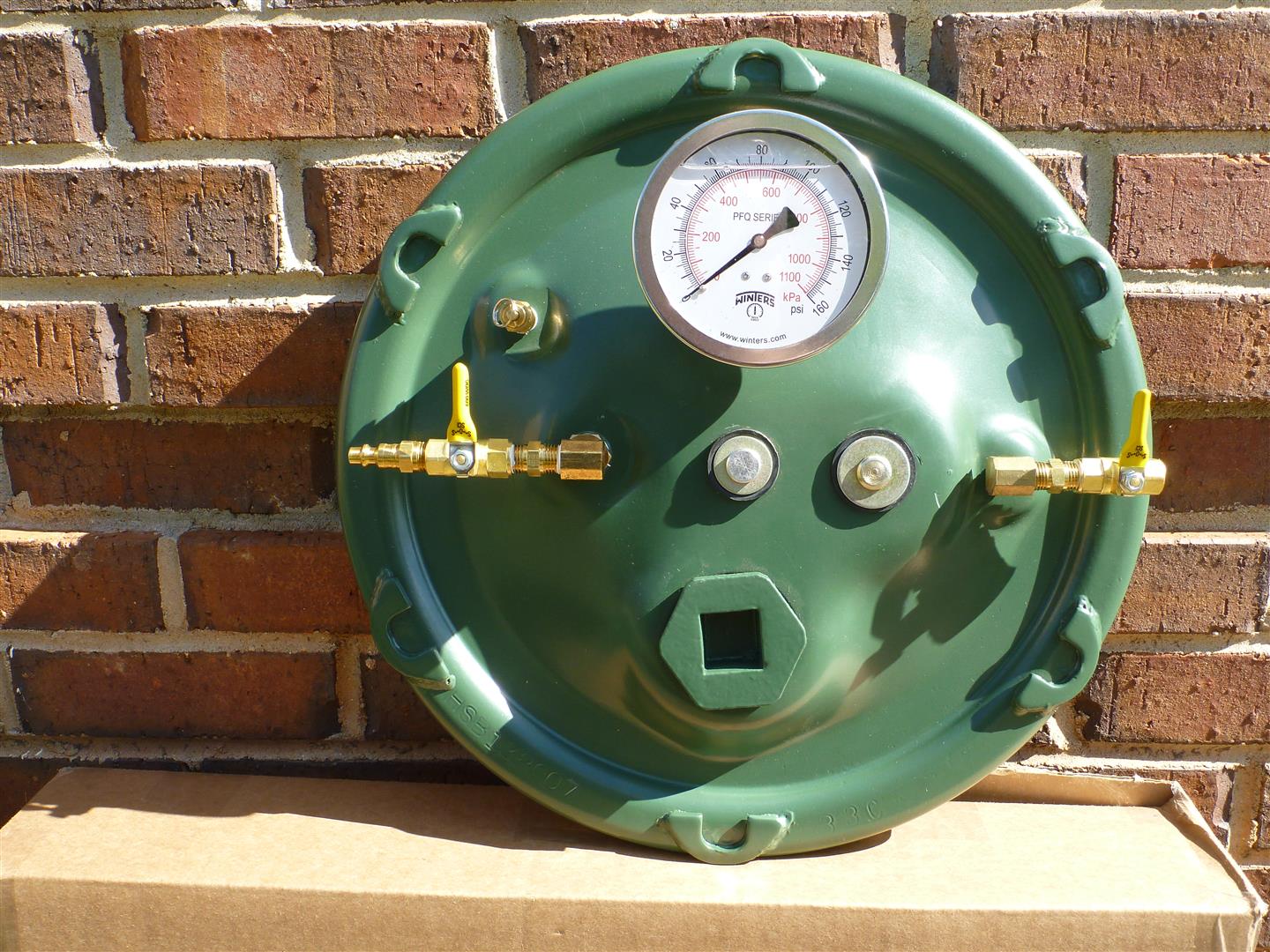

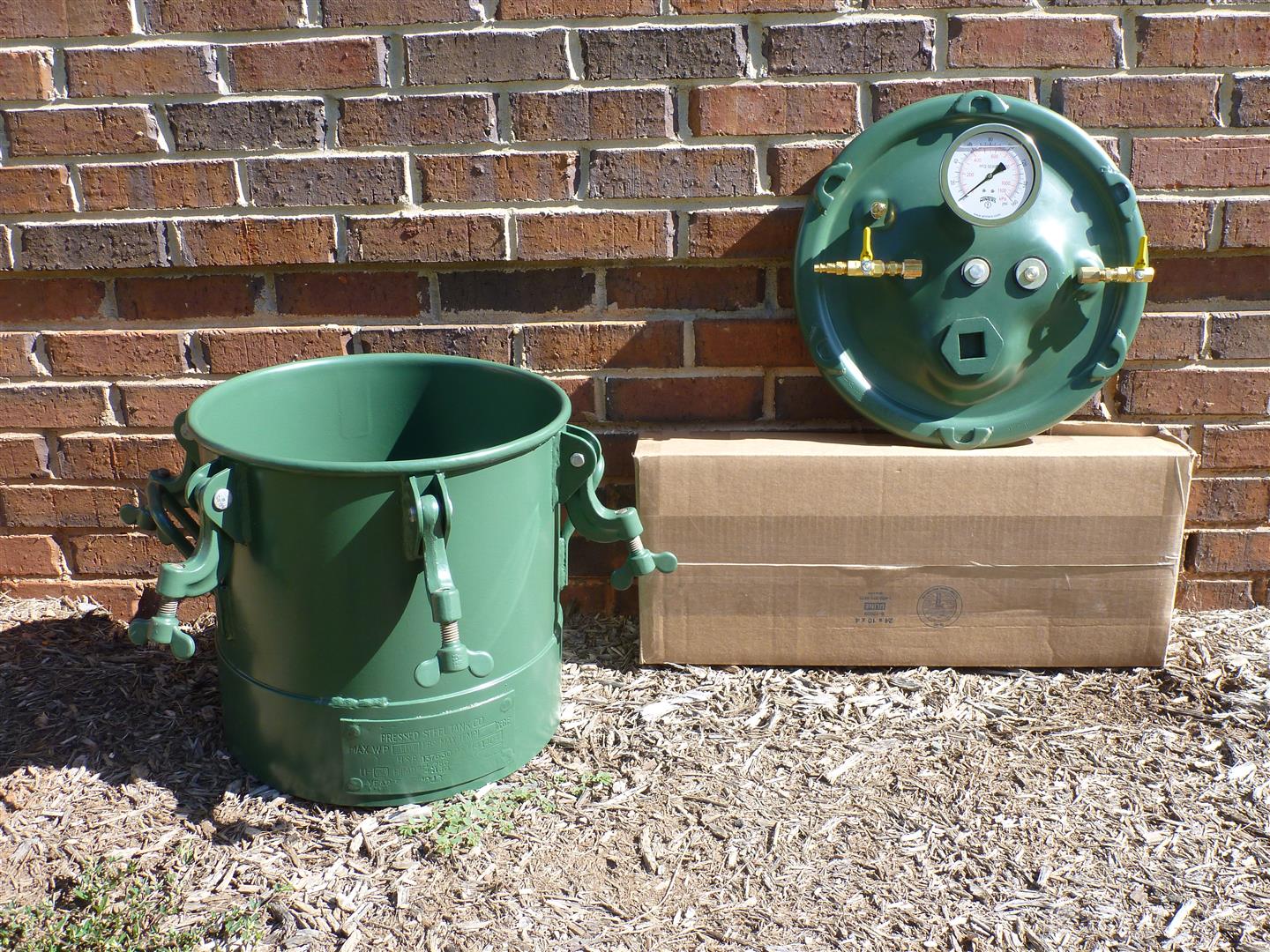

Some updated pics.
Pressure pot back from powder-coating, with fresh piping and gauge
35391-0
Used a large dial gauge mostly for style, but also to help see it better indoors
35393-1

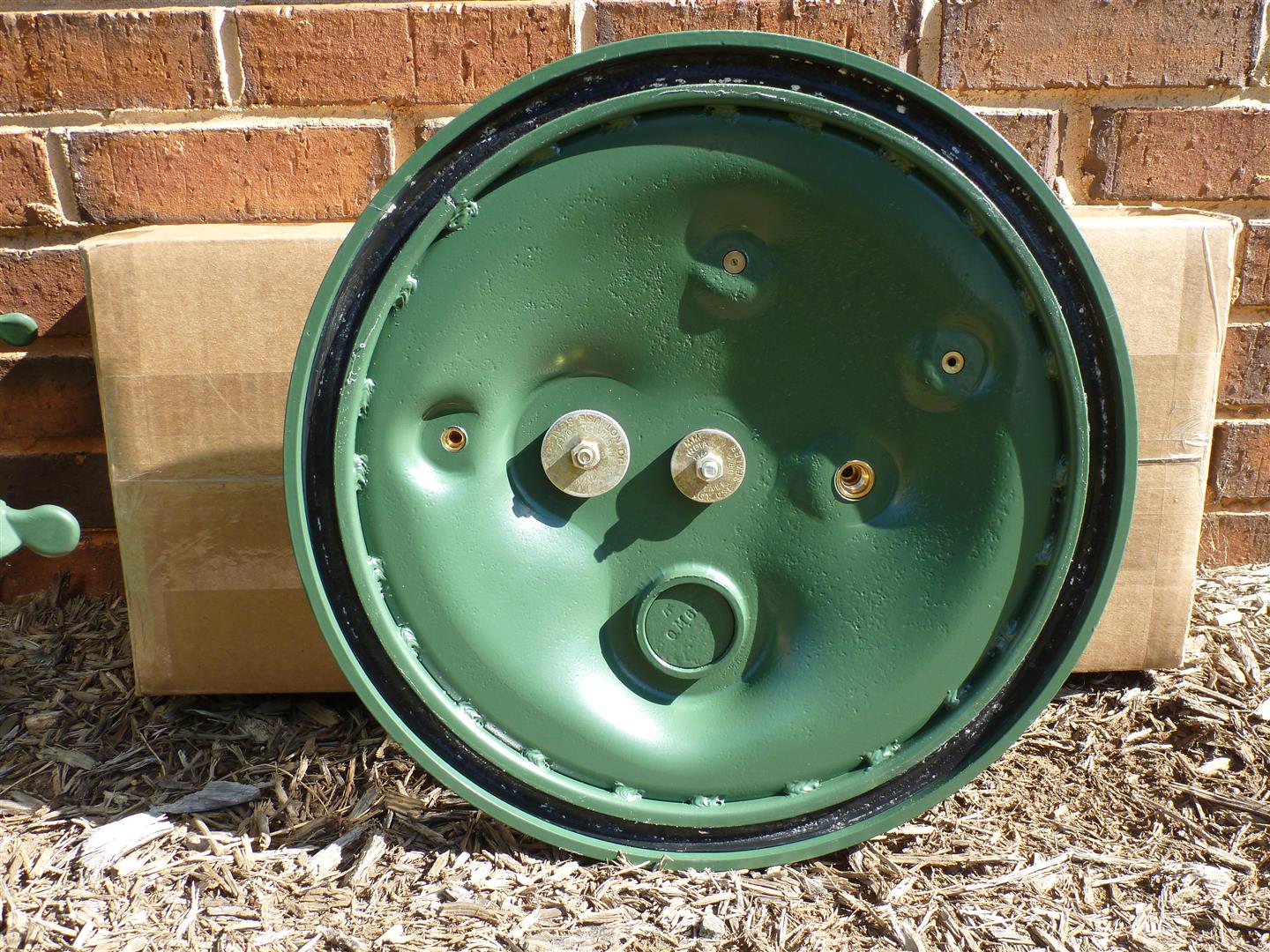

Interior of lid, showing the fittings used to close the two large openings.
35395-2
Pipe plugs, installed backwards so the plate side is inside the lid - better security against blowouts.  Some pitting in the metal, but none of it serious.  Seal was in good shape, apart from embedded paint residue, but I used almost a whole tube of aquarium sealer to run a bead along both sides of the seal for maximal air sealing.

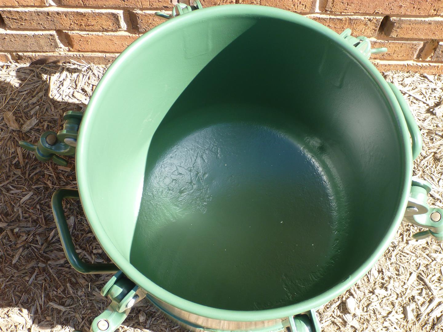

Big old pressure pot
35397-3
Galvanized finish was flaking off in some areas, the paint shop media blasted it before powder-coating

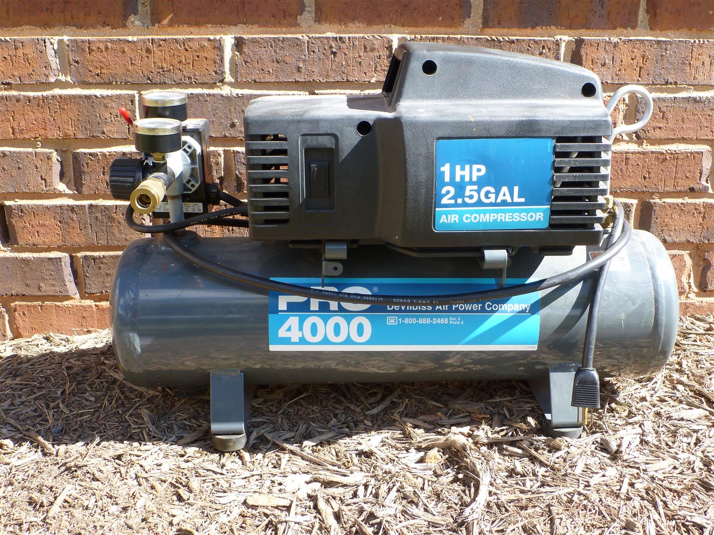

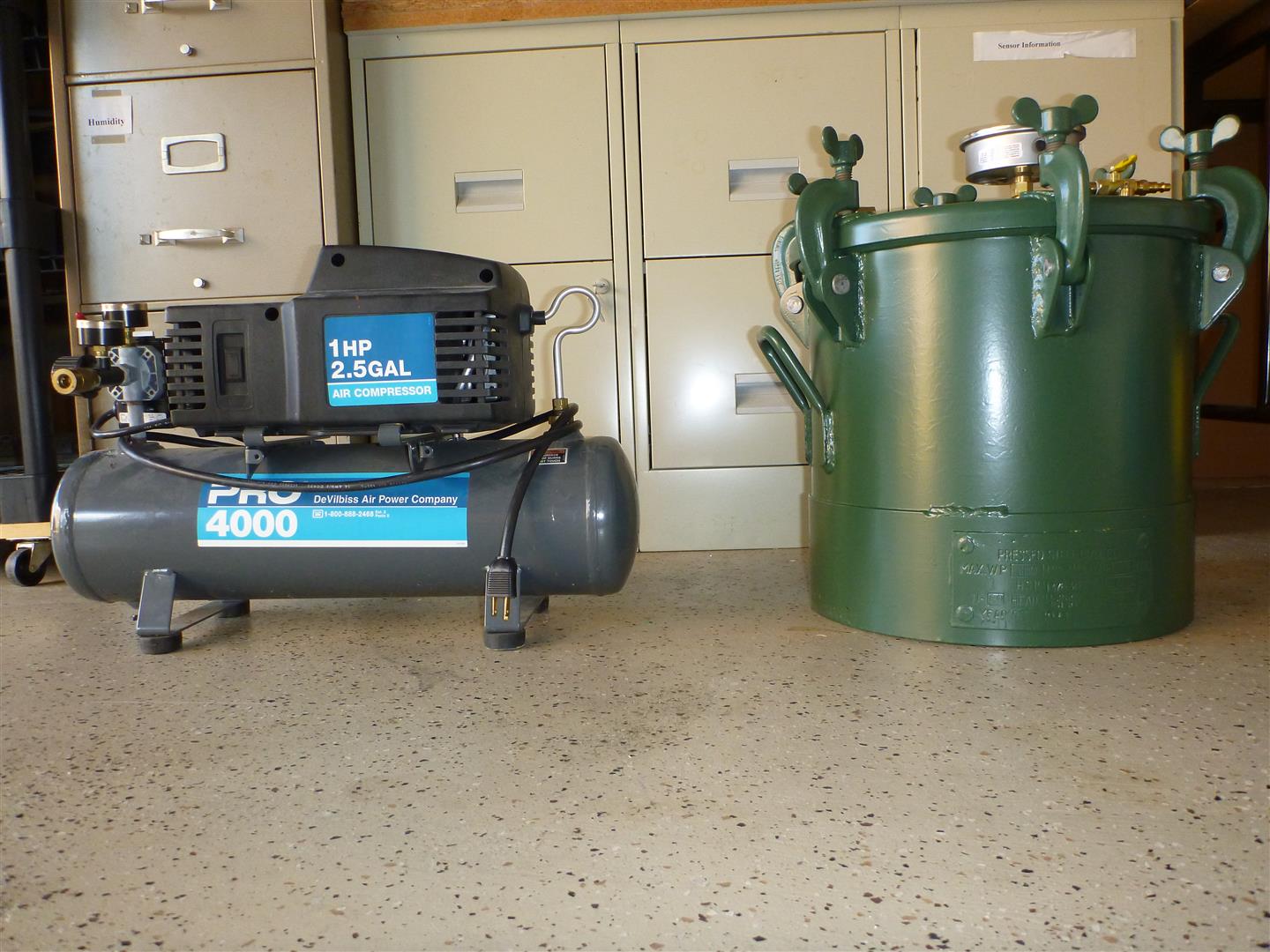

Air compressor.  Loud.
35399-4
In the garage, going to try a pressure test later today, once the neighbors are all awake.   :p
