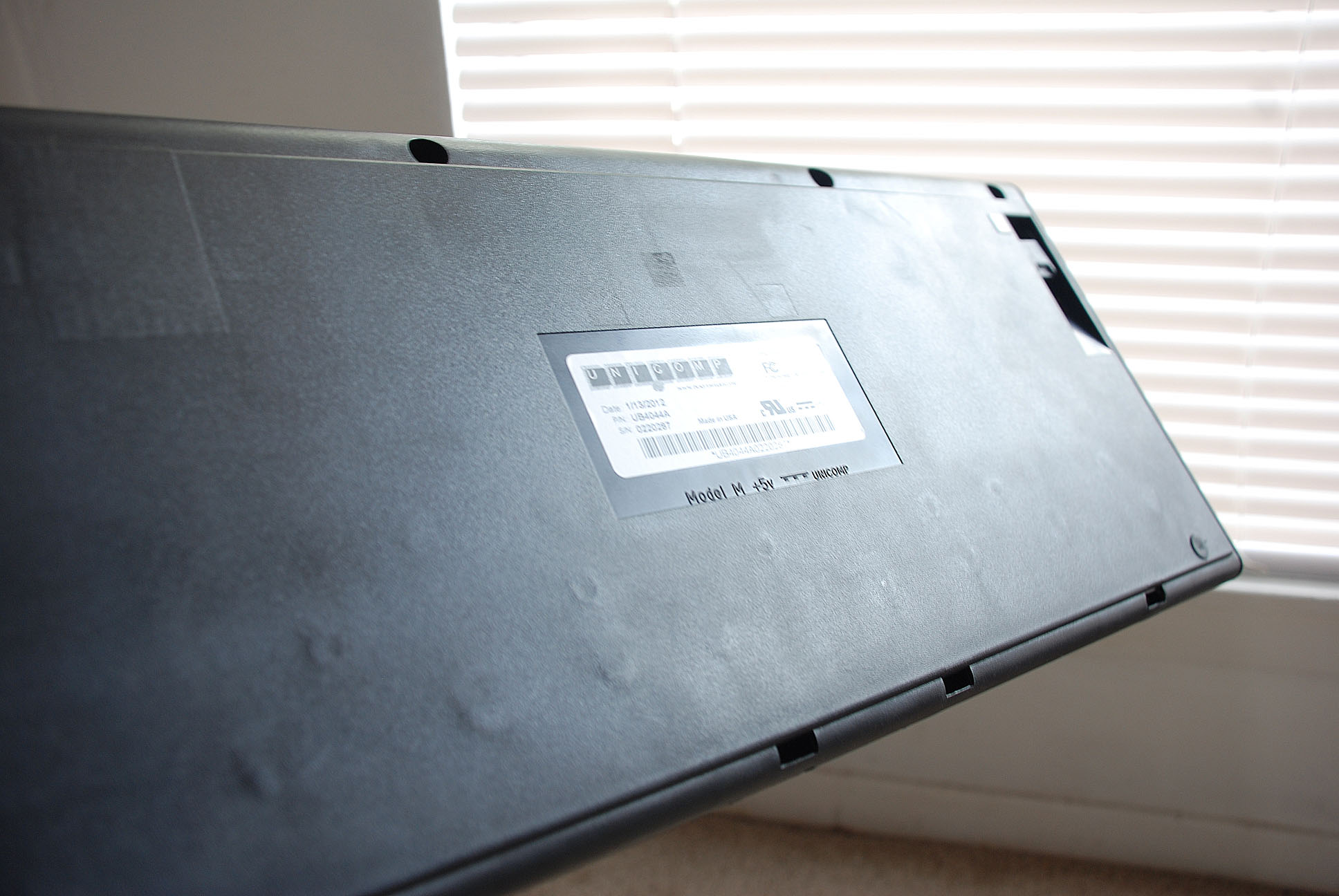

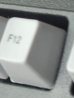

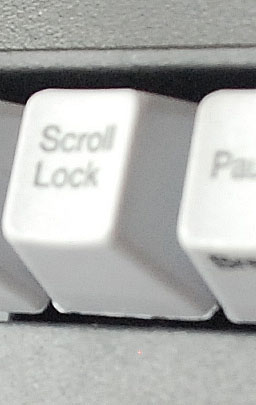

Unicomp keyboards are not clones. They're the same keyboards. Reduction in quality began under IBM's ownership, step by step. There's no single Model M specification — the keyboards changed with time.
Do you own a Unicomp?
Model M quality didn't decline until Lexmark began producing them, and although there were minor differences theretofore, you didn't get the feeling you were typing on a shoddy imitation. That's the difference.
There's not a lot of signficant difference
Well, I mean, other than the creaking plastic, cosmetic imperfections on the surface of the case, flashing around key caps, case flex, extruded / protruded plastic on the back of the case:
Exhibit A: Extrusion points in the plastic on the back of the case
Exhibit B: Key cap flashing
Exhibit C: More key cap flashing
Exhibit D: Cosmetic imperfections appear as smudge marks on the surface of the case
Exhibit E: Audio of creaking - the result of pressing both halves of the case together

By definition, a clone is an imitation, and a replica is a facsimile. Are you really suggesting that the difference between a crappy, hand-drawn imitation of the Mona Lisa and a bona fide replica has nothing to do with quality? Really? So, a version of the Mona Lisa scribbled out by a 5 year old wielding crayons wouldn't be considered an imitation(ie. clone)?
I think I meant the opposite of what you interpreted me saying. A clone can be better than the original as well as being worse. Some times, the improvement can be objective (again, compare the DEC LK201 with the Cherry equivalent) or subjective (I saw the Mona Lisa once, and was unimpressed. I would have preferred if it was larger and done as a piece of abstract art, but that's just me.)
I agree. In fact, that was the exact sentiment I expressed which started the discussion about clones(ie. that some clones are better than their originals).
If you purchased the same model, assuming there were no manufacturing errors, it could most certainly be considered a replica. What do you think a replica is? It's a duplicate, facsimile, or reproduction.
I see replica, clone and whatnot as terms that describe a particular design's relationship with another design. If you mass produce something, then you have multiple instances of the one design. You could say that every instance of the design is a replica of an original, but I think this is a rather tenuous way of looking at things, even if it's technically correct in some ways. The issue in my mind is that 'replica' has connotations of some external party attempting to recreate a given item. Unicomp isn't really an external party, and they haven't recreated something, they've merely continued production of it, albeit with lower quality in recent years.
Technically speaking, the definition of replica and clone doesn't limit the idea of multiple instances back to a single, original work, such as a famous painting. It can simply apply to a product that is a copy of another product, such as a keyboard(although in the case of a replica, it would be an exact copy). Replica would especially apply to items on an assembly line, because each item is often an exact copy of the other.
I defer to my McDonalds Big Mac analogy:
Let's say a company, we'll call them Uniburger, bought the rights and equipment to make Big Macs from McDonalds(because McDonalds planned to stop selling them). And let's say Uniburger made a decent burger, and even cooked their burgers on the same equipment that the original Big Macs were cooked. However, let's also say the quality of Uniburger's version of the Big Mac was clearly inferior to the original. Do you think most consumers would consider Uniburger's version to be an original Big Mac or an imitation?
Of course, the relationship in quality between a Lexmark and a Unicomp is a bit more complicated. Older Unicomp keyboards were closer in quality to the Lexmark predecessors than current ones (and some were even sold as IBM-branded Model Ms.) At no point has the design changed, it just got built to sloppier standards.
The analogy never implied that the design changed, but that quality declined.
I suppose this boils down once more to how one chooses to define a 'clone'. In my opinion, a clone implies that somebody has created a design that approximates some or all of the features of another design (as contrast to a replica where somebody has attempted to create a design that is identical to another as far as is possible). Again, I don't think the Unicomps fit into either category because they haven't created anything new, they have just continued production of the same design (at least with the Classic 101)
It's not about whether they've "created" something "new". It's about how accurately they've copied the original Model M in all its glory. The quality control issues I've mentioned change the accuracy of said copy, hence it's not exactly the same, thus it's not a replica. One could argue that Lexmark versions weren't exact copies, either. However, for the sake of flogging a dead horse, Unicomp's current production copies are so inaccurate that, due to the degree of qualitative decline, they present themselves as cheap imitations or shoddy clones, in my opinion.
I can't help but look back at early Model M's produced by IBM as the standard of excellence. When I place those models juxtaposed to Unicomp's, there's just no comparison, in my opinion. Unicomp's current versions look, sound, and feel like shoddy clones to me. I mean, don't get me wrong, I think they're good keyboards in their own right, but they're hardly up to early Model M standards, in my opinion.
I also think the term 'clone' carries certain baggage in the keyboard community that is not applicable to Unicomp keyboards. Clone switches, for example, are not always interchangeable with real ones, but just about everything in a late production Model M is interchangeable with a Classic 101 because they are the same design just built to different standards.
Again, it's not strictly about the accuracy of the design but the overall accuracy of the copy compared to earlier versions.
