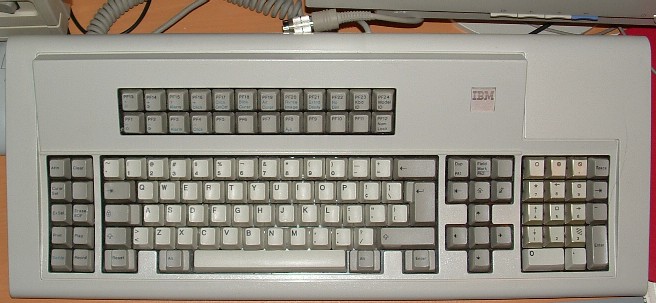

I've been using a IBM 1397003 for probably nearly two years now as the keyboard on my main machine, and it's been fantastic.  This is pretty much the same thing as the Unicomp 122 Emulator (Termin-ator!) 'boards.  IIRC, 139700* are the earlier IBM part numbers for these, 1397000 being the US model, though I believe it will still have the ISO/international layout for the alphanumeric block.
Operationally, it has a detachable PS/2 cable and works fine with standard Windows drivers, however the extra keys, while not causing any trouble will mostly do nothing, exceptions in my experience being as follows:
F13 - LWin
F14 - RWin
F15 - Menu

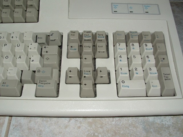

Also, the nav and number blocks are particularly unusual for PC users; I'll attach an old picture.  The physical layout may be a problem here.  Personally I don't mind it at all (having adjusted to it so long ago now...), but that's me.
So, to get around the odd default "placement" of some keys and make use of the rest, I'm still using D-System's Keyboard Remapper, having hacked a 122 keyboard definition for it.  A much better way would be to use autohotkey, since it can recognise F1-F24 "out of the box" and can support any keys you have the scancodes for, and there are instructions for obtaining them on their site.  I'll attach an incomplete list I made of scancodes for the 1397003, which does cover the more exotic keys.
As Unicomp discuss, the Emulator version is different from the PC/5250, in that it returns different scancodes for the non-PC keys, I seem to recall for another 5250 emulation standard.  There was a useful PDF on their site giving a list of codes for each key at http://www.pckeyboard.com/pdf/PC5250UserGuide.pdf once upon a time, attached a copy.  I'm not familiar with the emulation software with the KMP files, but some attempt has been made to make the layout more PC-friendly, though again the navigation block may be a stumbling block.

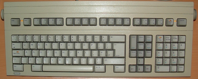

That said, even PS/2 compatible boards could be problematic.  The Wang 724 is a great keyboard [salmon ALPS and speaker-provided key clicks] and is fully PS/2 compatible despite being intended for the rather different Wang PCs, but its extra six physical function keys produce combos in the form Alt+Fx rather than unique scancodes.  This does mean you get a nifty Alt+F4 key under Windows, but if you wanted to software "remap" them you would have to change what Alt+Fx does, which is potentially a big problem.

With the blue text on the keycaps for PC commands, that's the keyboard for the IBM 5271 3270 PC, isn't it?  There is a separate 8-bit ISA controller card for needed for making a 5160 XT into the 3270 PC, I think.  Of course, this isn't too helpful for modern PCs.  Aha, I just remembered, there's someone who has the whole 5271 setup but no keyboard!  Seeing the scan code list makes me wonder, Alexander Kurz of kbdbabel.org has the circuit diagrams and source code for a protocol converter that works with "IBM 3151, 3152, 3197 and 5250-Style 122-key terminal keyboard with 8p5c-RJ45 or MiniDin6 connector ---> PS2".  Might be worth looking into to see just how different this is from your P/N 6110344.  I have a list from somewhere matching keyboard P/N to terminal Types, perhaps there will be luck...
I do think I saw a picture of a keyboard with the blue PC command printing on the keys, with a 3180 terminal once.  Could just be swapped keys though...  The 3180 is on his planned list.  I have some P/N 1389260 Model Ms from late '86 which I would like to use myself:

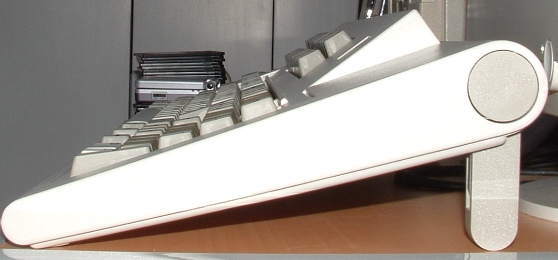

The risers on these are good fun, on the high setting the top is about 12cm off the desk:

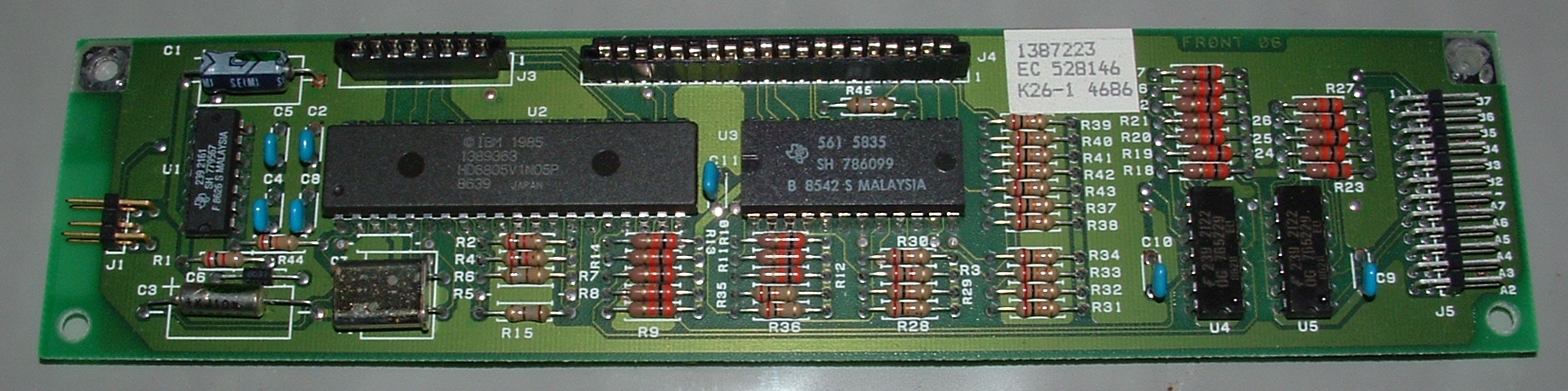

Anyway, I don't know 8051 assembly, and I'm not sure about the protocols, but I will have to have a look at the scan code matrices to see if there are similarities between the 3270PC and the 3197 etc.  Maybe even the 3180...

So, you've been reading comp.sys.ibm.ps2.hardware. I go there once a week but I don't have a good working ps/2 right now so I can't follow on-going topics there.  I'd like to reconfigure my macho 9595s and fire'em up, and set up TokenRing LAN someday.
With the blue text on the keycaps for PC commands, that's the keyboard for the IBM 5271 3270 PC, isn't it? .....
I really don't know what the keyboard is. I'm not familiar with terminals such as 3270, 5250 and so on.
Mine has an AT DIN-ish plug but not the one shown in the pic of ISA control card.  Lowpoly once explained kbkbale org, but.... it's hard for me to understand.  It seems to be a looooong road until I can have letters on my screen with the gigantic board.
Thanks for your info about IBM terminals.

I also cannot find the list of terminal types and keyboard P/Ns, but I have a good idea where it should be.  I will continue looking tomorrow [maybe... twelve hours from now?].
Anyway, I thought to look at IBM Announcement Letters at http://www.ibm.com/news/usalet/ for 6110344.
It seems to appear first on March 22, 1984, as the standard keyboard for the IBM 3270 Personal Computer, type 5271 in letter ZG84-0253.  Letter 184-136 from October 25, 1984 shows that it cost $295 US if ordered separately.  It was withdrawn on August 16, 1994 in letter 194-263 where it was called "Standard 3270 Converged Keyboard".  This was still a few years before Unicomp, so I don't think they would know about these (or Model F in general).
There is a very strange document in the hardware/software descriptions section from 2001 which might a template...  I don't understand.  But it has information about machine type 5373, which is an advanced version of the 5271, including a list of language variants and part numbers for the keyboard!  (This is great because often they just list Feature Codes for ordering with the original machine, and these aren't usually printed on the part...)

The intruiging thing is, electronically Model M keyboards for terminals are not necessarily that different to their AT and PS/2 counterparts.  Here is a look at IBM keyboard part number 1390876 for the 3192 terminal, which the communication method it uses is straightforwardly explained by Peregrine, except that the page is originally in Japanese.  I will try to summarise the main points.
  • The plug is different from AT and PS/2 plugs, but the pinout shows that it has exactly the same pins with exactly the same uses as an AT or PS/2 keyboard.
  • The data transmission protocol appears to be exactly the same as the AT and PS/2 keyboard's.
  • However, it uses scan code set 3.  [Scan codes, so called because the keyboard is constantly scanning for keypresses, are the data sent by the keyboard to make your finger movements come true on the screen!  Sets of scan codes provide standardised defintions for how keyboards should interact.]  Now set 3 is a bit of a pain.  It was used with IBM PS/2 computers and so is supported by PS/2 101/102 key IBM Model Ms of that time, but it did not catch on in the wider PC industry, and so today scan code set 2 remains the industry standard somewhat.  I've read anecdotally that there is however scattered support for set 3 in modern devices, but it is a bad idea to rely on it being there.
There are also the issues of the "wrong" keyboard ID being reported and required in response, and the lack of LEDs, but that seems to be about it.  Remapping to personal requirements can be done in software, and keycaps can be replaced or their legends ignored.
In theory then, all that would need to be changed to "make it work on a PC" is to change the connector and a firmware patch.  That's all.
In practice, because the source is not available for the firmware, you can't do that.  Translating the protocols is a good alternative, because you don't have to worry about internal variations in the same type of keyboard, you don't even need to modify anything in a keyboard at all, and the resultant translator could then be used for any keyboard using the same protocols.

You should be able to swap controllers, assuming that the terminal space saver uses the same controller as the full size one.
In this case, I don't think this is possible because the 1397003 is a Model M and the 1387033 is a Model F, which presumably has the controller attached to the same PCB as the key contacts, and even you work around that the contact system is different, and the matrix could be a problem [matrix differences could be a problem for any controller swap...].  On top of that, Unicomp probably couldn't help, alas...  "Cracking" or finding out the protocol and scan codes would probably be more straightforward.

Has anyone ever peeled up the keys on one of these?  Can you swap out the ISO enter, backslash, and left shift with ANSI-layout ones from a spare M?  That's half the reason I don't consider one.
And what of the editing block?  The labels don't correspond with the standard layout.

Quote from: Hak Foo;27752
Probably, if you drill all the rivets out and swap a few springs' locations.

I've wondered before if Unicomp could either provide a replacement controller PCB or just offer a conversion service, though I've never asked myself.
With certain PCBs the ROM route might be a good one as there seems to be a degree of similarity between Enhanced and 122 PCBs, however there are potential issues with both the matrix and the LEDs, never mind de/resoldering the ROM.
A suitable controller chip, or even a home-made one, has no reason not to work, but is obviously going to take a lot of it.
Using a controller out of a typical consumer keyboard is likely to be problematic as the matrix is highly likely to be different, and even if able to deal with all the keys would probably still not be easily reprogrammed.
I've spoken to Alexander Kurz about the many-IBM-Model-M-terminal-keyboard adapter, from what I understand I'm pretty sure that your P/N 1390702s would work with it.  AFAIK however there is just his own prototype that's ready to go...

I opened up one of my 0702 keyboards and took a look at the controller board.
It follows the 3151 terminal schematic posted on keyboard babel quite closely, comprising only a hex inverter, a 4 to 16 line MUX and a 6805 CPU.
8 rows, and *20* columns instead of the usual 16...so I guess the extra 4 column lines are used to handle the extra keys...I initially thought the additional keys were from the unused matrix combos in the standard 8x16 matrix.
So, in theory...a reprogrammed 6805 to take into account the scancode set...the PS/2 interfacing...and the three locks LEDs (there are enough spare I/O lines )....should be workable on many terminal-type keyboards.
But...having the right programming equipment and a code dump from a host-connect board to work with...and the programming skills to tweak the code to work...  that's the problem....my knowledge is such that I could not even begin to start...but I do see that is is possible...and potentially very flexible.
And as was mentioned, if someone such as Unicomp were to make a drop-in replacement controller...a lot of these 122 type boards would become usable...but then, I guess the emphasis is on new sales of new keyboards..  :-)
Glad I got my two keyboards really cheap...it may take awhile to make them functional...but still an interesting learning experience...and I haven't finished with them yet.
If anyone would like to see a pic or two of the controller board...say so and I'll post them.
Spec/57

Quote from: Specter_57
This is almost exactly my position too, except I do have a 'board, but not the ability to safely remove the microcontroller...
I seem to recall that Unicomp advertised a 'board refurbishment service before, so there may be a chance that they'd convert keyboards, providing that current controller production is suitable for use with older 'boards.  Convincing them to sell controllers alone might be more difficult.  I think I will get in contact and see how far I get.
I would be interested to see your 1390702 PCB, Mr kbdbabel might well be too.  Here's a PCB from a 1389260, which has two hex buffers [U4 and U5, an inverter [U1], MUX [U3] and the microcontroller [U2].  Twenty columns, just like your '702.  J1 is for the cable; J5 seems to be unused - I'm not sure of its purpose.  As is probably mentioned above, the 3270PC 'boards had DIP switches, which may be what they're for, but I am still not sure of purpose; the one person who I think may have docs on this is not responding to my e-mails.
If there is anyone reading this who has both interest and the skills and equipment we seem to be lacking, it would be nice to hear from you :)

Offline Specter_57
  • Posts: 143
More stuff
« Reply #39 on: Mon, 20 April 2009, 00:31:27 »
dw_junon...
Having Unicomp do a board along the lines we're talking about would likely be a bit pricy (I'm a cheapskate....)...and the volume would likely not justify the effort, from their point of view, so I'm guessing.
The keyboard bauble seems feasible...only a single AT89c2051 device (saw one on DigiKey for about $2.50 Cdn...) and a very few other components needed...I actually have most of the stuff in my junk parts box...and found a very simple DIY programmer and loader for it online (DOS mode, through the parallel port..no problem...).
Here it is  ..check this link out:  http://www.geocities.com/dinceraydin/8051/index.html
As to the removing your microcontroller on the PC board...a trick I picked up years ago....
Piggyback your new device physically on top of the old one..solder all pins together except for the Vcc and Gnd....these ones you cut as close to the board from the old device as you can, connect wires to the board at these  board connect points, and wires to the new device at the Vcc and Gnd pins..likewise to the old device.... and then connect to both devices through an of A-B type switch to the Vcc and Gnd wires you soldered onto the board, respectively.  Choose your device...  :-)  the old one or the new.....
My board opens up with the remaoval of only 5 screws on the back of the unit, and the top cover sort of hinges forward at the bottom and comes off...and the keyboard assembly then just lifts out of the base....no mechanical disturbance of any kind to the electronics..the PCB is mounted onto the metal back-plate, against the plastic base plate..so assuming your 1397003 opens the same way and you're not concerned about opening it...if it isn't too much trouble to ask you...could I see a photograph of it's controller board?
And since you ask...here is a pic of my controller board...it looks, essentially, to be the same as the one you posted, less the stuff on the right hand side.
Spec/57
« Last Edit: Fri, 08 May 2009, 00:06:56 by Specter_57 »
Offline dw_junon
  • Posts: 96
    • http://www.9999hp.net/
Hello, can anyone recommend a keyboard with extra function keys?
« Reply #40 on: Tue, 21 April 2009, 10:07:08 »
I wasn't trying to suggest Unicomp develop a new product, I was hoping that it might simply be a case of swapping controllers, which would be easy enough to do one's self anyway...  D-EJ915 is getting a Unicomp 122 emulator 'board, if he's prepared to open it we might be able to establish whether a swap would be possible.
Thanks a lot for that link to the simpler programmer, I will have to try that with my breadboard!
About the removing the controller, the main reason I was thinking of removing it was to dump the contents (in the case of my 1397003's), which I don't think piggybacking could necessarily get around... but I don't have any way of dumping any ROM at the moment anyway.
Yeah, the 1397003 has the later 122 housing, and 3 screws and "hinge" clips.   Similar opening to the older 122 housing, yeah.  I'd open it now and take pics, but I've lost my 5.5mm nutdriver (under keyboards, probably...)
Thanks for the pics.  Interesting that the extra components are simply omitted.
