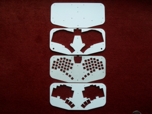

4 layers: 3mm acrylic base, 10mm acrylic spacer, 1.5mm steel plate, 10mm acrylic top.

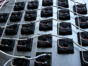

54871-1
Wiring detail. Diodes put on the columns because they're straight and the rows aren't. Switches are angled at 90 degrees to their normal orientation to make the pins in a better position for routing the row wires and diodes.

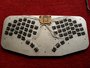

Wiring overview.

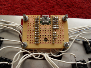

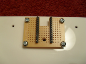

54875-3
Stripboard design, to mount Teensy 2.0 board inverted. Hole cut to allow space for mini USB connector and another hole cut for the reset button, for re-programming it.

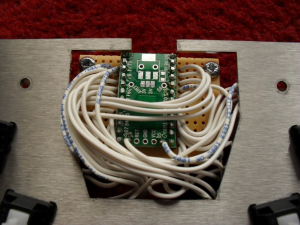

54877-4
Wiring detail of board connections. Messy soldering on top-right - my tip was near the end of its poor life :(
54879-5
Wire routing could have been better, but it fits - just.

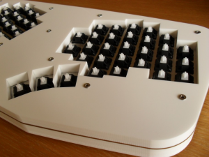

54881-6
I went for Clear switches.

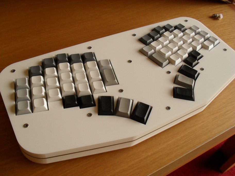

The end result. I named it Bison because I think the hand clusers look like the shape of a Bison :)
Apart from a couple of bug fixes in my firmware (right hand not working -> change uint_8 to uint_16 - if only all bugs would be this easy) it went smoothly, which was a bit unexpected!
I have a key layout I'm fairly happy with, but I'm a bit rubbish on it at the moment - 3 keys is something my thumbs need a little time to get used to!
DXF files if anyone's interesting in them:
* KB023 layer1 3mm acrylic.DXF (36.97 kB - downloaded 458 times.)
* KB023 layer2 10mm acrylic.DXF (38.89 kB - downloaded 455 times.)
* KB023 layer3 1.5mm steel.DXF (58.7 kB - downloaded 464 times.)
* KB023 layer4 10mm acrylic.DXF (40.6 kB - downloaded 459 times.)

Offline peterstock
  • Posts: 25
Re: Bison keyboard build
« Reply #29 on: Mon, 03 March 2014, 14:55:26 »
Cost: lots. Stuff seems to cost about the same number in £ as $, even though it shouldn't. I didn't do my own laser cutting, so I have no idea of the time. I think it's about 400mm wide - the CAD files are up at the top if you want a look. Weight is heavy, but that's an indication of quality, right? :)

Offline peterstock
  • Posts: 25
« Reply #31 on: Sat, 05 September 2015, 15:58:34 »
It's working fine and I'm a pretty happy bunny. One day a key didn't work -  I opened it up and just had to re-melt a dry joint. Apart from that no problems!
If I was to design a new keyboard, I'd probably have a little more angle between the hands. And I'd like to either make the hands tented, or the thumb clusters angled in relation to the main finger keys (like Oobly's keyboard), or both.
If you want something similar, you should take a look at Jesse's Keyboard.IO project:
http://www.keyboard.io/
Good luck in the pursuit of your ergonomic dreams! :-)
