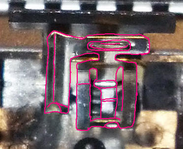

Removed the bigass enter key, but forgot to make note of the stabilizer post orientation. These are usually a piece of cake.
Keyboard is an Antec KF-91R with type 2 simplified clicky ALPS
59557-0

It looks like there is only one way these can be oriented. Seating the wires could be a good trick, I have never had any like that.

Biaxial enter key stabilisers are fun!
This is the only one I had, and it was even more complicated:
http://deskthority.net/wiki/File:Zenith_Supersport_SX_--_Enter_key_stabiliser.jpg
That was a pain to get back together again!
I guess in your case, just pull the shift key and note the orientation, and then put the posts back into the enter the same way WRT the wires.

fixed. duh.

I was wondering why that wire was facing the wrong way …
I can see now that they're not Alps switches anyway. The idea of Alps using that stabiliser layout seemed odd to me, as they tended to use a guide post for the enter key.
