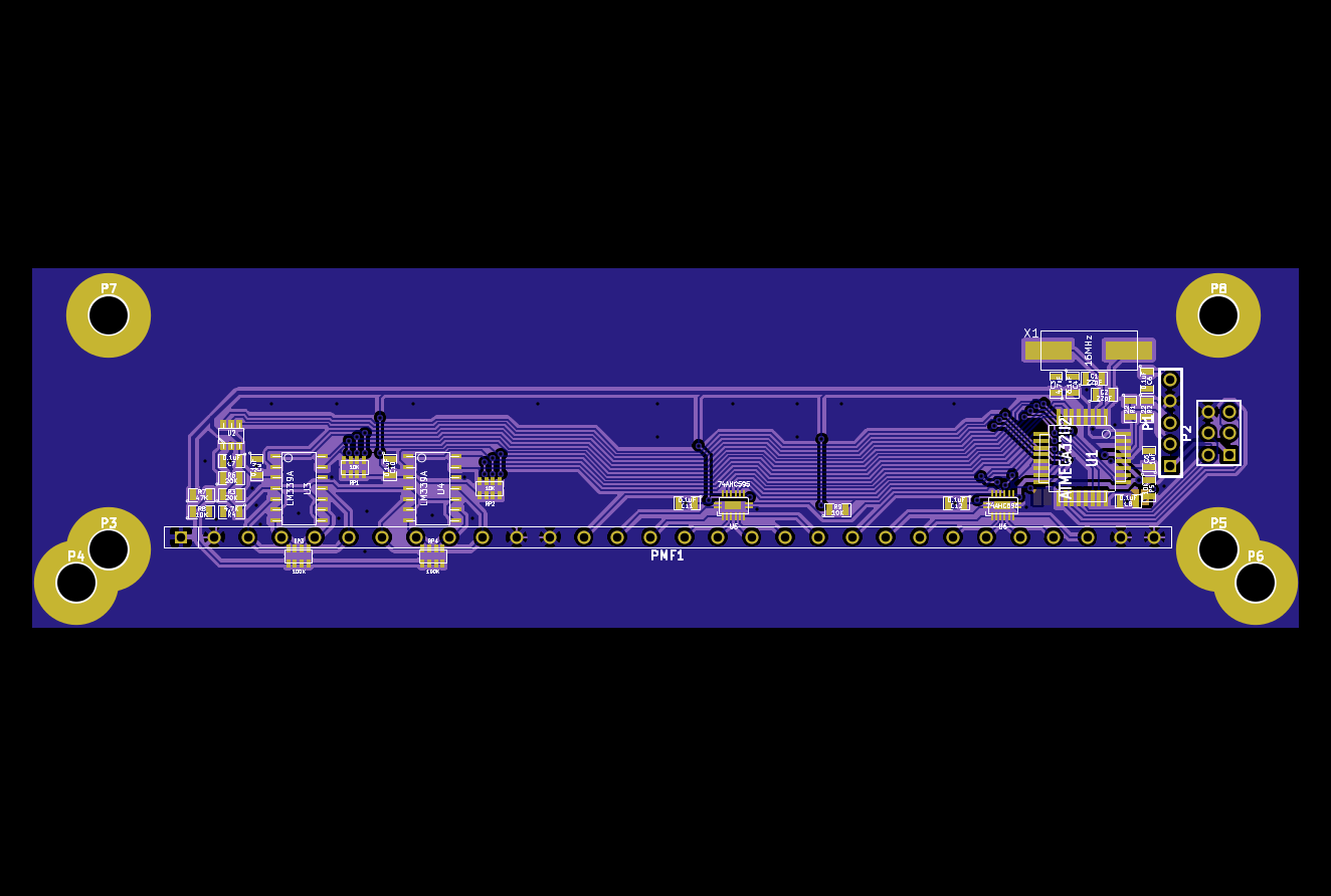

Now that I have my beamsprings humming along happily on USB, I wish to adapt my USB capacitive keyboard controller to my two Model Fs (a nice PC-AT and a battered but delightfully pingy 122-key terminal).
I've put together the layout pretty quickly:
61032-0
However now I have a decision to make. You'll see that the actual guts of the controller take up a relatively small area in the centre. However in adding mounting holes I now have a lot of wasted space.
The four holes at the bottom (P3..6) are mounting holes for what I'll call the `standard' Model F controller (what's in my PC-AT and 122-key terminal). No big deal.
The two holes at the top are in (what I believe are) appropriate positions for the slightly shrunk Kishsaver controller.
In combining the two mounting holes we now have a lot of wasted space, and the PCB now costs twice as much from OSHPark compared with the beamspring controller. Overall size is still smaller than the original at 149.5mm x 42.5mm, but the extra board space on the bottom might pose an issue for Kishsavers.
Either I can make these extra mounting bits `snap-off' (and live with the extra PCB manufacturing cost), or simply have two separate board designs with appropriate mounting holes for each.
What does GH think? Can we forgo the mounting holes entirely and use some nice spongy double-sided tape-foam?
Also, so far I've made the assumption that there are only two types of detachable Model F controllers (not counting XTs or Bigfoots which have controllers integrated into the keyboard PCB itself). Is anybody aware of any other designs that I should take into account?

OK based on that resounding feedback I have dropped the mounting holes so I can shrink the board substantially. I have added a few more mounting holes—at least one of them will need to be connected to the chassis somehow, perhaps by a bit of cable as I've done with the Beamsprings.
If the board won't sit nicely in place based on just the ribbon cable and possibly some foam tape, I can always make up some brackets out of steel to adapt it.

« Reply #21 on: Mon, 05 May 2014, 20:02:11 »
I had a play around over lunch and swapping the 47K/10K resistor divider for key-drain for a 4.7K/1.0K divider, I can boost the scanrate up to 550Hz or so. I might leave it at that; there's no point in going too much higher, as you then start having to increase your number of debouncing scans to compensate. I expect there's a probably a hard cap on both Beamsprings and Model Fs of around 2–3ms per key (so 333–500Hz) for mechanical reasons (yes, capacitive keyboards still need debouncing, there's just less bounce). In any case, after adding NKRO and layers and all the other crap my original 1KHz scanrate on the beamsprings dropped down to around 600Hz; most of the gains could probably come from optimising the rest of the code a bit better, rather than playing with the scanning.
Sorted out the autocalibration as well. Really confused myself with active-low and active-high terminology; the LM339 has open-collector N-channel outputs, so the row inputs to the µC are the opposite of what the keyboard is (Model F→active high, Beamspring→active low) ... d'oh!
Getting used to typing on the Model F, it's nice having so many F-keys and a proper numpad, but still miss the sound and feel of the 3727 Beamspring with the solenoid firing >.<
All right, fresh boards. One for my PC-AT, one to go in the post to Murium for Kishsaver testing. All gone!
63752-0
Analogue (row sense) end:
63754-1
µC end:
63756-2
