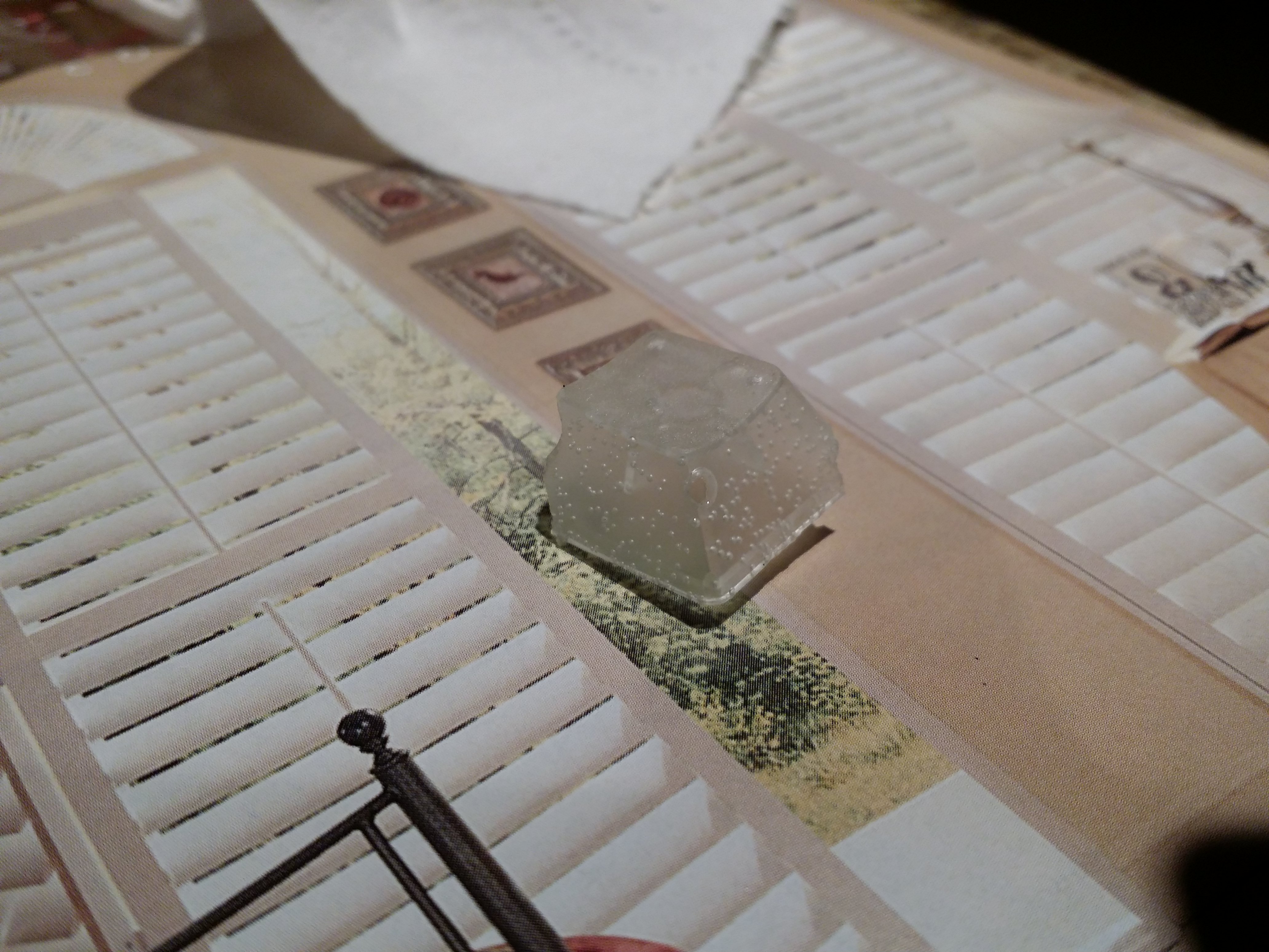

After wanting to create my own custom keycap for a long time, I finally decided to give it a shot beginning of this week and this is what I got so far.
Since I used translucent casting material, you will notice bunch of tiny air bubbles
69389-0

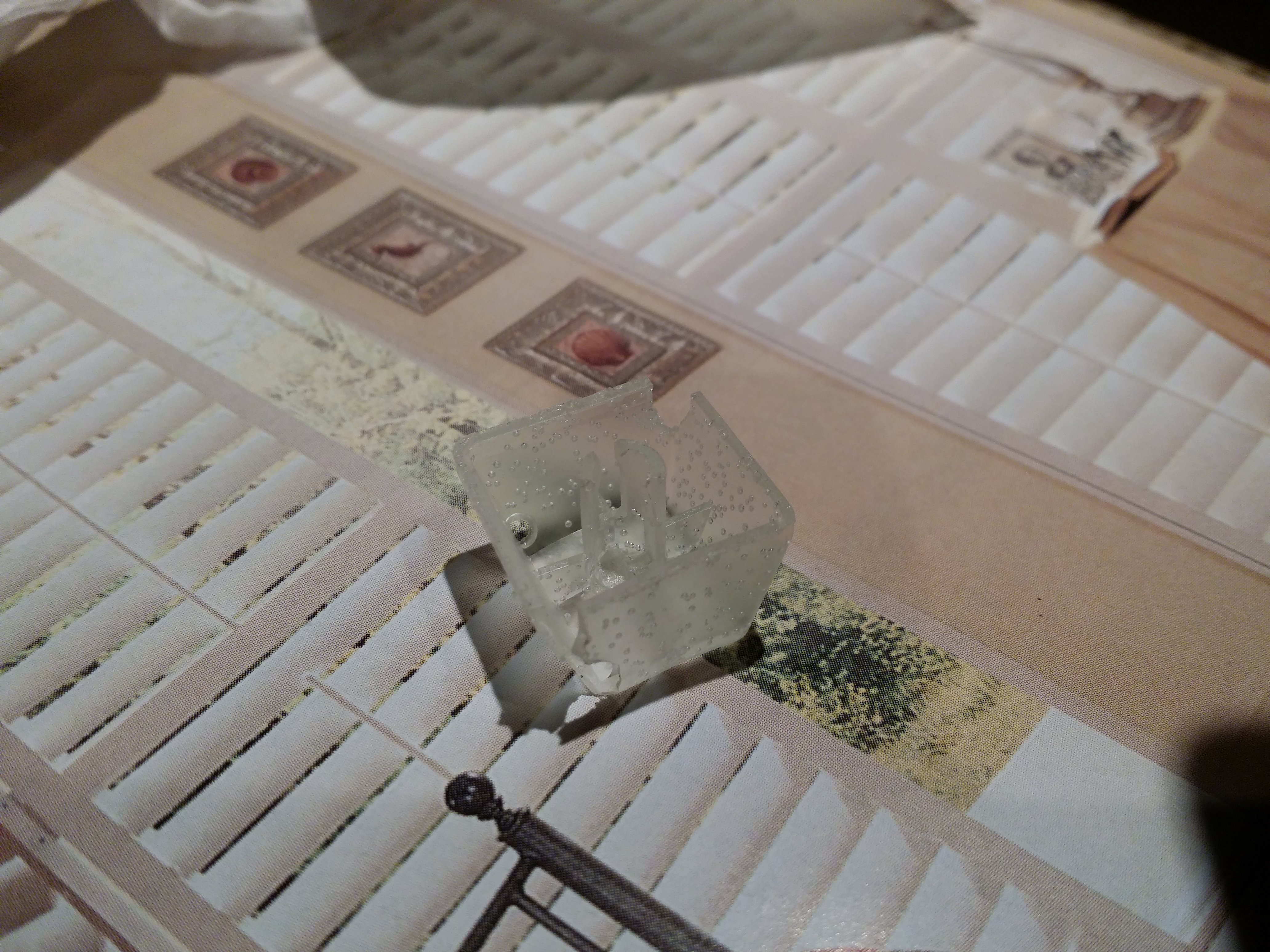

Also im in the process of making a new mold since location of my spruce was very poor (you can see the cut in this picture)
69387-1

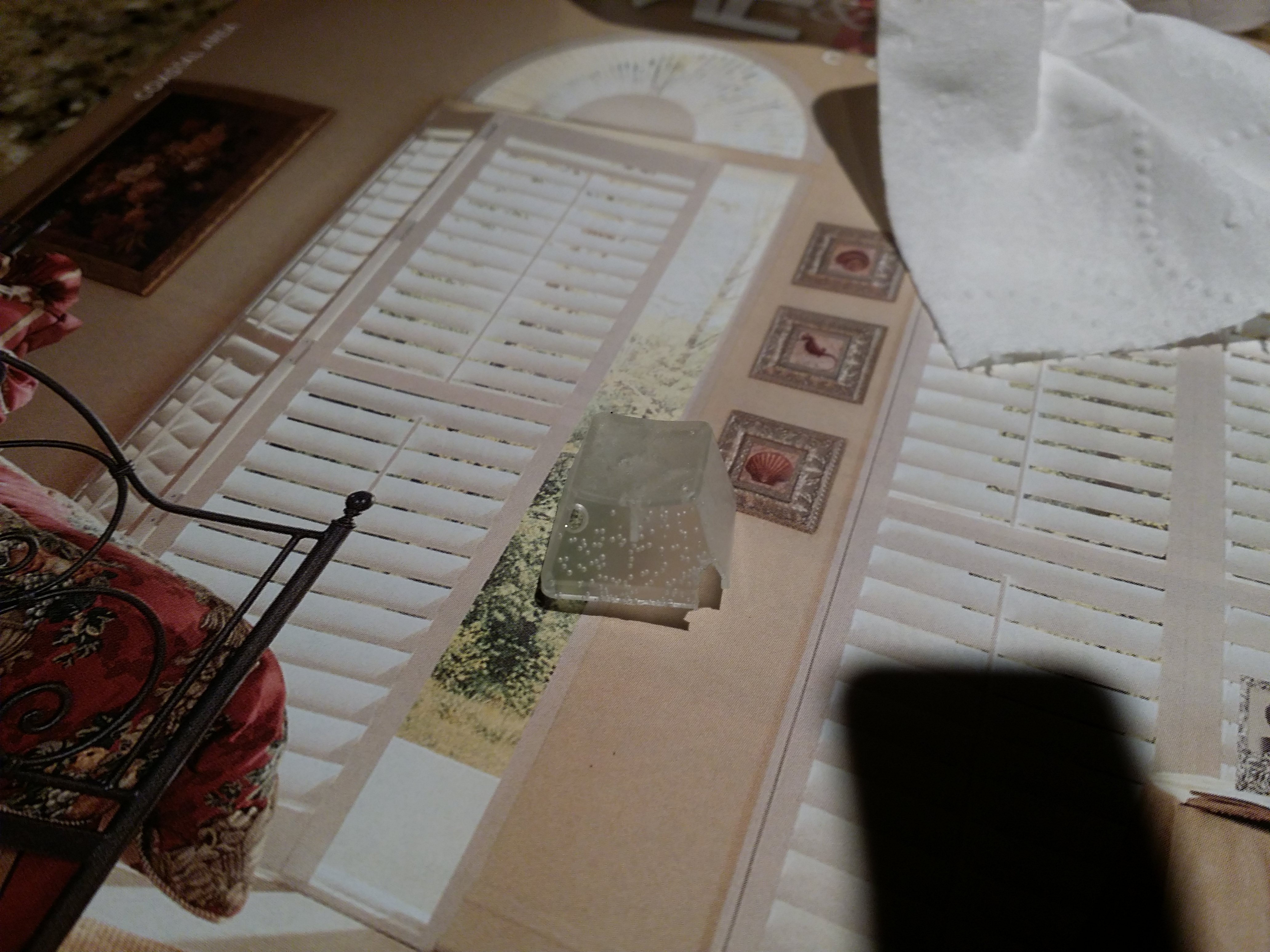

Finally bottom didn't come out right either (another reason why im making a new mold)
69391-2
