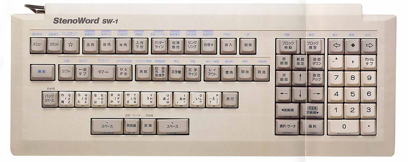

These photos show that the distance between key tops is larger for the MacIvory. This may lead to fewer typing mistakes on the MacIvory. My conjecture: The larger distance between rows makes it easier to avoid accidentally pressing neighboring keys, leading to fewer typing mistakes, and less repetitive strain.
To be fair though, the profile he likes so much is sculptured, basically like DSS, and I’m sure that helps quite a bit.
interisting large spacing to avoid accidentally pressing neighboring keys
i've seen women typing in youtube 300wpm with steno like this
« Last Edit: Fri, 07 November 2014, 11:07:23 by yasuo »
