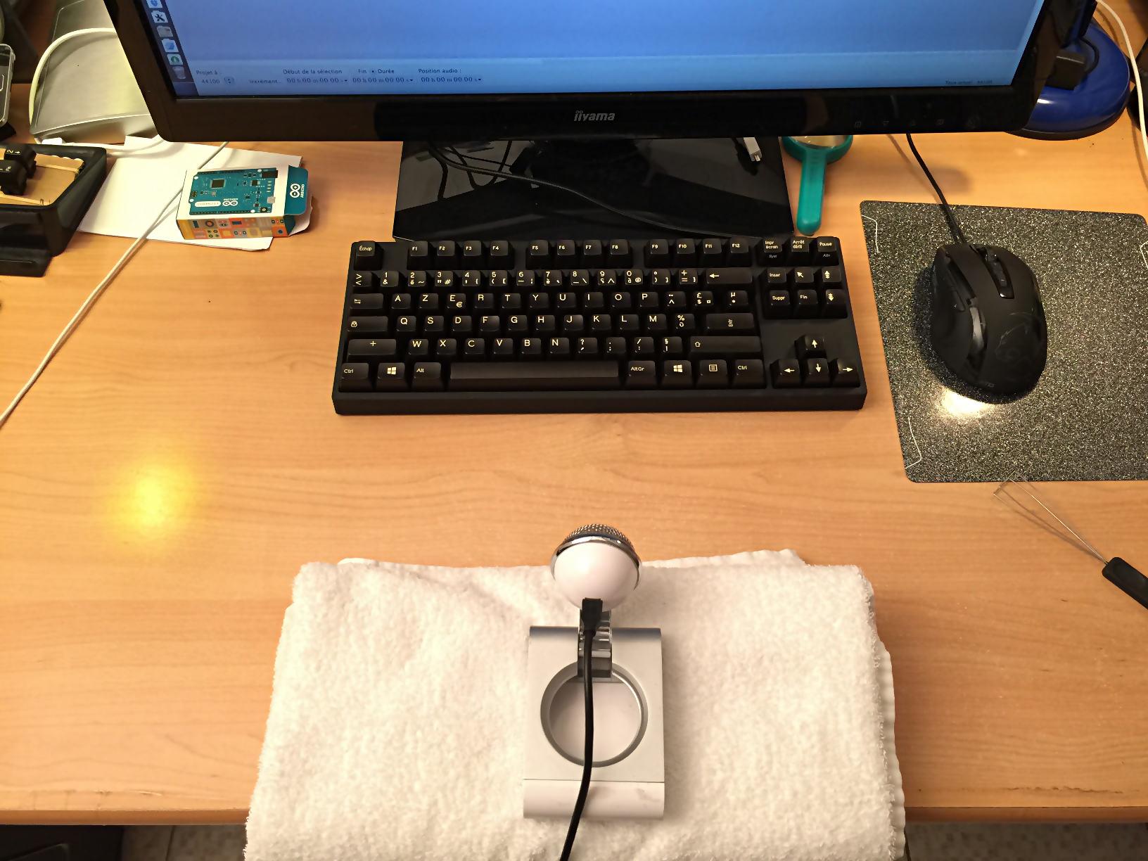

Here is the recording setup. The idea was to let you hear how it sounds when YOU type on it:
82202-0
    Please note that the keycaps pictured are not the standard ones.
    The standard Novatouch keycaps have been used for the two recordings above.
    The towel insulates the mic from picking the sounds coming from the desk
    (you don't type with your ear on the table)
I am going to replace this post with the full method, at a later time.
