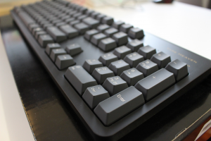

Setting the keyboards in place.
88692-0 88694-1 88696-2

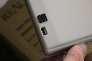

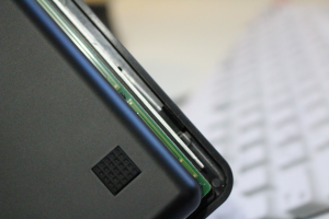

Topre's case is actually really easy to open, pop the tabs from the bottom of keyboard first then to do the tabs at top then it will open with no screws.
88698-3 88700-4

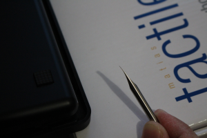

That being said Type Heaven's case is such a pain to open, the bottom screws are easy to remove, but the tabs at the other side is really tight and hard to get into.
88702-5 88704-6 88706-7
I even bent my fiance's nail thing (to pry into the gap) I hope she won't kill me.  >_____>
