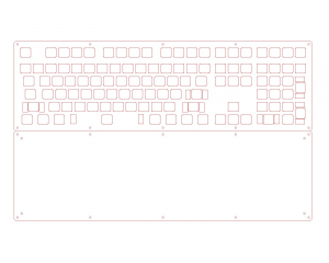

I'm curious to hear the general experiences with price of one-off laser or watercutting your plate designs.
The only company here (Norway) I've managed to get a quote from so far offered to do the job at about 250US$ for my full size layout (same cost for Alu and 304 stainless steel). Thus I wondered if it would be more reasonable to have it done abroad. My design however used rather complex cutouts and I've since been working on simplifying the cutouts to reduce cost.

The cutout i submitted for a quote was this: 91283-0

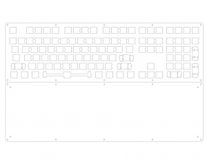

I am thinking of simplifying it to something like this: 91285-1 to reduce costs as I am using PCB-mounted cherries for my design.
Technically I could use no plate at all with the pcb mount, but if I can find a way I would prefer having my cherries mounted on the plate and not depending on the pcb for stability

Thanks for the tips :-) I'll have a look at the big blue saw - a quick online quote gave me a price of about 100$ for the reduced complexity plate which is already a big improvement.
(I was hoping i could manage to get a plate done for somewhere around this price; ideally here due to shipping and tax - but I have ways of getting things shipped over from the states if necessary)
Nevermind - BBS it seems to have misinterpreted my layout, so that quote might not be accurate
