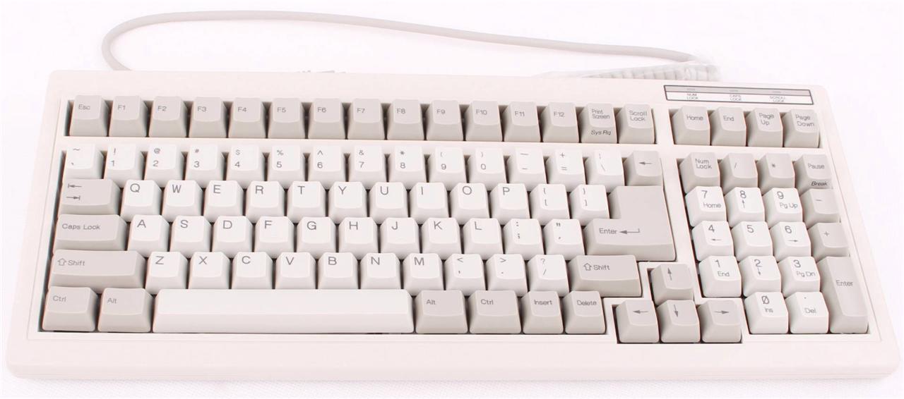

Grazed, now that you've had the keyboard for short while, what do you think of it?
I should have done that earlier I suppose, I've been busy the last few days. Sorry guys!
The Feel:
Pros:
Typing on it is great, IMO (I'm sort of directly comparing this to blue switches in a CM Storm). The keys aren't as stiff as I thought they would be, and they seem to actuate earlier (seems like 2/5th~ the way down?). The sound is definitely more satisfying than blues, there's a LOT more bass to the clicky clacky. The downside I suppose to that is that the thing is much louder. It can easily be heard a room over if you're a heavy handed typist.
Gaming on it also feels good. The keys have enough resistance to them that you don't accidentally register WASD presses by resting your fingers on the keys, and the travel time to actuate is low enough that twitch reflexes are executed plenty fast enough, at least for me.
Mixed Bag:
Stabilizers. They're FANTASTIC on the space bar and the other large keys (you can use the absolute edge of the space bar and have it feel like you're pressing down in the middle), except for one key, the enter key. I don't know if it's because of the shape or the way they placed the switch, but it feels a bit off compared to the rest of the board. It's not stiff, it's not necessarily bad, it just feels different! The feedback when the switch goes off feels to be muffled, and it bottoms out a bit easier than the other keys.
Build Quality:
The Good:
The build quality is good. It's heavy, feels like a good 3 pounds, there's definitely a sizable metal plate in there. The plastic used for the frame is thick, feels like it's made out of the same stuff that the SNES was, if any of you owned that in your childhood. That said, if you pick it up and twist, it still has some flex to it. It doesn't detract from how sturdy it feels, you definitely get the impression that this board can take a beating.
Mixed Bag:
Key consistency was a little weird for a few keys. Some weren't as "crunchy" as others, probably from aging. They all felt the same though, and you wouldn't be able to tell if you had headphones on or something, it was strictly an audible difference, not a tactile one.
This can apparently be fixed in all of 2 minutes by popping off the cap and then popping off the top of the switch and adjusting the spring:
Whether or not I'm going to do it for all of 3 keys, I don't know. All of the keys seem to be normalizing after some use anyway, so it's becoming harder and harder to tell the difference.
Conclusion:
I'm very happy with it, probably the best $20 I have ever spent on a computer peripheral. I adore the ALPS feel compared to Cherry for some reason, it just make typing a bit more enjoyable, and prevents heavy handed mistakes in gaming, for me.
I wish I would have purchased more of them!

got mine today.  it's pretty neat, but the 1.25u alt key where the windows key normally is bugs me.  keep hitting space when i mean to hit alt.  1.5u ctrl and alt would be much preferred.  i like the low pitch thunk the keys give off.
the caps definitely aren't doubleshot but i'm not entirely sure what they are.  i can feel the legends on them.  material feels like ABS to me but i'm hardly an expert.
Is the lettering raised or the opposite?
Offline nightdriver
  • Posts: 274
  • Location: pale blue dot
  • life is like t. rex
Re: Found new in box Unitek K258 boards for $20
« Reply #62 on: Fri, 03 April 2015, 02:00:17 »
feels very slightly raised.
Offline chyros
  • a.k.a. Thomas
  • Posts: 3515
  • Hello and welcome.
« Reply #63 on: Fri, 03 April 2015, 02:24:39 »
Probably dyesubbed. One of my old boards also has raised dyesubbed lettering.

I just got mine in the mail this morning!
96210-0
The keys really do feel like slightly stiffer MX blues with a lower-tone click. I really like this layout, as well. It's very similar to a Cherry 1800 layout. I might try this on my desk for a while instead of my full-size Ducky Shine III, just because two full-size boards on my desk at once can make things seem pretty cramped.
I do notice a bit more wobble in the keys compared to my MX boards, although I'm not sure whether that's the Alps switches or the caps causing it. It's nothing major but it is noticeable.
Speaking of keycaps, these seem to be ABS, a bit on the thin side, but not the thinnest I've seen.
96218-1
The legends appear to be laser-etched and filled. Here are some pseudo-macro shots I made with a machinist's loupe and my Moto X camera:
96212-2 96214-3 96216-4
The ISO layout is funky, as ISO layouts are. although I have to say I prefer the smaller backspace to make room for the slash rather than the smaller left shift on some layouts. Maybe that's because I use backspace less often. I guess I make fewer mistakes than I make capital letters.
All in all, not a bad way to spend $26.
Don't worry, it's not the caps; that's normal for Alps switches :) . Compared to Cherries, they definitely wobble more.
They're definitely lasered, but unless it's an optical illusion, they don't look filled-in to me Oo . They look just like AT101W caps, in fact.
So the color is just the burn from the laser. Makes sense.

I immediately noticed that it wasn't white, as the overexposed eBay photo:
...had made it seem. Rather, it's IBM beige/brown. So it looks more like a baby Model M, which is okay with me. It was just a bit surprising—at first I thought they'd sent me the wrong board.
