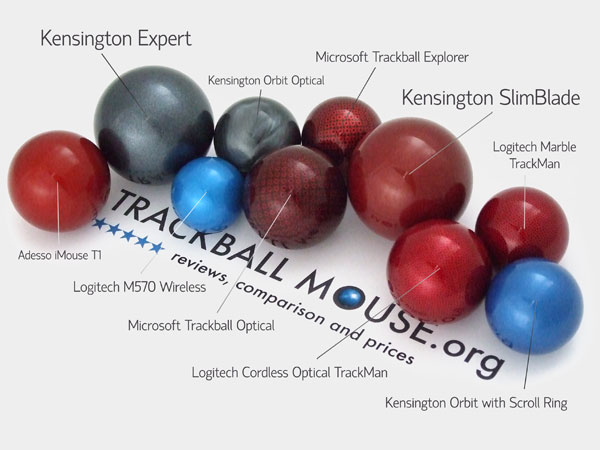

so now I have a trackball on overnight. I chose the Kensington Orbital because it's smallish:
so it will actually fit well in one of the thumb clusters, and because it was one of few that someone had a teardown picture of:
which doesn't look nearly as bad as I assumed it would look (I thought it would be soldered to the board). It seems to have its own support system as opposed to the Logitech Trackman which is preferable, and I have plenty of wire and shrink tubing at home to extend those two sets of wires, and there is plenty of space underneath the keyboard to hide the PCB, especially on the right hand version, so I think this plan is a go.
