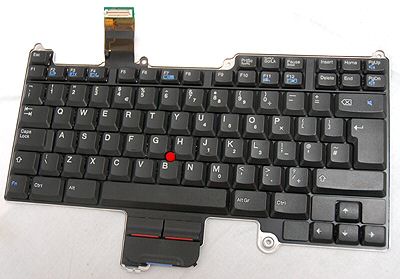

I've spent years with my Thinkpad 600E and I think it's a primo mini-layout:
Small footprint (same area as the main typing area on a Model M), all the normal keys plus a function key on the lower left. The only drawback I can see is that the F keys and GM keys are half-size and they might as well be full-size. Make this with BS keys and a nice, heavy backplane for weight and I'll buy one.
The Brat Prince of COBOL

« Reply #43 on: Sun, 20 September 2009, 09:33:31 »
Quote from: Shawn Stanford;119370
Ah. Now that I see what you're thinking of, I can work out a layout that meets your conditions... but with a few changes so as to make everyone happy (I'm just that kind of guy).
So the Enter key is changed to the U.S. form from the European form. I work the arrow keys in a bit differently, so that I don't have to shrink the spacebar as much (in fact, I wouldn't have to at all, except to work in the Windows keys).
And, I even manage to solve the "real" numpad versus staggered numpad problem - while leaving out the numpad, there are now suitable keys in the upper left of the keyboard to shift to a non-staggered numpad in Num Lock mode:
EDIT: Of course, there is one unconventional thing about this keyboard - the Windows Menu key is moved over to the left side. But one can't have everything.
EDIT: Come to think of it, there is still room for improvement. Either by making Alt and Ctrl single-width, or moving the Windows keys to the row below the keyboard (since the cursor keys have created this row anyways) the spacebar could be made wider. It doesn't have any serious problems, but it is a little short on the left side.
EDIT: Rather than worrying about the space bar, maybe just moving the Windows Shift keys to the inside of the Alt keys would be the right improvement. That way, the Alt keys stay where they belong - and, as a nice bonus, it's easier to map the keyboard to the Macintosh keyboard. But there are other alternatives as well. For example, one could have just one Windows Shift, where the Windows Menu is now, and move the Windows Menu key to the top of the keyboard, say to the right of the Num Lock key.

Generally, most laptop keyboards don't retain it - unless they use reduced-height keys, and that would not work with buckling springs.
EDIT: Further thought has brought another idea to mind. The big problem with shrinking the space bar is that it moves the Alt key to a spot less accessible to the little finger to shift with it. So if I shrink the space bar by one key's worth, and move the Alt key one place to the right (replacing the right Windows Shift), I could put the cursor left and cursor right keys between the spacebar and the right Alt key. This wouldn't be the same sort of cluster, but at least those keys would now be very near the cursor up and down keys, separated only by the Alt and Ctrl keys.
So the bottom row would be ctrl, win shift, alt, space bar, cursor left, cursor right, alt, ctrl, cursor down.
If a right Windows Shift key is needed, and placing it in the top row doesn't work... it could replace |\, and that key could be put in the top row. Of course, this is starting to require more extensive changes from the basic 101-key layout.

Personally I don't care about the angled number pad in the main typing area, having a non-staggered one at the top left would be sufficient if it has a ridged key where the number 5 will be.
On the other hand, I do care about having my Home/End keys within reach of the cursor.
However, recently I've become tired of moving my hands of the home row to move the cursor around. I've tried to stuff the cursor keys on the home row using the IJKL key cluster, with the extra editing key block on that area as well: U and O would be Home / End, Y and H would be Insert / Delete and P and ; a virtual Pg Up and Pg Down. Right now I do this with Autohotkey.
This could even solve the current problem with the broken cursor cluster...
The main problem I've encountered with this approach is that it depends on an easily accessible Fn key, preferably hit by your thumbs. I was thinking of some special key in the middle or beneath the space bar, although I do understand that it would be hard to make and might annoy people who like to put their thumbs to rest on the keyboard casing.
Maybe we could reuse a keyboard case with mouse buttons there to have an extra Fn and Shift key. :-)
Anyway, that's just my view about custom layouts.
Hmmm. It would be nice if Unicomp could be persuaded to put mouse buttons on all their keyboards. Even the non-trackpoint ones, where they would work as extra keys.
