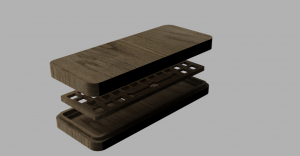

Here's the plan.
 1) build a 40%
 2) sell it
 3)???
 4)donate profits to GH
 :thumb:

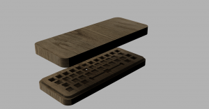

I will be donating time, switches, materials, and my CNC skills to the project. as well as anything else needed. what i'm looking for are keycaps, controllers, pcb, or help designing said pcb if not i'll hand wired it no big deal.
any and all help is most appreciated.
here's the design idea...
i'd like this to become somewhat of a community project but if i do it all myself thats fine too. i'm doing it either way so  :p .
123127-0123129-1
if anyone wants to contribute please let me know. the plan is that all profits go to GH. at this point the only things i will have to buy is the contoller *teensy2.0* but if anyone has switch suggestions or wants to donate something please let me know.
also the wood i have on hand is pine however oak would likely be better. suggestions?

I love the cover idea, that's fantastic.

thanks. it still needs some tweaking and refinement. the current design causes the keys to hit the top when closed and will not seal due to spacing issues. its a work in progress. making a PCB for the case would resolve many of them tho. i'm still learning KiCAD and FlatCAM so i can mill my own PCB.

This is really a neat idea. And I have a soft spot for wood cases. Have you considered trying something other than pine or oak? If you don't have access to other types of wood, but would like to try one let me know and I should be able to help out. I have access to all kinds of options.
 How do you plan on securing the case? Using some kind of straps, like Datamancer, or something else?
i can order what ever wood but if your willing to donate to the project that would be super awesome. as for securing the case i'm still considering options. but yes the idea was inspired by datamancer
Securing the case is tricky business, unless you are going to with straps. Having some made up would be pretty cheap, particularly if you know someone who can sew. Something like a Velcro strap would probably be easy enough, just pick some nice fabric to make it aesthetically pleasing.
For wood, I might have some stuff that I can provide, but I'm not sure if it would meet your needs. Thickness is a big factor, since, as I'm sure you know, the thicker it is the harder it is to find, and it gets exponentially more expensive. Most of the stuff I have on hand would be in the 3/4 area.  I really would not use pine though, unless you find a hard variety. While oak would be more durable, I can't say I'm a fan of the grain. It reminds me of something out of the 80s. But of course, that is completely my personal taste, so don't let that sway you.  :)
i come form a family or wood workers. i also have a CNC and can carve it out myself :3
worst case i can laminate pieces together but i'm going to try hard not to do that as it can break over time.
i need to talk to my father. he has some ruff cut mahogany thats about 20yrs old air dried. some 2" thick :D
thoughts on that hardwood?

Sorry for the comparison but it's essentially a vegan Datamancer 60% case? I'm down; I like that case, but leather? That can **** off. Don't want to support it so I can't buy it :-\
it would likely NOT be leather. i like the Velcro idea but like elastic even better. the straps dont have to be terribly binding just enough to hold the top portions together.
also if it comes out as nice i i'd like it to i could be persuaded to begin manufacturing them for sale. giving a portion back to GH on every sale.

Just a thought but what about using some sort of metal latches to secure the case closed as opposed to leather?  Provided that they are tight enough that there is no movement.
My top choice would probably be oak (or walnut if it was available).  Pine looks nice and is easy to work with but it is a softer wood and for a case I feel like it will get dented and scratched too easily.
Looking forward to seeing some prototypes of that wooden case and kudos for giving back to the community!
yeah ive considered a hinge and to be honest i'm kind of leaning towards it in a way. i feel it would make this very steam punk-ish not that i'm opposed to that ;)
i have a prototype i made awhile back of the 2 piece top/bottom with midplate. but it was made before i did some upgrades the the machine so its abit wonkie. its also doesn't fit properly when switches and caps are involved but thats what prototypes are for.

What do you think about some kind of mechanism that allows the top part to slide closed?
I'm not quite sure what is required for this (never worked with wood so I literally have no idea what I'm talking about) but I was just thinking of  grooves that run along the long edges of the top and bottom part of the cases so the lid can be slid on securely.
I know most sliding lids are simply a thin piece of wood that slide over a box like this:
Looking at your model, this may be hard to achieve but from a user standpoint would be a cool and convenient feature.
Could work but might interfere with use as the keys would be down in a box alittle. Space bar at least
Yeah that's what I thought. I wasn't sure if there was any other way to cut the wood to give the lid more space to hang over the keys but you'd probably end up with a pretty ugly fat lip on the bottom part.
All things are possible but I'm going for as compact as possible
I meant the Datamancer case has leather included :rolleyes:

Hype train renders in 3...2...1
123350-0123352-1123354-2
i'm considering using a clear acrylic plate in the inside to show off the JD40 PCB... thoughts?
this project is for YOU GeekHack. input is not only welcomed its required ;)
notice the top as wrist rest idea.

I love how it came to be that the top is angled and is now the wristrest. Y'all are clever.
@regack suggested that. i added it to the updated design prototype
