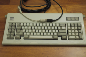

As of last weekend, I was able to get everything complete and I brought this with me to the NorCal mech keyboard meetup yesterday at WASD.  I took some pics along the way.  Not super extensive, but should be enough to give you an idea of where I started and where I ended up.
123482-0

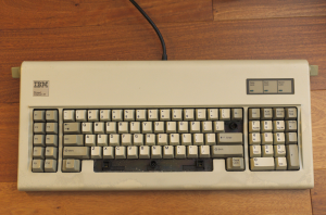

Poor quality cell phone pic before touching the keyboard
123484-1

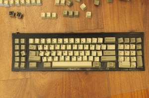

After cleaning the keys and casing, you can see the corrosion on the barrel plate.  I already replace the enter key with the ANSI enter.

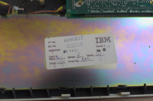

Internal label.  Anyone know how to read the date code?

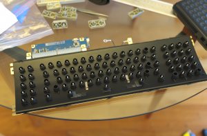

Dirty old foam and key barrels.  I have no idea how that much dirty got inside the keyboard!

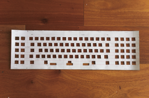

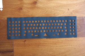

New foam with template after cutting.  I opted against buying a round die cutter and just used a sharp exacto knife.  Seemed to work quite well.

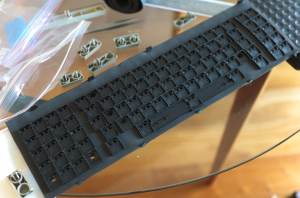

Trial placement of keys before installing barrels and flippers.  Needed to get the placement right!

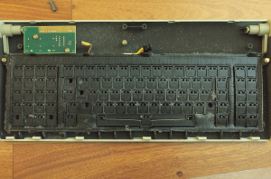

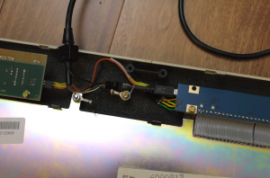

Internal shot showing the custom adapters for both the micro-USB and LED indicators.

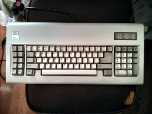

Finished project with inline passive adapters on the original cable.
Notice that I also replaced the numpad with Model M keys, since I liked the brown navigation legends and wanted the bump on 5.  I also replace the F and J keys with Model M keys so that i have home row bumps.
