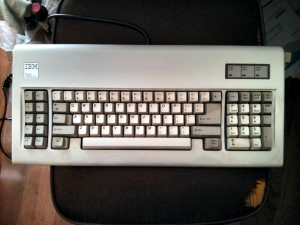

123482-0

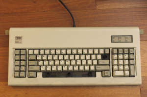

Poor quality cell phone pic before touching the keyboard

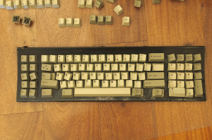

123484-1
After cleaning the keys and casing, you can see the corrosion on the barrel plate.  I already replace the enter key with the ANSI enter.

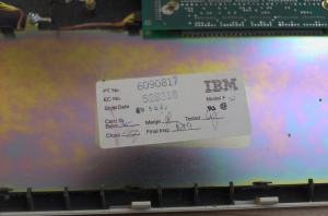

Internal label.  Anyone know how to read the date code?

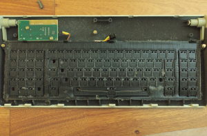

Dirty old foam and key barrels.  I have no idea how that much dirty got inside the keyboard!

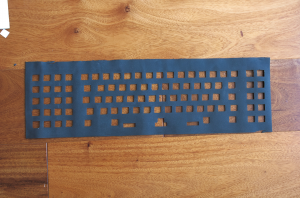

New foam with template after cutting.  I opted against buying a round die cutter and just used a sharp exacto knife.  Seemed to work quite well.

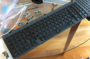

Trial placement of keys before installing barrels and flippers.  Needed to get the placement right!

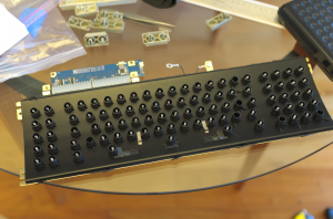

Barrels installed

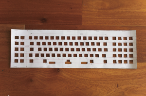

Other side with Model M spacebar stabilizers attached.  Just some scrap stainless steel glued using E6000.  Tried some epoxy first, but didn't hold as well, seemed to be too brittle.

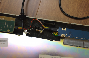

Internal shot showing the custom adapters for both the micro-USB and LED indicators.

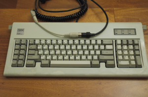

Finished project with inline passive adapters on the original cable.
Notice that I also replaced the numpad with Model M keys, since I liked the brown navigation legends and wanted the bump on 5.  I also replace the F and J keys with Model M keys so that i have home row bumps.
