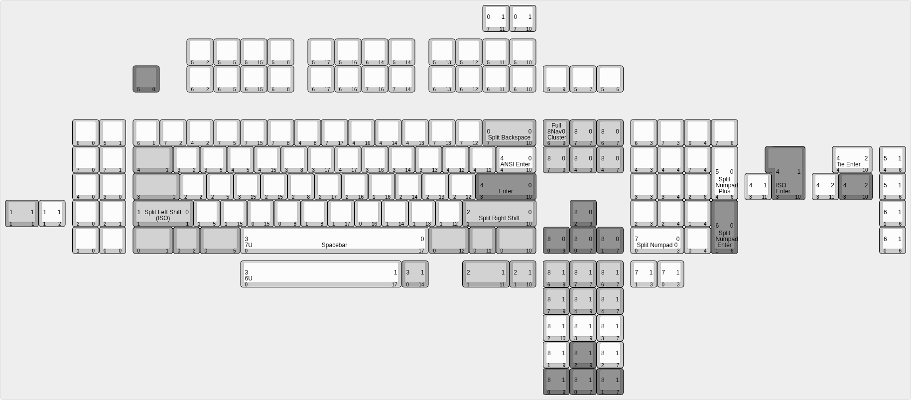

Below are my current updates to the manual for the Leyden Jar firmware, which includes a discussion of optimizing the firmware.  The firmware will have various options for folks who want some choices.  I note below the current plans for which firmware I will be flashing to each F122 during QC - a firmware designed with maximum compatibility and ease of use.  Despite being a max compatibility firmware, this firmware setting will have a scan rate that is three times faster than the xwhatsit.
Also below is a photo of one of the aforementioned keyboards that I have been testing and optimizing firmware with; it will be going to a user of the German layout (pardon the cell phone quality):
313331-0
Flashing Leyden Jar - can use Windows, Mac, and Linux (same instructions):
For keyboards with the Raspberry Pi RP2040-based Leyden Jar controller (F122, B104, B122, and others in the future)
Open the Leyden Jar diagnostic tool, which is in a folder inside the comprehensive QMK-layout-files.zip file linked above, click Refresh Device List, and click Enter Bootloader.  After clicking Enter Bootloader, an empty hard drive named "RPI-RP2" will appear in your computer's Explorer.  All you have to do is copy to this drive the .uf2 file inside one of the leyden_jar_firmware_package folders which can be found in the QMK-layout-files.zip file linked above.  There are several firmware variants with different numbers of calibration bins and activation offsets.
I recommend the one with 5 calibration bins and an activation offset of 7.  A higher number of calibration bins allows for a margin of safety around keys with different unpressed capacitance levels (for example, if there were only 1 bin then all keys would activate at the same value, but some keys may have an unpressed value close to or higher than the activation level, meaning a key would send a signal to the computer without being pressed.  I like to see the pressed value at least 3 higher than the DAC Threshold for that key's bin, and an unpressed value at least 3 less than the DAC Threshold for that key's bin (with capacitive PCBs, a pressed key may change the capacitance of other keys).
Calibration bins allow for different activation levels based on the initial unpressed level of each key when the keyboard is first plugged in.  More bins is safer but there is a performance penalty that is infinitesimally small, several thousandths of a second.  Rico notes that matrix scans are 3 times faster on the Leyden Jar compared to the xwhatsit controller (720us to scan 18 columns compared to xwhatsit's around 2ms since it is a 500hz polling rate). In other words, 5 bins would be 5 x 720us = about 3.5ms total scan time for 5 bins on the Leyden Jar compared to 5 x 2ms = 10ms for 5 bins on the xwhatsit. The xwhatsit Vial firmware uses 5 bins, so the RP2040 could even use 15 bins and still have approximately the same scan rate performance as the xwhatsit controller.
The default Leyden Jar firmware is expected to have 5 bins and an activation offset of 7 to be more foolproof, but premade firmware files with fewer bins and varying offsets are also available in the above zip file (for folks who want theoretically the best performance that they can never actually notice in real-world usage!).  Firmwares with 2 bins may be more likely to have issues with one or two keys sending a signal without being pressed, so I do not recommend them.  Be sure to close the Leyden Jar diagnostic tool before using Vial.rocks or the Vial software.

Where is the source for the latest model F firmware?  I found links to the binaries in the manual, but not the source.  Searching has turned up a few github repos, but most seem old and out of date.  Is the latest here? https://github.com/mymakercorner/vial-qmk
My understanding is all the boards can have the 7U spacebar replaced with a shorter one and an extra 1.25u key placed on right.  Is that correct?  Because some of the videos in the manual show the bottom row with only three holes in the plate to the right of the spacebar.  So I don't see how they could get an extra key unless drilling a hole for it is part of the mod.
The layouts in the github repo I linked above are inconsistent on the bottom row layout options, which also makes me doubt the spacebar change for an extra 1.25u key.
F62 has option for 1.5u key to the right.  Also a totally different layout with 4 keys on each side, which I understand used different PCBs and is no longer be available.
F77 has option for 1.5u key to the right.
F104 has totally different bottom row.  Only one layout with 6.25u spacebar, three 1.25u keys on the left and four 1.25u on the right.   Seems like this must just be totally wrong?
F122 has option for 1u key to the right.

I like your layouts - how did you make those graphics?
See the QMK-layout-files.zip file in the manual
For the xwhatsit controllers: https://www.newfxx-firmware.nconx.com/
For Leyden Jar:  https://github.com/mymakercorner/vial-qmk/tree/leyden_jar
Yes, the PCBs have various extra pads for the shorter spacebar, splitting all 2U and larger keys, and for the 5 additional keys above the cursor keys.

The layouts are from https://keyboard-layout-editor.com/
I used the vial layout data from the firmware source and this converter to translate it to KLE format, https://zykrah.me/from-via
My specific question about splitting was the spacebar.  The vial layouts do not match the text, "The spacebar can be split to add an additional 1.25U key to the right – just order the medium spacebar, extra barrel, flipper/spring, and the 1.25U key that you want."  But the layouts are 1.5u, or 1u for the F122, or no option to not split the spacebar on the F104.
It's contradictory.  Which should I believe?

The text is correct.  Maybe the firmware files were not specified accurately.  You can fit a 1.5U key but it would be very tight and you may have to trim part of the bottom of the keycap.  A 1.25U is the correct key but it leaves a 1mm extra gap.
As a note, for Leyden Jar firmware, the all pads main layout file ("leyden_jar_f122_vial" for example) is the only one that has all the pads; you can't use Vial to split or unsplit keys.  For the xwhatsit NathanA firmware, you can split the keys in Vial.
