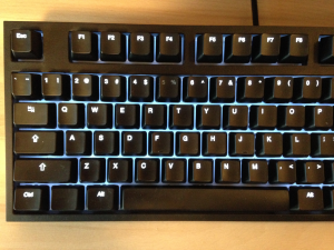

Hello all,
I've been (or was?) an happy WASD Code TKL user for the last few weeks when this happened:
139793-0
The LED being the 5 key is dead. And it just scratches my OCD sooooo much. I would RMA it, if I wasn't in Europe: the costs to send it back to the US are very, very expensive. I've already contacted Massdrop to see if there is another solution.
So my question is: has it already happened to you guys? Is there a DIY solution for solving this? I'm not a genius at electronics stuffs, but at least I can solder things.

Appears those are through the switch LEDs so you should be able to desoldering and replace fairly easily.  No idea on size/rating though.  If those were SMDs you'd be hosed and have to desoldering the whole board full of switches.

If you can already solder, and already have a soldering iron, you should be able to put in a 2x3x4 led in a couple minutes.

It may also be worth checking to see if the led is actually dead.  Slide a button battery CR2032 between the two led leads.  If lights it just has had a poor connection.  I've never had an LED die, but it does happen.  Soldering in a new led light is easy, but if you have never done this before it probably makes sense to just contact the company and see if you can get a replacement.  I have dealt with WASD and they are very customer friendly.

Opening the case will void your warranty (not that it sounds like you'll be claiming anyway, unless you get the right response from WASD).
At least being white LEDs you won't have to worry much about colour-matching, especially if you do have OCD ;)
