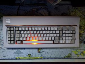

At a BIN price of $800, this isn't a "Great Find" in the bargain sense—but the seller did such a spectacular job restoring it, I had to share it with everyone:
IBM Model F-122 Key F122 Mechanical Buckling Spring Keyboard
Rather than describe everything he did—and it's a lot!—I'll let you read the page yourself.
I will point out that he's added lock lights (which F's don't usually have), and in a particularly imaginative way: Caps Lock is indicated by LEDs around the alphanumerical area, and Num Lock by LEDs around the number pad. (If I owned this board, I think I'd want a way to leave the lights on independent of lock status, but I guess that'd defeat the purpose, wouldn't it?)
Oh, and he mentions:
This keyboard has the Fohat Bolt-Modification, which further tightens the barrel and base plates together.  The result is a dramatic improvement in crispness and sound.
Fo, you're famous!  :?)
I think this shows quite a bit of excellent, dedicated work. Is it anyone here? If so, you have my compliments and admiration. Whoever ends up with this beautiful battleship will be poorer, but should be a happy typer from now till eternity!

I think the backlighting looks a bit weird only on the outside of the alphanumeric area, but otherwise it looks very nice :D .
Well, it's certainly not conventional, and wouldn't be to everyone's taste. (A couple of LEDs under each of the actual keys would be plenty for me.) But I'm sure he was just looking for more creative ways to enhance the board.
If he gets enough to make it worth his while, maybe he wouldn't mind modding his mod—for example, making the lighting more general, and dimmable... I agree, that'd probably appeal to more people.

The lighting looks very weird to me. I would love to have CapsLock and NumLock lights, and I would drill small holes and just let LEDs poke through.
I would have done it long ago if I could figure out how to make NumLock *ON* be the time that the light is *OFF* and the CapsLock light work the normal way.

I'm the guilty party here.

2)  Regarding the lock light indicators, I personally thought outlining the section looked better, but I was on the fence for a while with it.  Here's an F XT in which I used a single LED to indicate the Caps Lock ...
185414-0
Which looks better?  It's probably a judgement call.  Y'all can be my focus group!  :D

2)  Regarding the lock light indicators, I personally thought outlining the section looked better, but I was on the fence for a while with it.  Here's an F XT in which I used a single LED to indicate the Caps Lock ... Which looks better?  It's probably a judgement call.  Y'all can be my focus group!  :D
It's very subjective, of course, like anything involving KB esthetics. All we can say is what we personally like, but that's not any kind of bottom line.
Personally, while I find it very creative to light entire sections as lock indicators, such big lighting changes the keeb's appearance quite a bit—and if pressed to guess, I'd say most people would find that a bit radical. I also think backlighting is something people like to be able to control as a general look, rather than having it linked to something like lock status. But ultimately it's up to you, and whoever might buy the board.

And he's right about that bolt-mod.  I had refurbished my own F122 before this one and used it for about a month without the bolt-mod before working up the courage to do it.  So I got a Before and After with the same board, and it's sooooooooooo worthwhile!
Regarding the lock lights, I wanted to also mention that Xwhatsit does let the user turn them off completely.  There are also two dropdowns labeled "255" and you'd think these could possibly decrease the LED brightness, but nope.   They're stuck at "255."  Maybe the creator intended for this to control the voltage but didn't get around to implementing it?
In future builds, I think I will either mount a potentiometer in the rear or just use singular LEDs.  I sometimes get carried away with shiny things and lights.

Enough people have said that they didn't like the way the LEDs were implemented that I've pulled the listing and will redo them tomorrow.  There will still be LEDs, but outlining entire sections of the keyboard might've been excessive.
I'll put it back up afterwards.  Stronger.  Better.  Faster. :)

I'm back.
You guys were right.  Thanks!
Re: Fantastic Model F-122 restore
« Reply #12 on: Wed, 03 January 2018, 16:18:38 »
I'm back.
That looks great!
I didn't mind the first iteration, tbh, but the bleed through to the 24 function keys and left side function keys was a bit distracting.
  • Posts: 6566
« Reply #13 on: Wed, 03 January 2018, 17:16:42 »
Huge improvement!
Since I use the numpad and never turn it off, I would really want to achieve a way to let the light indicate "NumLock OFF"
Has anybody ever worked this out, particularly with a Teensy?
Since it is just an on/off signal to the LEDs, wouldn't an inverter do the job?
Or by changing that line in the Capsense code.  Oh wait ...

Some keyboards have the Caps Lock light as a round LED inside the Caps Lock key itself (so the keycap has a small transparent window).  That's the most classy way to do it IMHO.
I can understand that.  But it's not really possible with buckling spring switches unfortunately.
Personally, I think the BEST way to indicate if the Caps Lock is active would be to incorporate Pavlok's electric shock technology into the key.   ;)
I don't know what that is. I am not sophisticated in electronic engineering.
The Teensy has a pin that will turn a NumLock LED on, but I want the current to flow when NumLock is "OFF"
