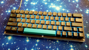

here's the DZ60 I just built.  I didn't split the left shift, but I have the delete key on the right, under the enter key (red 1u key).  Also with QMK, I have the right shift set as a dual role shift key.  If I tap it, I get the slash/question mark key, but if I hold it down, it becomes right shift.
What a wonderful keyboard!
