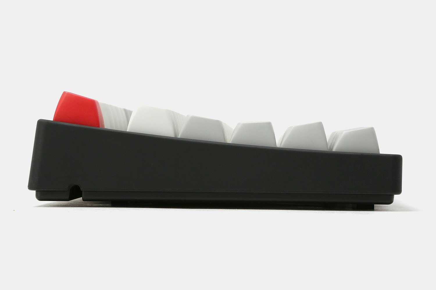

IMO there does need to be a small difference in height, otherwise it becomes too similar to a uniform profile. Although this is very much a matter of personal preference.
One thing I would change is to make the height difference more consistent between rows. Currently there's a huge step down from R4 to R5, while there's pretty much no step between R0 and R1.
The diagram shows what I mean. Cherry profile does have a reasonably consistent step size between rows.
That is an astute observation. The step on this profile is in fact consistent (with exception to the first row). All steps are simply justified to the base angle of the board, as opposed to each row being justified according to the difference in angle from the previous row. Thanks for the feedback.
Ah, I hadn't realised it was intentional. MT3 profile has a somewhat similar sculpt, although yours looks better IMO.
I think many sculpted profiles are modelled after the keycaps on the Model F/M which have a curved plate and therefore inherently have a consistent step size.
I have no idea if your sculpt is better/worse in terms of ergonomics or typing feel, it just looks a bit off (to me anyway).
Mod row still is intentionally out of step, and function row is a half step, but everything else is dead nuts.

Looks like this will compete with DSS for the most part. I think the (marketplace) success of this will depend on how robust designer support is, how high quality the results are, and how reliable the manufacturing and order fulfillment is. One of the biggest reasons Signature Plastics gets so much of the custom (spherical) keycap business is that they know how to work with designers and their color options are unmatched. The other reason is their vendor relationship with MassDrop, which gets their product onto a lot of keyboards.
From looking at the renders, it seems like there is a row profile that is very nearly flat, which I think is a good idea. This gives designers the option of offering a flat set of bottom-row modifiers.
This is valuable feedback.
Coming from this designers perspective, it has been excellent working with mike. I have no doubt that his consideration and diligence will serve set designers as well.
Yes, the qwerty row is level. This was intentional to allow the row profile to be used for other applications such as a uniform profile and that would include the bottom row. This is all of course theoretical. I'm just speaking from the design standpoint, and cannot speak to if/when such options would be available.
I love DSS, but it wont be competing unfortunately because it hasn't been produced in 25 years, for what reason I am not sure.
And... here is a new look at the latest revisions being made. Newest is in red. The old as seen in the tkl layout is grey.

That DSS sculpt looks awful based on the pictures. This project will blow it out of the water, especially with the option for a flat bottom row. I absolutely love that on my MT3 /dev/tty0 set.
I think the DSS sculpt looks pretty good. It is quite an aggressive sculpt, so I can see why others mightn't like it.
DSS probably can have a flat bottom row too if the designer chooses. The pictures are 12344, but if 1.25u keys exist in any other profile they can be used instead. I guess we won't know for sure until the first new DSS sets are released :)). I only use my thumb to hit the spacebar, so 12344 with a flipped spacebar looks perfect for me.
Regardless, this looks like it has a much more gentle sculpt, so it will probably suit some people better than DSS.
