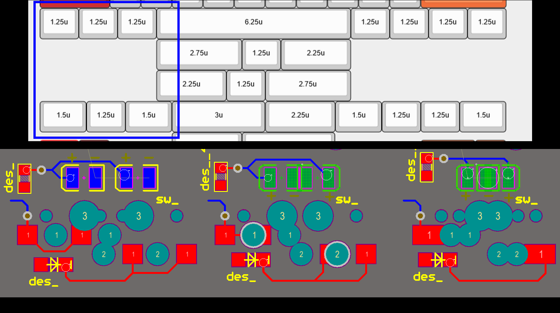

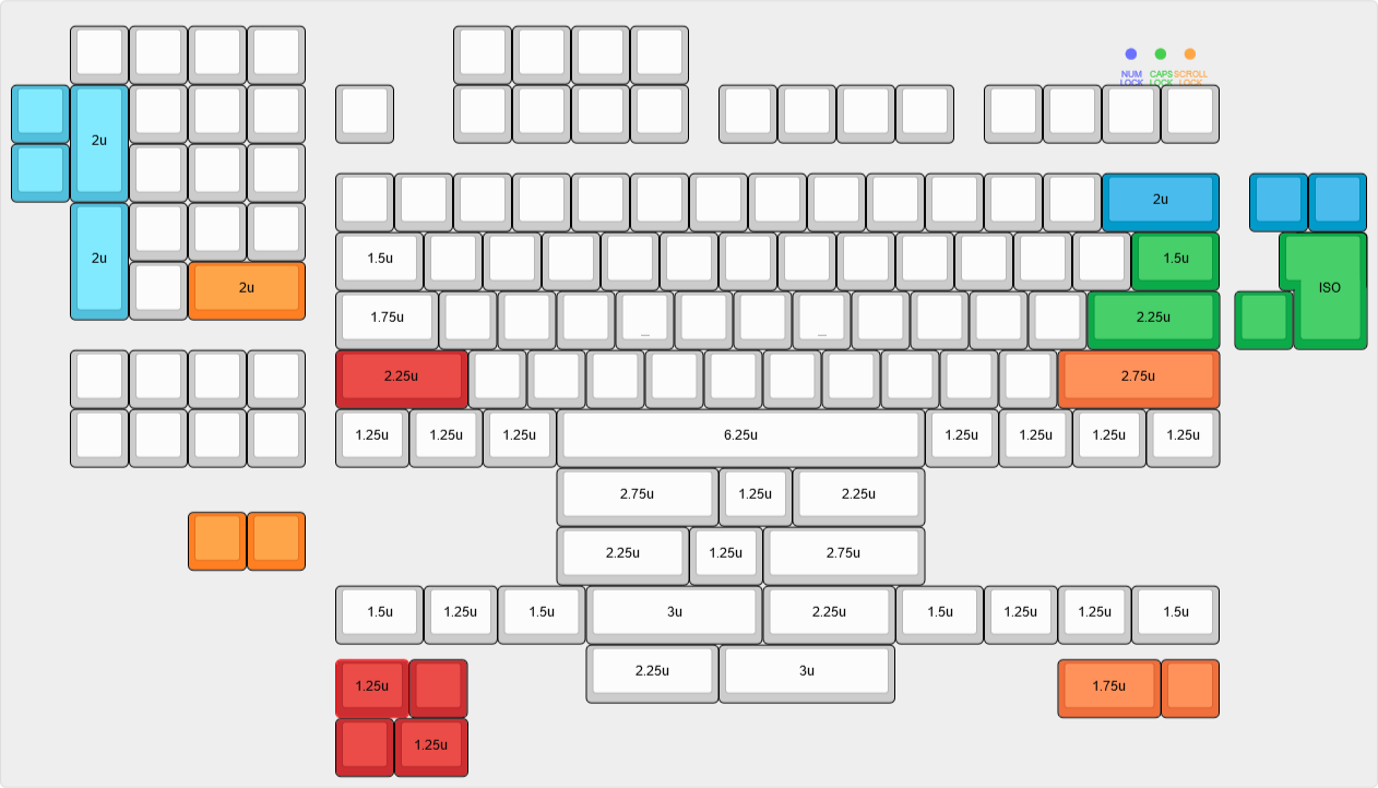

As for the layout, I thought of making this:
192308-1
I don't know if it's possible to mix "hot swap" and "universal layout" but I will try.  :-\
because we're using hot-swap switches, I think smd leds are a must, I guess I just put the pads for leds in the opposite layer.
a bit on the progress:

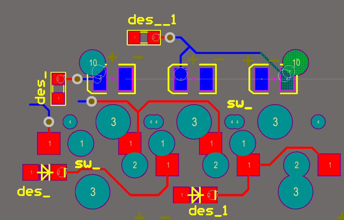

- split backspace:
do you think this will work?
192310-2
there are collisions but I think it's ok.
- 1.25u and 1.5u modifiers
192312-3
hopefully the collision in the middle key is not a problem
I'm trying to make bottom row with split-spacebar and 3u spacebar in it, it's: 1.5, 1.25, 1.5, 3, 2.25, 1.5, 1.25, 1.25, 1.5
I have to admite that adding hot-swap and leds do increase the difficulty quite a bit.  :(
