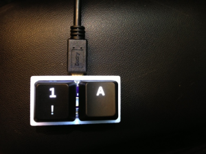

« Reply #153 on: Mon, 03 February 2014, 15:16:33 »
The good:
1) The LEDs work... but I'm adding a jumper, because they're always on (unless of course, you don't install them)
53075-0
2) Created a little jig board to aid in programming this thing (which went fine) but now I have to wait for those to show up.
The bad:
1) I need different zener diodes.  The ones I got are 500mW, and they don't seem to be activating with the low current going on here.  I've ordered some replacements, but also had to adjust the footprint down to match (SOD-323).

The good:
The bad:
Maybe make one of the keys a dedicated on/off switch for the LEDs?
