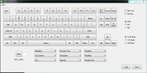

So I hacked together a GUI to make remapping the Phantom a little easier.  It can handle all the layout possibilities that are available as plates and some that aren't.
3866-0
Let's start with the options on the right, they should be self explanatory.  The top 2 check boxes turn on and off 7bit's F-row (15 1x keys solid), and 7bit's nav block (extra keys over the arrows).  The next grouping is basic layout allowing ANSI or ISO or 7bit.  The next grouping allows you to specify the modifier row for 1.25x, 1.5x, or 7bit's modifiers.  Note that choosing 7bit's layout makes all the extra options disappear since they are extraneous.
On the bottom right you can load or save phantom layout .c file as provided by bpiphany's firmware found at github.
Underneath your keyboard layout is a single button showing the legend of the current button with the exact key_code underneath.  To the right of that is an entry box where you can press any of these keys: [a-z] [0-9], all un-shifted punctuation, spacebar and tab to set the current button.  Pushing any of the buttons in the layout will focus the input box so you can easily map all the letters/numbers with a mouse and KB.
To the right of that block are 9 drop-down boxes containing different groupings of key codes.  If you need to UNSET a key, select NA in the Special list.  Note that I allowed ALL the key codes and do NOT have any idea if they all work.  For instance there is a left and right Ctrl keycode, but there is also a non-specific Ctrl keycode.
Please note that the layout settings do not change as you load your layout file.  You must select the appropriate layout to see it correctly.  Once you have saved your layout loading it again will set the GUI to the layout you saved as.
Now at v.11 of Phantom Remap
Implemented:
v.11 Tracking bpiphany's change to layout files:
        Now outputs .c and .h using your filename, does NOT require writing over an existing layout.
v.10 (no version bump) added Colemak and Dvorak ANSI 125x layouts to the zip and separately
v.10 Resize bug fixed, code cleanup
v.9  Saving/loading of layout settings to the phantom.c file
v.8: Window Resizing (2 tiny buttons at top left corner, or Ctrl-MouseWheel)
       This change removed Ctrl from the list of keys that can be directly input for code assignments
       The program will now save an ini file containing x/y window coords and button size, the button size directly effects window sizing.  You can directly edit the ini when the program is not running.
v.7: Additional keys for direct input (every key on my Filco TKL)
v.6: Sorting of the key code lists (remarkably easy since I wasn't using the key:values for anything)
I've included ANSI, ISO, ANSI Colemak, ANSI Dvorak (all in 1.25x) layouts and a 7bit layout in the zip file.
Features I'd like to implement:
Suggest something?  Please understand that I won't implement a feature in the GUI that is not present in the master git repo linked above.

So I hit v.6 since after doing some code review I found that I wasn't using the key:value pairs like I planned to.  The key code drop down lists are now sorted somewhat more intelligently.  Anyone want to take a stab at the Punctuation list?  :)

Okey, v.7 up - Every key on my TKL can be used for direct-input to set a key code, so click a button press a key, assignment done.

v.8 - Window Resize controls are now in the top left corner, also Ctrl-MouseWheel will change window sizing.  This has the side effect of removing the Ctrl key from the list of keys that can be directly input to assign key codes.
Some input on if you'd prefer keeping the direct input of Ctrl and losing Ctrl-MouseWheel resizing would be appreciated.
Also implemented an INI file to save window size and position.  The button size is how window size is saved since everything is derived from button size.

v.9 - Saving and Loading of layout settings to the phantom.c file.
These are saved as a standard C 1-line comment directly preceding the layout[] array.  I also updated the included layouts so that they include this comment so you can see it in action easily.

The zoom makes the layout wacko, it overlays both ISO and ANSI as well as make the space bar 1u and moves some switches around. I don't see the use in zooming so it isn't a big problem, but it is broken in v9. Just fyi
I could post a pic if it helps or you don't have these issues.
Edit: ÅÄÖ behaves weird as well, but that I had expected.

That was an irritating bug.  On the other hand it induced some serious code cleanup.
BTW - any idea how I might debug those non-US characters for you?

Edit: I can't seem to save the layout in the gui. I assume it was going to save a "phantom.c" file (or whatever you decide to name your layout)
Are you saving it *on top* of a phantom.c file as it says in the instructions above?  :)
Filco w/ Imsto thick PBT
Offline damorgue
  • Posts: 1176
    • Personal portfolio
Re: Phantom firmware remap GUI - Phantom Remap
« Reply #29 on: Sat, 08 September 2012, 05:04:27 »
Whoops, my bad
Offline harrison
  • Posts: 161
  • Location: Surrey, BC

So I did change how layouts are defined :) I think the changes are all pretty well motivated, and regarding the layouts I mostly did away with the is_modifier array, which I don't think you will mind too much.. There will probably always be a layout array in pretty much the same shape as the current one. Adjusting the GUI software to keep up shouldn't be too hard. I am bound to keep learning more c and be unsatisfied with the current mess of files :) Since I reworked the firmware a fair bit I created a new repository, not specifically refering to the Teensy. https://github.com/BathroomEpiphanies/AVR-Keyboard

If I need some road signs stuck in your new file I'm sure you won't mind  ;)

You can just use the GUI and make it yourself.  I would recommend waiting for me to release the new version supporting the new revision of the firmware where the layout is in a separate file.  BTW - it's done but I won't be posting it til I get home this weekend.

Okey doke, managed to lose the previous v11 changes I did, and have only just had the time to redo them.  Needless to say, 2nd time is even better.
v11 is now in-line with bpiphany's changes to layout .c files.  It will output both the .c and .h for a particular layout, it's up to you to integrate that for compilation if you choose a different name than bp's stuff.  This also does not require that the output file already exist.  If it does exist, it will be over written.
I've also included all the previous layouts redone with the new format.  So, ANSI and ISO in 1.25x and 1.5x mods, 7bit, and ANSI 1.25x Colemak and Dvorak.
