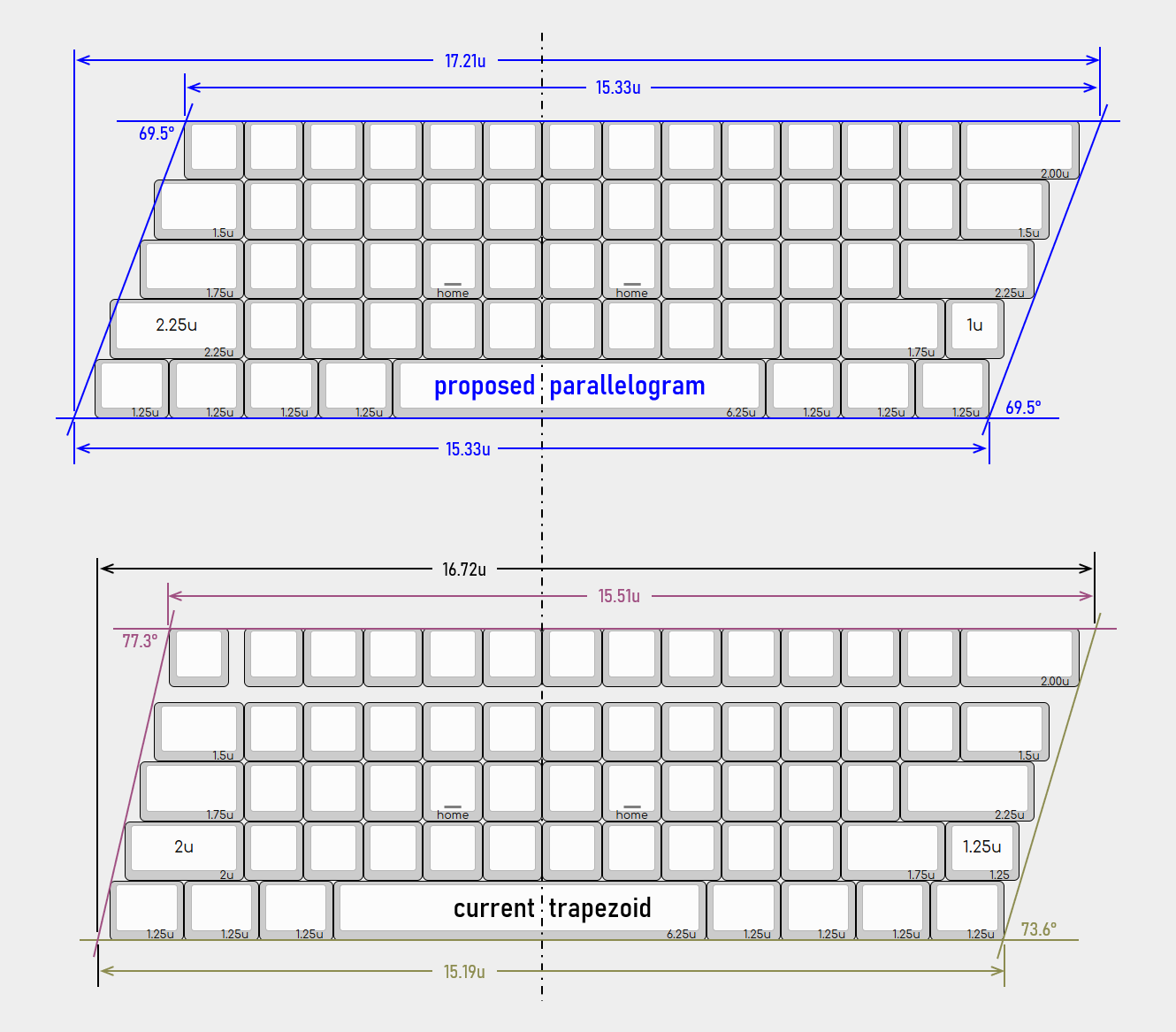

I’ve been trying to figure some things out regarding the feedback I’ve received on the keyboard’s layouts, and I have come up with another updated design.
A few people have mentioned to me that the new layout I proposed will not work--the 1.75u backspace key in my renders does not actually exist!
I overlooked that the 1.75u backspace key in the 40% kits is for row 2 instead of row 1.
To solve this problem, I have decided to add custom machined novelty keycaps for the escape and backspace keys (1.25u and 1.75u, keycap design not finalized yet).
This will, however, come at a premium (~CAD$100). The original layout with the staggered number row will still be an option.
Group buy date is still to be determined, but I’m aiming for an end date before the end of the year.

The Design
The FluxLab ZT60 is a 60% ortholinear keyboard with support for most high-end keysets.
As long as the keyset has 1u/1.75u and 2u shift keys, it will be fully compatible with the ZT60.
It will support various bottom-row layout features, such as a 6.25u spacebar, a 7u spacebar, split spacebars, and an arrow cluster.
The image below illustrates all the layout options available.

« Reply #1 on: Sat, 24 April 2021, 14:47:46 »
I love this layout but I'm curious about a few things:
- what went wrong with the previous surface finishing?
- what are you doing to avoid a repeat of that issue? Changing factories, improved QA...?
- why 6.9 instead of 7 degrees?
This board has everything I like about ortho with everything I like about staggered, so I will be watching curiously!
Sent from my SM-G950U1 using Tapatalk

Offline Mandy
Re: [IC] FluxLab ZT60 (A premium 60% ortho)
« Reply #4 on: Sat, 24 April 2021, 16:47:48 »
This is close for me. Odd decision to stagger the number row, and I wish it had support for an MIT style bottom row.
the number row stagger is an imperfect solution, but its the only way to achieve a uniform 0.25u stagger along each row. the main benefits of ortho still remain with all the alpha keys aligned, as the num row is used much less than the alphas, so i decided to go with this design.
edit: also, not sure what an mit style bottom row looks like
I agree with the top row being a mistake and should be linear instead of offset. As for the "MIT" style, @Mandy is probably referring to the Planck MIT layout with a 2u spacebar or at least one that is also linear.
Side note: I'm not really sure what MIT stands for in the case of the Planck, so if anyone knows, please share.
Yeah I would be curious to see the uniform 0.25u stagger version side-by-side with a full ortho on alphas version
I've received quite a bit of feedback regarding aligning the top row, so I thought about it more and may have come up with something elegant! Will update you guys soon!

This is amazing, I love it.
I think the staggered top row is fine, I'd prefer this than having a non-uniform edge.
EU vendor? Shipping and imports are gonna sting.
Do you have more renders of the back and underside?

The staggered top row don't bother me, keeping a uniform 0.25u stagger along each row is much more elegant than to go full ortho.
EU vendor would be awesome !

Just made an update to this! I will be deciding on whether to have an EU vendor later, depending on interest. New renders have been added, as well as an option for those who want the number row aligned!

That skinny little blocker at the top left of the aligned num row layout............. .. .. feels bad

Overall I really like your design and hope you are still planning to run a group buy down the road.
While I agree that the staggered number row was bad, the gap between R1 and R2 is no better. I propose a parallelogram that eliminates both these issues as well as the gap between ESC and 1. Using the standard 2.25u shift is another benefit, as base kits don't always include 2u shift.
