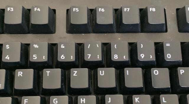

Hi all - it doesn't look like nodnerb is active anymore, but I have a Datadesk Switchboard, and I'm wondering if I'm running into the same problem that he had.
I believe my wiring is correct (power and caps lock are on), and when I look at the System Report on my MacBook Air, it shows "ADB keyboard converter", so I think I flashed it correctly.
But when I run hid_listen.mac, I get nothing, just
Waiting for device:
Listening:
I *don't* have an oscilloscope, nor do I have another ADB keyboard around to test. But worse still, I can't quite understand what changes I could make to the code address what nodnerb discovered. Could you possibly provide a diff/patch or a branch that implements a fix for what he found?
Thank you so much! And just in case I did screw up the wiring, here's some photos.

I'm awaiting a NeXT ADB keyboard (QWERTZ). As I understand, there isn't a mapping for it - yet.
To be prepared for this, I've decided to test the HID Listen program with my Teensy and my AEK II. And e.g. later find out which handler id the NeXT keyboard has got, etc.
But, alas! on my Mac with OSX 11 (Big Sur), I've get the message "Bad CPU type in executable".
Any hints on how to build HID Listen for OSX 11?

Hello,
I need help to modify the source code for my QWERTZ NeXT keyboard (ADB).
Problem: How can I remap e.g. <ALT>-8, which gives { to send [ to the computer? Of course I could re-map it in the OSX settings, but it would be much more elegant to solve it in tmk_keyboard.
I've looked into the source code, e.g. action map.h etc., but I couldn't identify the right spot. And I couldn't find the right type of macro. I've also liked into ACTION_MODS_KEY, but this is also not the right way.
Thanks in advance!

Hello,
this is the normal layout of a QWERTZ keyboard on OSX.
<ALT-5> maps to "[", <ALT-6> to "]", <ALT-7> to "|", etc.
The standard adb-usb mapping works this way. And normally you want exactly this behaviour, e.g. with an QWERTZ AEK II keyboard.
So, to get "[" either on an AEK II (QWERTZ) with ADB-USB converter or on an QWERTZ USB keyboard, you press <ALT-5>.
But unfortunately, on the QWERTZ ADB NeXT keyboard, the printing on the keys mirrors in this area a PC keyboard:
Here <ALT-7> should map to "{" instead of "|", etc.
In OSX I've got the standard keyboard settings and behaviour.
Perhaps helpful: The key "7" gives in the matrix-scan function of matrix.c the value 0x1A when pressed, and 0x9A when released, "8" 0x1C and 0x9C, "9" 0x19 and 0x99. So the scan codes(?) on the NeXT ADB keyboard are basically sound.
« Last Edit: Sat, 26 December 2020, 09:34:18 by Fritz the German »

« Reply #982 on: Sat, 26 December 2020, 10:35:06 »
The converter works as expected and this is not a bug. The scan codes are identilcal to Apple ADB keyboard, NeXT supplied that layout on computer(not keyobard).
Are you just curious or really eager to use the NeXT layout? You don't care legends on key when you can touch type :D
You will have to send 'Alt + 5' to get '[' on MacOS when depressing Alt and 8 key probably, for example.
(Alt should be AltGr(Right Alt) here, right? I don't know how QWERTZ keyboard actually works.)
First, you should set ACTION_LAYER_MODS(layer-3, KC_RALT) on the Alt key and map 8 key to 5 on layer-2.
I think you get '[' with AltGr + 8 key using this mapping. Check Right Alt on layer0 and 8 on layer3.
Use 'Code Edit' tab to see/edit 'ACTION_LAYER_MODS()'.
https://bit.ly/2WIVB8q
Works with your hints (lay 3 etc., but... the Mac interprets it as "ü".  :rolleyes: As intended by the software, no bug, either.
But now I have to work out how to use a macro to get "[" etc.
« Last Edit: Sat, 26 December 2020, 20:49:09 by Fritz the German »

The layout of the QWERTZ ADB NeXT keyboard is really unique, is it?
258639-0
<CRTL> and <CAPSLOCK> (the locking type, but without indicator LED) are reversed.
Notice the two [ i ]-keys right and left from the spacebar, and the command key right under the spacebar. And the position of the "|,\,˜" on the right of the bottom row - interesting.

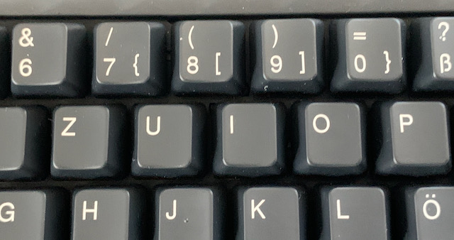

NeXT QWERTZ ADB keyboard on a Mac
Hello,
first, I like to thank hasu for his valuable advice. It has been of great help for me!
Now the good news: I was able create a modified version of the firmware - see below * matrix NeXT.c and * unimap_plain NeXT.c - that maps the NeXT ADB QWERTZ keyboard according to its layout and the imprints on the keys.
The bad news: This modified version is suitable only for OSX (german keyboard setting), not for Windows or Linux. The macros e.g. to get "[" are OSX specific. Some experiments with a windows PC have shown that most keys are mapped correctly with the standard firmware. But not all. So in my opinion, to use this NeXT keyboard with a Windows or Linux PC another version of the firmware tailored for this is needed.
Here the layout of the keyboard:
258926-2
Some remarks about my modifications:
  • I was in need of a firmware that maps the keys according to their imprints and works with my Mac and OSX, since I'm no touch typist.
  • Since I'm using also an AEK II on my Mac, I've mapped some of the function keys (which aren't present on the NeXT keyboard) to brightness and media. So the function keys of the AEK II act more like the ones on a modern Apple keyboard.
  • For the same reason, the firmware distinguishes between ISO, NeXT QWERTZ and normal keyboards.
  • Although I'm no touch typist, my hands have some muscle memory. So I didn't corrected the behaviour of <Shift>-<#>. It still gives "'" (apostrophe) as on Apple and PC QWERTZ keyboards. Since I'm writing in german and in english (QED), this suits me better. If someone else wants the "correct" result for <Shift>-<#> -"^" (grave) -, it's easy to create a macro for that. For now, <R-Alt>-<Shift>-<\> creates "^" (grave).
  • Since the NeXT keyboard distinguishes between <Right-Alt> and <Left-Alt>, I've decided to use <R-Alt> in the manner of an <Alt Gr>-key.
  • Although you can get used suprisingly fast to the big <Command> key located under the spacebar, I've decided to map both <[ i ]> keys right and left from the spacebar also as <Cmd>.
EDIT: For an unknown reason, the original file attachments have been empty. Second try.
