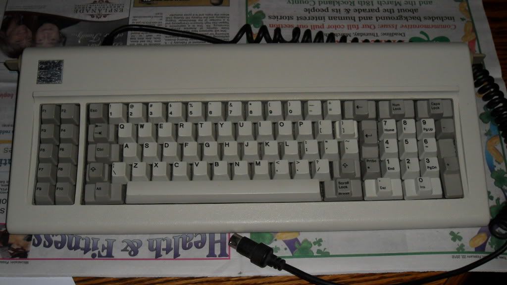

Obviously the chances aren't terribly high, although I do have the original PC intact. Regardless, I just love the look of that pigtail cord. I'm not too worried about making things terribly pretty considering that this is a chunky 80s keyboard we're talking about here.
Here she is, all cleaned up:

« Reply #10 on: Fri, 24 February 2012, 00:35:44 »
im sure im in the minority but IBM model F's, XT, and especially AT are beautiful works of art to me, followed by the model m. :D.
