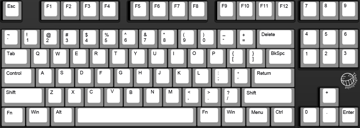

my bad litster sorry about my herp a derp ness that is not an excuse but i am the guy that constantly types yo u lately

No resistors are needed for the LEDs.  Think about it, there is no place to solder resistors on to the PCB, unless you want to solder a resistor inline with each LED.
As I wrote in the first post, that mouser SMD diode part is the part I used in my KMACs.
If I have to guess, the keyboards you use are all broken in some way, especially the comma and period keys.  You shift keys don't work most of the time as well.
You are correct and are the first to say something on this forum about that. Also besides that my typing style is atrocious.
Ha, your keyboard is fixed!
I wish it were that easy
