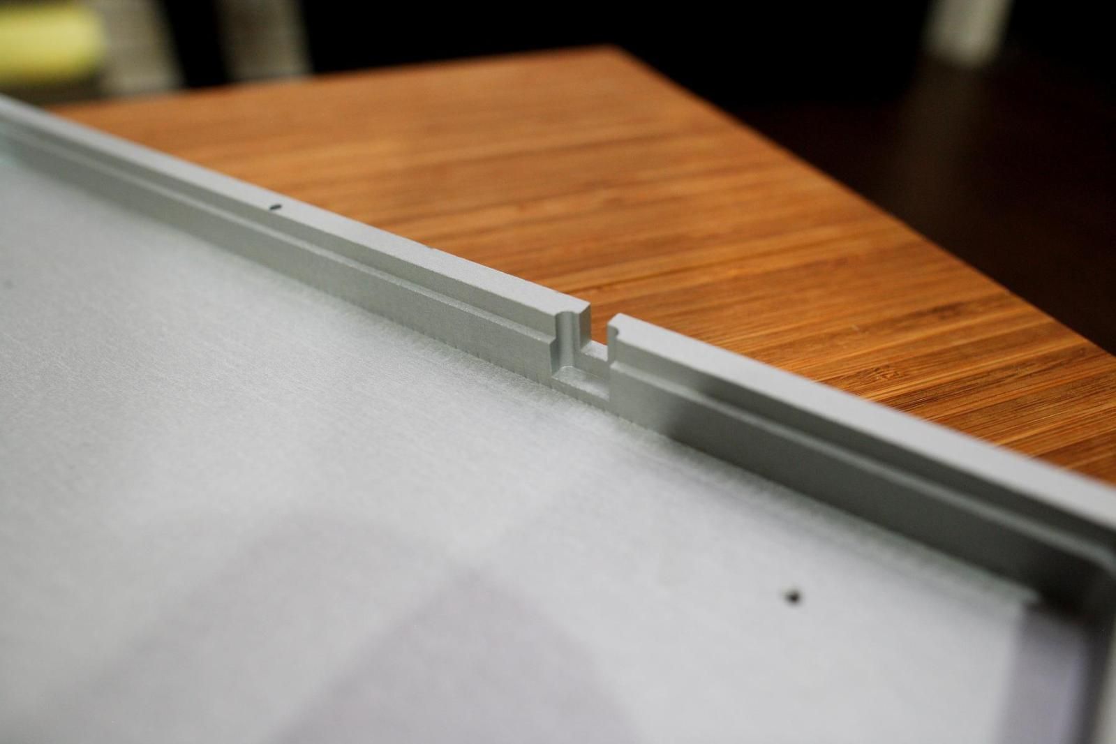

The plate's edge sits on a groove on the case, as it is so in the Filco/CM Storm case. It is just Filco and CM Storm have extra protruding screw thingers it also rests on. They primarily sit on the ledge on the edge. The height of the plate on the edge is same height as edge of the bottom aluminum case (see here). The the top case just screw down into it, sandwiching it all together.
Ok now I see what you mean from this pic below. Basically there is a very small edge that the plate rests on. Since Filco, CM quickfire, and Ducky has plates that have bent down edges at the front and the back, that means phantom plates will only be supported and held up by the two short sides since a phantom plate is completely flat with no bent top and bottom edges. This is very little support since the top and bottom are long and they're just suspended, and also the fact that there are no standoffs in the middle to hold anything up. I'm thinking phantom PCB/plate combo might bend slightly if you press down hard in the middle.

Unfortunately the case only have ledges that support the plate on the front and back. Not on the side. I am afraid that your plate won't fit.
How does your plate work in a regular Filco case? Doesn't that require the bent edges to sit on the bottom case too?

For everyone else, here to a picture to better explain what I said. A filco plate has downward bends on the front and back of the plate, the phantom plate is flat throughout the whole plate. In the picture, bottom black plate is from a Filco, and top plate is from my custom TKL plate, which is similar to a phantom plate.
This pretty much confirmed it: won't be compatible with phantom PCB/plate combo. jdcarpe, if you bought this for phantom only, then return it lol. My initial guess was that it might still work with phantom because the two shorter sides can hold it up, however just bends too easily. But laffindude said the case only holds up the plate by the front and back that requires the bend, which will make it flat out not work with phantom.
However, good news is that this aluminum case will work with all Filco TKL, CM quickfire, and ducky TKL since they all use the same plates with the bend. Dimensions are all the same.
The custom plate is supported at the two short side edges and 4 standoffs, along with 1 large standoff near the top center for the PCB. Enough to be pretty sturdy, so it doesn't require the top and bottom bends.

Gotcha. That's what I kinda figured when I looked at the interior of a case. The plate is thick enough to be pretty sturdy without being supported all around (given that you don't use the board as a trampoline ;)).
Oni also fits, since that's the board I happen to have handy and stuffed in there for the picture.
On the subject of Oni, in addition to having a plate support on the front and back, there are also little ledges to support the PCB. Not sure how needed that is, but it is there.
