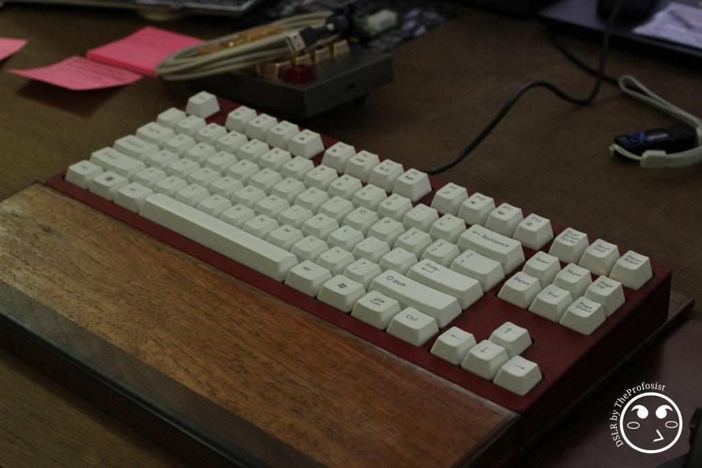

Offline TheProfosist
  • Posts: 3671
  • Location: Wisconsin, USA
  • Custom Layouts Only!
Re: Vortex Aluminum Filco Case
« Reply #324 on: Fri, 18 January 2013, 17:24:35 »
:P :P :P :P :P
:P :P :P :P :P
Looks good Profosist..
I'm thinking of getting mine done in Sunny Yellow..
just so you know there arnt that many anodizing colors you kinda restricted it not like powder coating....

« Reply #326 on: Fri, 18 January 2013, 17:59:14 »
:P :P :P :P :P
:P :P :P :P :P
 :'(  So Sunny Yellow unpossible?
  • Posts: 3671
« Reply #349 on: Wed, 23 January 2013, 03:13:53 »
Dont paint your case, powercoat maybe. I may be doing anodizing GBs in the future which would be the bes method for coloring aluminum.
