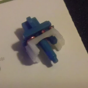

Here is a shot of the first two methods. Glued (based on the "ghetto brows" thread, and wire wrapped.
184150-0
Not only did it take a lot of time to wrap each switch and ensure it wasn't going to hang, of the 5 switches I did it to, almost all had a different feel. 4 hung on actuation and had to be tweaked. This was only the start of my problems. Below is an undershot of the wrapped, and why it had problems.  After fixing the snags, I had lots of issues with consistency of feel, what I realized is that while trying to fix the hangups by it sticking out too far, it was being pushed into the spring, and by varying amounts. In some instances, as the spring compressed, it was popping the wire out, giving a very strange and inconsistent feel. Needless to say, I wasn't happy, and promptly ordered some clear switches.

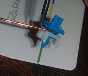

One night while waiting for my clears, I had an epiphany, and this is the result. I call these Jailhouse Blues, because they are locked down blues (locked, like a prison). This new method takes about 30 seconds per switch* to perform and not only is it nearly flawless compared to the other method (only 1 of every 2 dozen needed minor tweaking), it can be undone at any time. *This doesn't count disassembly or assembly time.
So how do they feel...
Combined with blue WASD o-rings, simply put... Fantastic!
It has a very positive click to it, moreso than browns, but quiet like browns. WhiteFireDragon also says "when it bottoms out, almost all of the noise and shock is taken out". His testing and mine sow the key travels about half as far before actuating (can vary depending on wire used), and it it doesn't "float" like blues do (again, depending on the wire used).  Too small of wire can result in some float as the wire doesn't fill the gap enough. Too large can give them a hair trigger.
Tools needed:
Angle cutters, wire,  blue switches, and a small flathead.
The wire is beading wire, you can get it in the craft section of Walmart, 4 of these coils (two silver, two copper) for $5. One coil will do a full keyboard. I believe it was 20guage wire.
184152-2
It will take about 15 seconds per side, 2 switches per minut.
Feed it into the stem alongside the shaft (it takes a bit of pressure), then cut where shown. Make sure it goes all the way through, but does not stick out the other side. The wire inside mostly holds things in place, but you need it to go all the way through so that it doesn't lopside the spring. The part going around the outside is what actually holds the white part in the extended position, and even this doesn't need to be very precise.

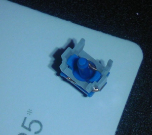

184154-3
Bend it around the outside, and use the screwdriver to press it into the gap. Make sure it doesn't overhang anywhere.

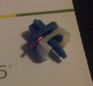

184156-4

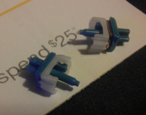

Flip the switch around and repeat. It should look like this when finished. Two "u" shapes, one per side. I don't think it matters if they run opposite, but I did mine that way.
184158-5
For the astute,
Yes, it does increase the spring pressure because of the wire running over the spring perch. Initially I would have sworn they were similar, but putting them next to my browns, there is a marked increase. This does two things though, it limits the likelihood of hangups, something I've heard Ergo Clears can sometimes do, and the spring helps hold the wire wraps in place with pressure. Odds are they will not move anyhow, but this just ads a little insurance.

I've previously made some jailhouses, which I've yet to use, however I suddenly thought, why not use o-rings for this mod?
So I tried it out, and it actually works pretty well. A few pictures can be seen here.
I used a 40A o-ring I had, which gave a good result. I did have to cut it, though, as it's way too big otherwise.
A quick comparison to the wire-modded jailhouses:
 - The O-ring-modded ones (will be) much more consistent compared to the wired ones. It might just be the way I did the wire, but the greatest difficulty for me, was to get the switches somewhat consistent (some had click, others hadn't, some felt gritty, etc.).
 - These are heavier
 - These have a slight O-ring feel at the bottom
Both former of the above can be attributed to the spring being completely blocked from the top, and not just partially, as with the wire mod (which could possibly be avoided by doing it some other way).
The bottoming out o-ring feel is quite limited, at ~.5mm at the bottom, and that part does require some force to push down, so it's not in a particular a soft landing.
To place the o-ring in the first place, one has to take the white, clicky, part of the stem off first, though. "Breaking" it off with a nail seemed to do the trick, and it's quite flexible plastic, so I'm not too concerned about breaking it. It's almost harder to get back on, than off.

Anyways, this pic will better illustrate what I mentioned about using thinner wires. I wrapped it around a few times so there's no slack left to move. The ends of the wires were not inserted into the blue shaft.
Around what size wire is this? I'm not very familiar with wire sizes.
  • Posts: 14404
Re: Jailhouse blues (non-floaty, short throw, quiet blues)
« Reply #49 on: Wed, 07 January 2015, 07:10:00 »
LeslieAnn says in the OP that she used 20 gauge wire.
Tools needed:
The wire is beading wire, you can get it in the craft section of Walmart, 4 of these coils (two silver, two copper) for $5. One coil will do a full keyboard. I believe it was 20 guage wire.
