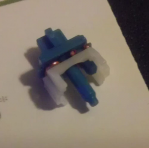

Here is a shot of the first two methods. Glued (based on the "ghetto brows" thread, and wire wrapped.
184150-0
Not only did it take a lot of time to wrap each switch and ensure it wasn't going to hang, of the 5 switches I did it to, almost all had a different feel. 4 hung on actuation and had to be tweaked. This was only the start of my problems. Below is an undershot of the wrapped, and why it had problems.  After fixing the snags, I had lots of issues with consistency of feel, what I realized is that while trying to fix the hangups by it sticking out too far, it was being pushed into the spring, and by varying amounts. In some instances, as the spring compressed, it was popping the wire out, giving a very strange and inconsistent feel. Needless to say, I wasn't happy, and promptly ordered some clear switches.

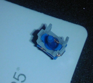

One night while waiting for my clears, I had an epiphany, and this is the result. I call these Jailhouse Blues, because they are locked down blues (locked, like a prison). This new method takes about 30 seconds per switch* to perform and not only is it nearly flawless compared to the other method (only 1 of every 2 dozen needed minor tweaking), it can be undone at any time. *This doesn't count disassembly or assembly time.
So how do they feel...
Combined with blue WASD o-rings, simply put... Fantastic!
It has a very positive click to it, moreso than browns, but quiet like browns. WhiteFireDragon also says "when it bottoms out, almost all of the noise and shock is taken out". His testing and mine sow the key travels about half as far before actuating (can vary depending on wire used), and it it doesn't "float" like blues do (again, depending on the wire used).  Too small of wire can result in some float as the wire doesn't fill the gap enough. Too large can give them a hair trigger.

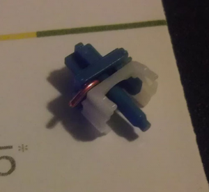

184152-2
It will take about 15 seconds per side, 2 switches per minut.
Feed it into the stem alongside the shaft (it takes a bit of pressure), then cut where shown. Make sure it goes all the way through, but does not stick out the other side. The wire inside mostly holds things in place, but you need it to go all the way through so that it doesn't lopside the spring. The part going around the outside is what actually holds the white part in the extended position, and even this doesn't need to be very precise.
184154-3

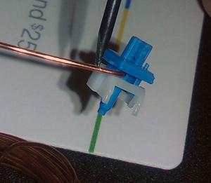

Bend it around the outside, and use the screwdriver to press it into the gap. Make sure it doesn't overhang anywhere.
184156-4

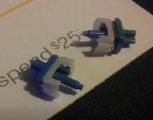

Flip the switch around and repeat. It should look like this when finished. Two "u" shapes, one per side. I don't think it matters if they run opposite, but I did mine that way.
184158-5

I don't have any extra blue/red springs right now, so if I cut one, that switch won't feel the same as the rest. You can try and see if there are any problems.
"Ground" means those end coils don't have the slight angle that gives the springs their pitch between each coil. Ground or closed ends are flat coils so that the spring can stand up nearly perpendicular. All these mx springs should have ground ends. At least that's how I've always understood what grounded spring ends mean. If you snip out these 2-3 end coils, then the spring can't stand up on the table straight anymore. How much this will affect the switch is what I'm unsure of.
I've only done 1 switch. No time to do the whole keyboard right now. This wrapping method I did took like 2-3 minutes to get it right, but it's still pretty consistent.

I tried cutting one, but the springs are so small, you can't get anything in there to cut without distorting it to the extent that it's going to sit crooked no matter what. Some really small and very sharp wire cutters might do it, but mine certainly can't. At least not up on the flats, but it can do down in the normal coils, so I may try that. If i put the cut coil at the top of the stem, the shaft should hold it straight.
A close inspection on your method tells me it will have the same issue as my early attempt did (look at an unwrapped one from the side). the problem is that the spring is actually wider than the legs , so the wire will hit the spring no matter what we do. You will end up with a softer spring, but an inconsistent feel. My first felt fine, in fact all did, until I compared them to each other.
I did find another method to shim these, but it requires destroying a second blue stem to make each one (shave it down to just the top area where the spring passes through), which is not an economical way of doing it.
Still on the hunt, but I plan on try the spring cut method later tonight. I have heard of at least one other cutting them with no ill effects (and getting down to 20cnm(?) of force). Like you said it's permanent, but if it works, I don't mind.

I spent weeks trying to figure out a cheap, simple solution ranging from dental bands to o-rings to glue. I thought about o-rings, but they would need to be VERY thin. The wire I used is .8 mm or something like that. Dental rubber bands might work.
Keep in mind you have very little space on the long faces between the spring and walls of the housing, anything that fills the gap in one wrap, will interfere with the spring or the housing. The dual wire wrap I use serves as a new spring perch, which is why you need to trim the springs, but, you end up with a consistent feel. If you have an o-ring rubbing the spring, you end up with varying amounts of rub/friction, not just from one switch to the next, but also at varying points of being pressed.
No matter what you use, be vary cautions about this.
I took a spare switch top and cut off the lock tabs so I could experiment and test every stem before inserting it into the actual keyboard and I'm glad I did. I had to tweak a few.

Solder works, but is hazardous (and this is a lot hands on). The wire I used was a fraction of the cost of solder.
O-rings will not work. Look at the white part and you can see it thins out where it passes the spring. If it rubs anything, it will be chaos.
Even if the wire I used were to rust (it needs moisture), it can do no real harm to the rest of the switch. I believe mine was chrome or brass plated wire, it was meant for jewelry making. Neither will rust easily.

I've previously made some jailhouses, which I've yet to use, however I suddenly thought, why not use o-rings for this mod?
So I tried it out, and it actually works pretty well. A few pictures can be seen here.
I used a 40A o-ring I had, which gave a good result. I did have to cut it, though, as it's way too big otherwise.
A quick comparison to the wire-modded jailhouses:
 - The O-ring-modded ones (will be) much more consistent compared to the wired ones. It might just be the way I did the wire, but the greatest difficulty for me, was to get the switches somewhat consistent (some had click, others hadn't, some felt gritty, etc.).
 - These are heavier
 - These have a slight O-ring feel at the bottom
Both former of the above can be attributed to the spring being completely blocked from the top, and not just partially, as with the wire mod (which could possibly be avoided by doing it some other way).
The bottoming out o-ring feel is quite limited, at ~.5mm at the bottom, and that part does require some force to push down, so it's not in a particular a soft landing.
To place the o-ring in the first place, one has to take the white, clicky, part of the stem off first, though. "Breaking" it off with a nail seemed to do the trick, and it's quite flexible plastic, so I'm not too concerned about breaking it. It's almost harder to get back on, than off.

I tried to do a couple more (I now have four of these), and so far, they have been very consistent. I didn't get near this consistency with wires, granted there's not the same quantity of samples of these.
There's no friction to be found, as long as the oring is cut properly. I hadn't done so when I took the photos, which did have the stem sit in the upper housing, when taking it out, but cutting it properly, leaves with no additional friction against the housing, as it sits within the borders.
I do find that it takes longer to mod them this way, than with wires, as it does take some time to disassemble the stem, and put the oring on (which can be somewhat difficult).
For the ones I've made, I didn't stretch the oring when putting it on, and I used a paperclip to push it into place. I haven't tried stretching it, to see if there's any difference in the final result, but I fear that would have negative long-term effects, if it were to slowly retract back into original state, leaving part of the area without a blocker. I imagine it would also be a source for inconsistency.
Adding to this, I'm not sure how the orings hold up long-term.

They're not cut exactly halfway, but yes, you are correct. One o-ring can be used for two switches.
I'm using an ordinary wirecutter for it, which is a little tedious (it's hard to get it cut all the way, so you have to break the small piece off manually).
Cutting the o-ring short, can quickly result in a slight click (not nearly as much as blues, but you can hear that there once was some). I don't feel it's hard to control where you cut it, though, so I don't see it as an issue.
I mentioned that this operation took longer, than the wire method, but after timing it, I'll have to correct myself on that statement. I made one in about 1m30s, with tools and materials on the table, a time which could be reduced slightly still, whereas I was only able to get just over 2 minutes per switch with the wire method.

I used 0.8mm solder since it bend so easily and is very quick to apply (and I had it nearby). I noticed that there was a weird effect on bottoming out which I couldn't explain by looking at it until I measured it. The normal spring in blues stops the keytravel when o.8mm wire is used. The distance from the inside bottom of the switch housing to the surface underneath the white clicker when fully depressed is less than the length of a fully compressed spring. The spring stops the movement, makes it feel a bit mushy, removes some bottoming out noise and buckles a bit when more force is applied. I hated the scratchy and less distinct feel of bottoming out on a spring which deforms so I shortened the spring. I am going to check if there are any springs in the cherry MX switches which is less long when fully depressed.
I like that there is less keytravel before they actuate though, so I will be trying out a few more, as long as I don't have to manually clip springs for it.

Darn, after I'd spent time to make my own jailhouse blues, nobody wants them.
Not even me, because I actually am using jailhouse ghetto greens for myself. :'(

Anyways, this pic will better illustrate what I mentioned about using thinner wires. I wrapped it around a few times so there's no slack left to move. The ends of the wires were not inserted into the blue shaft.
Around what size wire is this? I'm not very familiar with wire sizes.
  • Posts: 14406
Re: Jailhouse blues (non-floaty, short throw, quiet blues)
« Reply #49 on: Wed, 07 January 2015, 07:10:00 »
LeslieAnn says in the OP that she used 20 gauge wire.
Tools needed:
Angle cutters, wire,  blue switches, and a small flathead.
The wire is beading wire, you can get it in the craft section of Walmart, 4 of these coils (two silver, two copper) for $5. One coil will do a full keyboard. I believe it was 20 guage wire.
